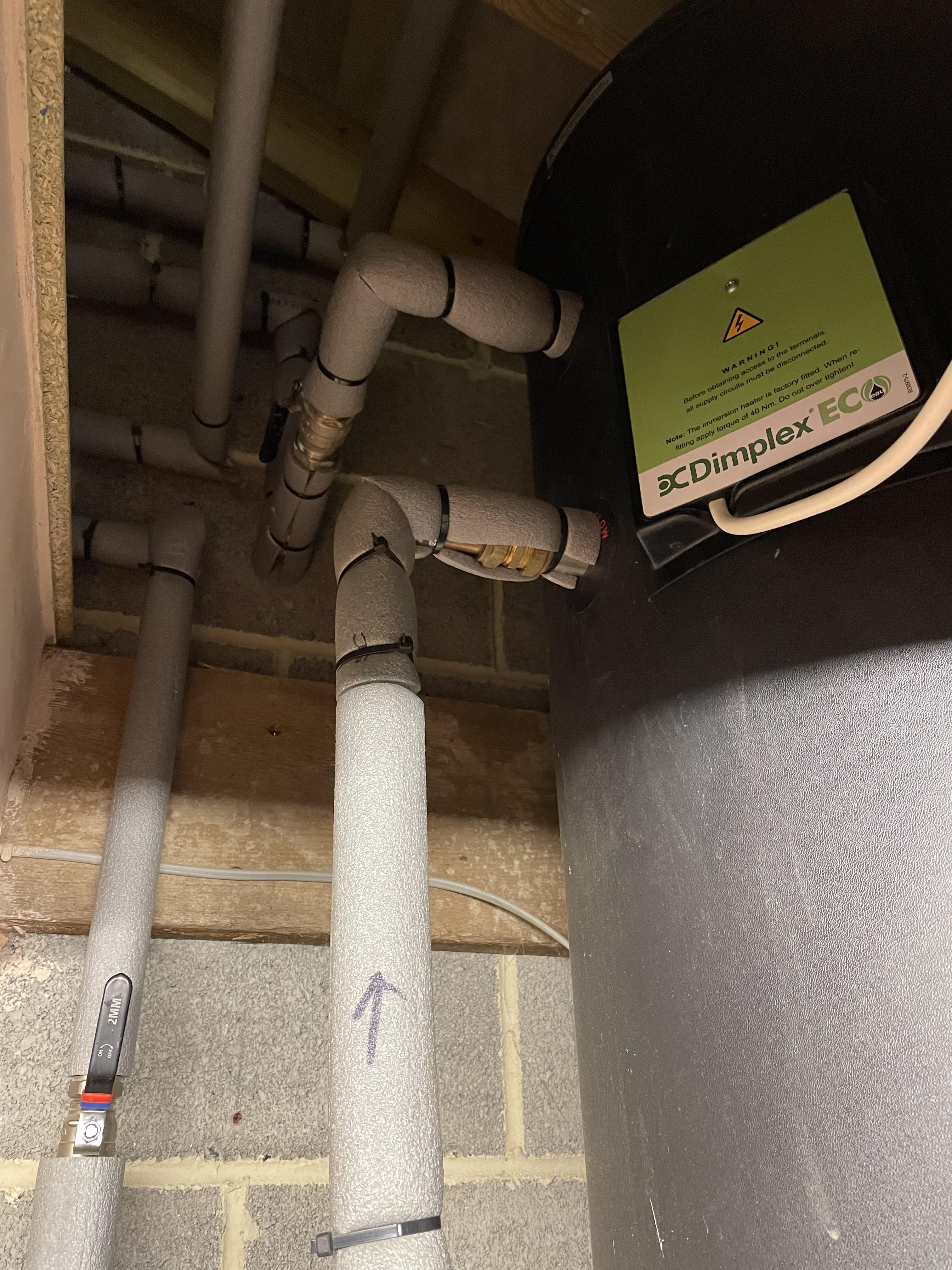

Mark Harrison Posted October 27, 2022 Author Share Posted October 27, 2022 Ok, so I can't see a buffer vessel. The pic shows the heating water pipe going into the top of the big tank, it then exits even higher at the top and there is the pump and it goes into the house. This evening the system would do nothing due to an E912 error but after rebooting it and messing about with the levers on the heating zone valve (I pushed it down from auto to manual override) it's now producing hot water again. Not sure if relevant but the heating zone valve lever (when the system was showing a fault) was completly slack and could be moved up and down freely. At the same time, the hot water was stuck in the up (auto) position and could not be moved down. Link to comment Share on other sites More sharing options...

markocosic Posted November 12, 2022 Share Posted November 12, 2022 Figure out / draw the schematic first. Follow pipes or find the original installer / drawings etc. Then we can give wound advice free of charge. It sounds like a flowrate issue, possibly transient. I wouldn't be surprised if the UFH flowrate is high but the flowrate through the heat pump is low. I wouldn't be surprised if a filter on the heat pump primary is clogged; or the heat exchanger if there isn't a filter. There may be a buffer vessel built into that simplex "cylinder" - phot all the labels.of all your kit and Google the datasheets. As regards replacement: There is nothing exotic about heat pumps. Your own unit is likely fine. Worst case needs a heat exchanger flush. If you're running UFH at low temperatures there's les ls to be gained from a new unit (in efficiency) than there would be if you were running high temperatures into rads. A new boiler for £6k is a joke. Tell them to shove it. Ecodan units are a crock of poop. There's a reason they're marketed heavily rather than selling themselves and there's a reason they're used in social housing developments. Minimum flowrate on those unit in particular is enormous and unhelpful. Link to comment Share on other sites More sharing options...

Kelvin Posted November 29, 2022 Share Posted November 29, 2022 We had exactly the same system in a previous house. The main Grundfos pump failed and was replaced by a different Grundfos pump as we couldn’t get a hold of the original pump. We then had regular E911 errors (and occasional E912 errors) The flow rate was above the minimum needed going by the meter. Our system was designed as is being described here. No buffer tank but had a pump and mixer at each manifold. I eventually figured out that the errors were only being triggered when the living room was calling for heat. In our case it turned out to be a failing manifold pump. It was still running but not at the required flow rate. We also had various valves all fail at the same time too so the fault was hard to diagnose as we had several failures. System was 8 years old. None of these pumps/valves are specific to heatpumps so could happen just as easily with any other heat source. Link to comment Share on other sites More sharing options...
