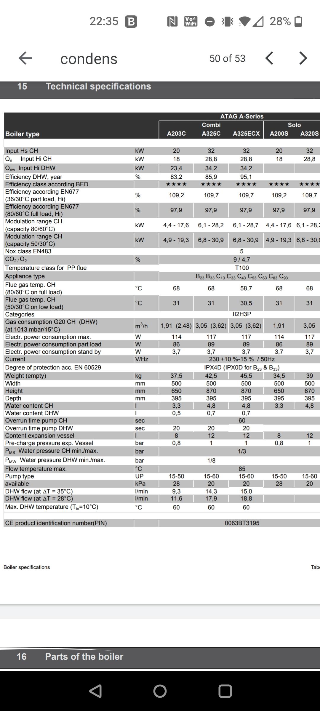

JohnMo Posted October 28, 2022 Share Posted October 28, 2022 Take a look at the efficiency and recorded flue gas temps at low flow temps. Screenshot from the same manual. Link to comment Share on other sites More sharing options...

JohnMo Posted October 28, 2022 Share Posted October 28, 2022 (edited) The idea is the flue gas passes through a heat exchanger, it condenses, gets drained away. The process has a phase change from steam to water, the latent heat is captured by the heat exchanger and passed to water increasing efficiency. The acidic water goes direct to drain after that and does not go through the flue. A condensing boiler working correctly has no steam coming out the end of the flue. My boiler is running at target flow temp of 26 to 29 degrees depending on outside temperature. So they do go below 35 degrees. Edited October 28, 2022 by JohnMo Deleted word Link to comment Share on other sites More sharing options...
scottishjohn Posted October 28, 2022 Share Posted October 28, 2022 (edited) 4 minutes ago, JohnMo said: The idea is the flue gas passes through a heat exchanger, it condenses, gets drained away. The process has a phase change from steam to water, the latent heat is captured by the heat exchanger and passed to water increasing efficiency. The acidic water goes direct to drain after that and does not go through the flue. A condensing boiler working correctly has no steam in coming out the end of the flue. Mine boiler is running at target flow temp of 26 to 29 degrees depending on outside temperature. So they do go below 35 degrees. I presume you are heating a buffer tank and then only heating it when you go below target temp ? or are you directly conecting the boiler to the underfloor system those are floor target temps --not temp of water coming from bioler? Edited October 28, 2022 by scottishjohn Link to comment Share on other sites More sharing options...
JohnMo Posted October 28, 2022 Share Posted October 28, 2022 Yes running a buffer, but the buffer has no thermostat, so just floats at supply temperature, so is never hotter than target flow temp. Plumbed as a 2 port buffer. Boiler fires up when it sees the return temperature drop to a level where its happy to fire up, keeps firing until it's no longer happy. On an average 10 degree day, fires for 10 mins, off for 2 hours. -5 day, on for 30 mins off for 30mins. 1 Link to comment Share on other sites More sharing options...
scottishjohn Posted October 29, 2022 Share Posted October 29, 2022 10 hours ago, JohnMo said: Yes running a buffer, but the buffer has no thermostat, so just floats at supply temperature, so is never hotter than target flow temp. Plumbed as a 2 port buffer. Boiler fires up when it sees the return temperature drop to a level where its happy to fire up, keeps firing until it's no longer happy. On an average 10 degree day, fires for 10 mins, off for 2 hours. -5 day, on for 30 mins off for 30mins. so as suspected the boiler is not running at 35c ,but 54+ where it will be happy and not cause ezxcessive corrosion to flue +heat exchanger Link to comment Share on other sites More sharing options...
JohnMo Posted October 29, 2022 Share Posted October 29, 2022 Sorry you really need to read up on condensing boilers theory. What you have been told is just wrong and applies to non-condensing boilers. Not sure where your getting my boiler is running at 54+ degs from, last time I looked while the boiler was firing it had a supply temp circa 28 and return 23/24. If it gets to 35 it is forced to cut out, by the settings. Only time it goes above that is for DMW as its a combi. Link to comment Share on other sites More sharing options...

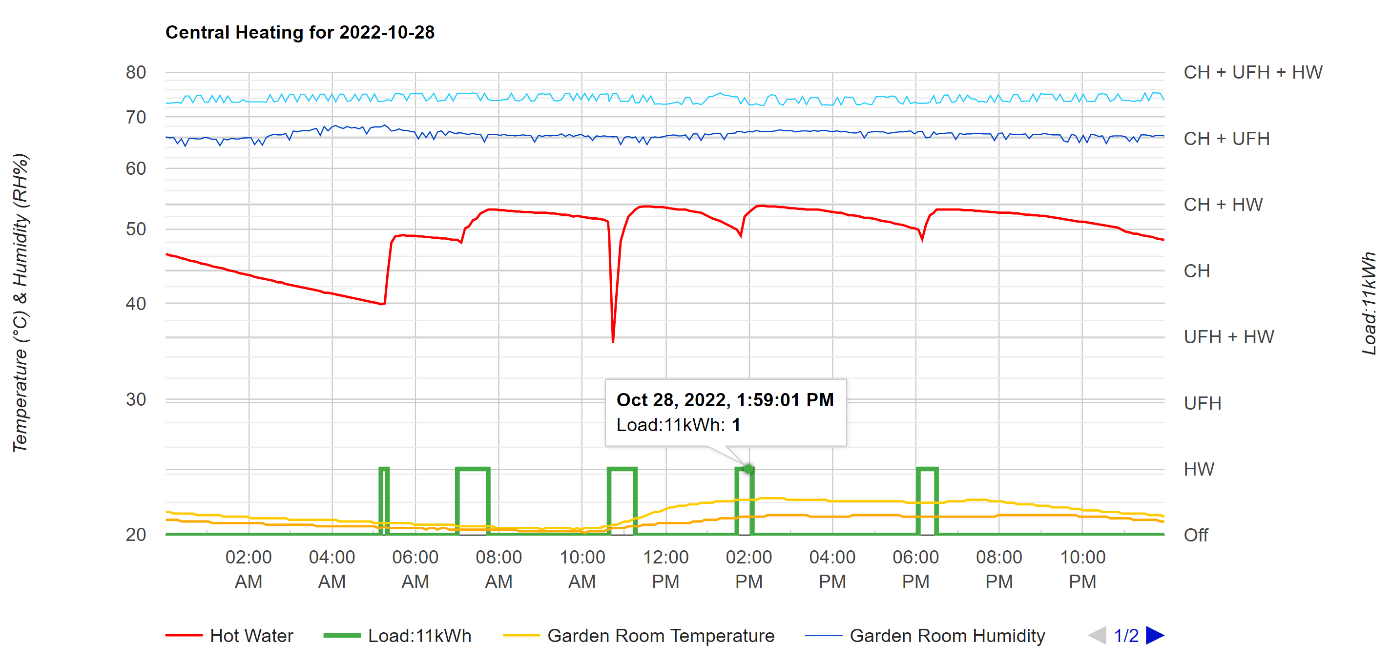

Radian Posted October 29, 2022 Share Posted October 29, 2022 12 minutes ago, Green Power said: Say Radian is right that under 20W - call it an even 20 - for a pump. We still have 35W for a fan, so we now have 55W total. 55W x 4 hours = 220Wh = 0.22kWh x 365 days = 80.3 kWH/year. x £0.34 /kWH = £27.30/year = £355 over the 13 years. 4 hours for 365 days isn't very realistic. Here's how much time my boiler ran yesterday (quite typical for 8 months of the year) 2hr 10mins for HW. Minus a bit for the last push up to 55oC which always entails a couple of on-off cycles when the boiler can't modulate any lower. Link to comment Share on other sites More sharing options...
JohnMo Posted October 29, 2022 Share Posted October 29, 2022 1 hour ago, Radian said: 4 hours for 365 days isn't very realistic. Here's how much time my boiler ran yesterday (quite typical for 8 months of the year) 2hr 10mins for HW. Minus a bit for the last push up to 55oC which always entails a couple of on-off cycles when the boiler can't modulate any lower. So are you using 2 hours x 11kW or 22kWh per day for hot water? That doesn't sound right? Link to comment Share on other sites More sharing options...
Radian Posted October 29, 2022 Share Posted October 29, 2022 54 minutes ago, JohnMo said: So are you using 2 hours x 11kW or 22kWh per day for hot water? That doesn't sound right? The total daily consumption (load) is as is labelled in the plot: 11kWh. Someone had a very long shower at 10:30 and it wasn't me 🙄 Link to comment Share on other sites More sharing options...
