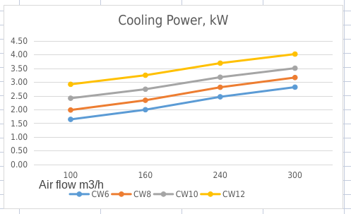

LinearPancakes Posted November 5, 2022 Share Posted November 5, 2022 (edited) 11 hours ago, Dan F said: @LinearPancakes CW12 is big. What is you building volume? Are you planning to hook up the whole house via CW12 or only part? It will be on the main supply to the whole house. Our home will only be 144m2, so it's way overspecced. A couple of reasons we decided on this: To maximise the cooling output even at lower air volumes. I understand that in the peak of summer, when outside is much hotter than inside, it's generally recommended to keep the MVHR speed lower, since inside will still gradually increase in temperature. I extrapolated, by interpolating the data on the datasheet, that the CW12 should deliver ~3kW cooling even at ~100 m3/h. The CW6 for example could only achieve ~1.6kW. Chart attached. The reduce air resistance, both when not actively cooling but also when cooling as the air resistance increases a lot then, presumably due to condensation internally. The CW12 should have a negligible air resistance of ~7Pa when cooling at a boost of 240m3/h. The CW6 comes in at ~33Pa for that. (Caveat, all theory so far!) Edited November 5, 2022 by LinearPancakes 1 Link to comment Share on other sites More sharing options...
Dan F Posted November 5, 2022 Share Posted November 5, 2022 I maybe be wrong, but I don't think the extrapolation should be linear should it? Thre is only a maxiumum you can cool with 100m3/h regardless of the size of the comfopost and, while I haven't done the sums, I'm pretty sure it's less than 3kW. Link to comment Share on other sites More sharing options...
LinearPancakes Posted November 9, 2022 Share Posted November 9, 2022 Yeah, hard to say for sure since the datasheets don't go down that far. Link to comment Share on other sites More sharing options...
Dan F Posted November 12, 2022 Share Posted November 12, 2022 On 09/11/2022 at 09:08, LinearPancakes said: Yeah, hard to say for sure since the datasheets don't go down that far. Well, it's constrained by the specific heat capacity of air and 3kW @ 100m3/h just doesn't work. Using the parameters in the comfopost datasheet the maximum theoretical sensible cooling power at 100m3/h is 0.52kW (1.35kW total @ 80% RH). A bigger comfopost simply can't improve on this! You also need to consider that the numbers in the datasheet assume 28C @ 80%RH. The reality is that on 18th July 2020 (when it was 37C outside) my Comfopost unit was getting around 25C due to MVHR being operational. What MVHR unit are you planning to use and what is your planned maxumum flow rate? Link to comment Share on other sites More sharing options...
