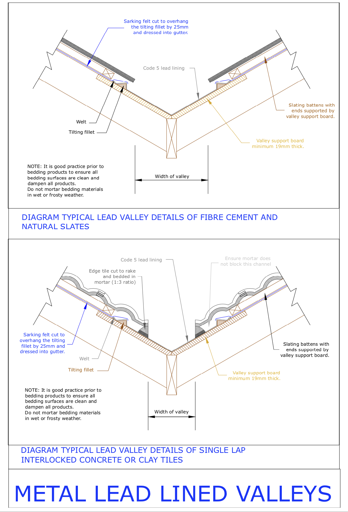

luk4sh31 Posted October 19, 2022 Share Posted October 19, 2022 Hello. I have new valley installed last year for extension and the roofers put membrane on top of the boards before lead work. I was told recnelty that you should not used breathable felt on top of the valleys when laying lead. Can someone else share their views in this matter. thanks Link to comment Share on other sites More sharing options...
Dave Jones Posted October 19, 2022 Share Posted October 19, 2022 grp valleys are better than lead and cheaper. no issue with membrane below a valley. belt and braces etc Link to comment Share on other sites More sharing options...
nod Posted October 19, 2022 Share Posted October 19, 2022 Most of the housing associations insist on a length of 600 dpc under the Fibre glass Lead is more expensive but far better than fiberglass You can walk up lead also Link to comment Share on other sites More sharing options...
Temp Posted October 19, 2022 Share Posted October 19, 2022 6 hours ago, luk4sh31 said: Hello. I have new valley installed last year for extension and the roofers put membrane on top of the boards before lead work. I was told recnelty that you should not used breathable felt on top of the valleys when laying lead. Can someone else share their views in this matter. thanks I thought the membrane should drape in to the valley gutter, so any rain or snow blown under tiles runs down into the valley gutters. Link to comment Share on other sites More sharing options...
makie Posted October 19, 2022 Share Posted October 19, 2022 5 hours ago, Dave Jones said: grp valleys are better than lead and cheaper. no issue with membrane below a valley. belt and braces etc There is, breathable membrane should never be used under lead as it sweats badly. Lead manufacturers recommend building paper. Link to comment Share on other sites More sharing options...
makie Posted October 19, 2022 Share Posted October 19, 2022 25 minutes ago, Temp said: I thought the membrane should drape in to the valley gutter, so any rain or snow blown under tiles runs down into the valley gutters. You should have a run of membrane under the the valley and then membrane should lap the grp/lead etc Link to comment Share on other sites More sharing options...
