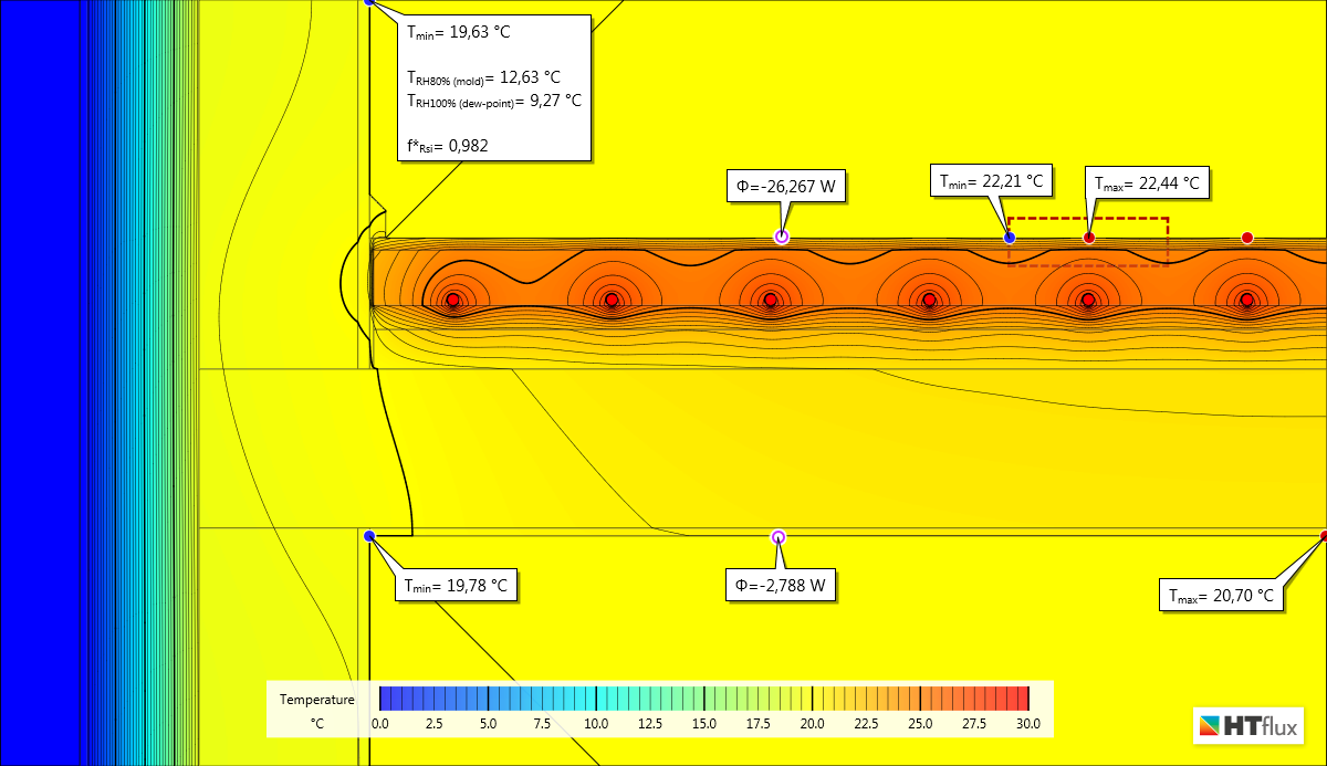

Radian Posted October 17, 2022 Posted October 17, 2022 3 hours ago, SteamyTea said: UFH requires a lot of insulation under it, around 200mm. Have we seen a thermal model to support this? Y'know, one of those thermal modelling apps like HTflux? All the decent free trial versions I've downloaded have long since expired and the only web images I can google up don't show relevant examples of ground floor loops e.g. this first floor example:
SteamyTea Posted October 17, 2022 Posted October 17, 2022 5 minutes ago, Radian said: Have we seen a thermal model to support this? Y'know, one of those thermal modelling apps like HTflux? Someone did a few a while back (probably on the predecessor to here). Have you tried LISA?
Radian Posted October 17, 2022 Posted October 17, 2022 2 hours ago, SteamyTea said: Have you tried LISA? I thought that was for modelling dynamic stresses? Maybe it can be used for simple static temperature distribution. I now see it seems you can set surface temperatures to model their affects on material properties. A couple of common test cases would seem to be informative. Even if simplified to model an infinite plane with conduction only in Z. I was also wondering how convection would affect the case of block and beam construction where a layer of warmer air should pool just below the blocks, and how this would compare with a solid raft sat on the ground which would have continuous conduction but over a potentially lower delta. Obvs. no help if a howling gale is blowing across the beams!
