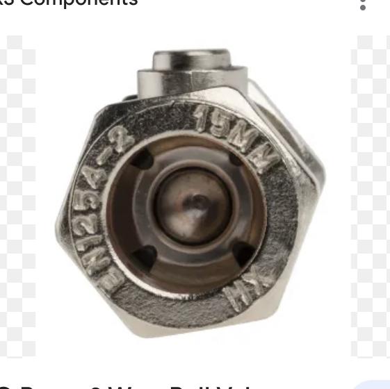

Nickfromwales Posted October 16, 2022 Posted October 16, 2022 18 minutes ago, Question said: I had a radiator installed (dual fuel with electric element). There is a TRV on one side but no balancing valve on the other side. There is an isolation valve on the other side. Should I (a) use the isolation valve as a balancing valve, or (b) get the plumber back and ask him to put a balancing valve as he should done originally? Thanks. Do you have a pic of the isolation valve please? Do you mean they fitted a ballofix valve? One of these?

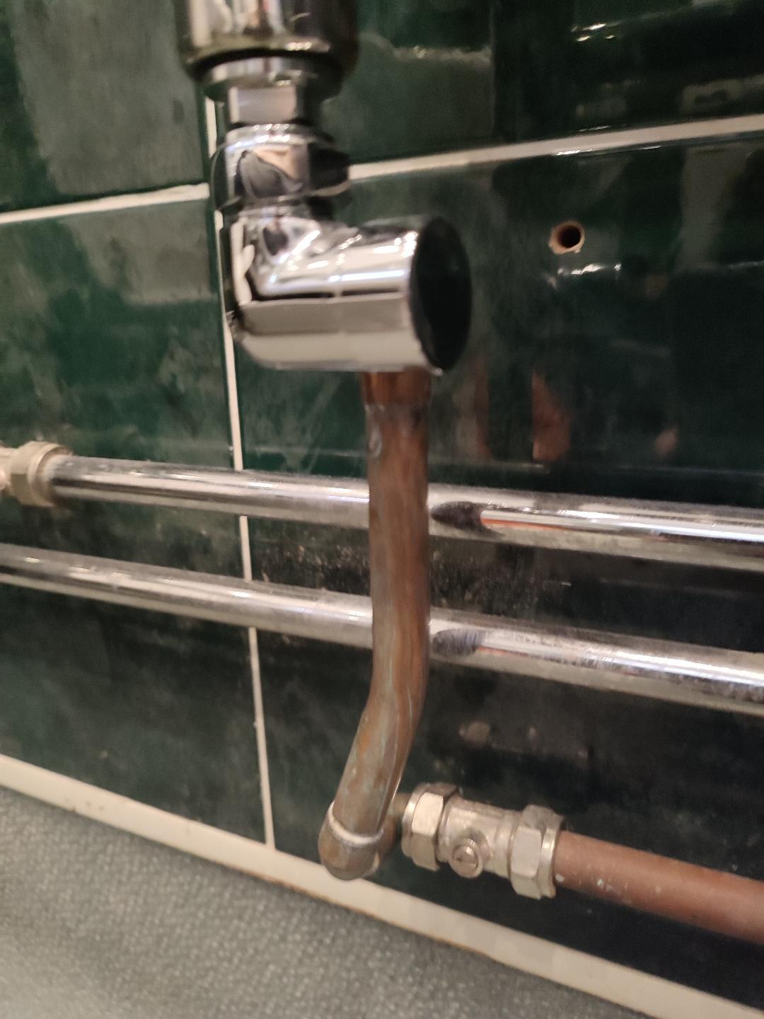

Question Posted October 16, 2022 Author Posted October 16, 2022 (edited) yes, here is a picture. See copper pipes (ignore silver ones) Edited October 16, 2022 by Question
Nickfromwales Posted October 16, 2022 Posted October 16, 2022 Ah, OK The plumber has fitted the balancing valve, and you’re staring at it Grab the circular chrome cap of the valve that side and unscrew it. Bingo
Nickfromwales Posted October 16, 2022 Posted October 16, 2022 The ballofix valve shouldn’t be of CH pipework though. I hate seeing them used. Should be ( if absolutely necessary ) full bore valves, not a ballofix, as they are very narrow bore and are usually used for isolating hot / cold feeds ( mains pressure ).

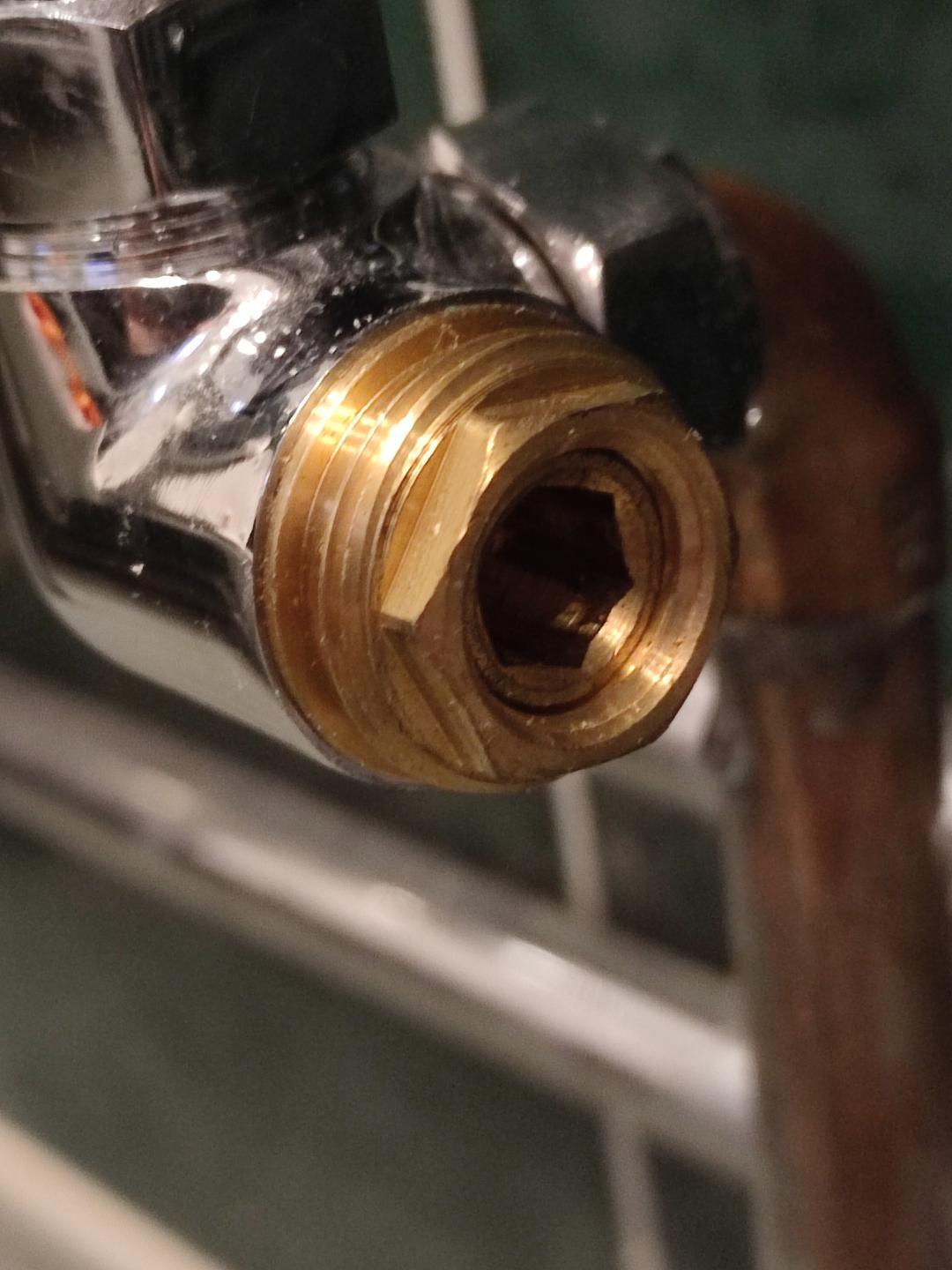

Question Posted October 16, 2022 Author Posted October 16, 2022 (edited) here is the photo when I remove the circular chrome cap. Do I just turn the nut? How does the ballofix affect the CH? How do you know that it is not full bore? It has 15 written on it. Edited October 16, 2022 by Question
Nickfromwales Posted October 16, 2022 Posted October 16, 2022 51 minutes ago, Question said: here is the photo when I remove the circular chrome cap. Do I just turn the nut? Turn the Allen head grub screw. DON’T touch the nut! 52 minutes ago, Question said: How does the ballofix affect the CH? The seal wears out after a few years due to the ferrous particulate in the water eroding it. 53 minutes ago, Question said: How do you know that it is not full bore? It has 15 written on it. 30 years of fitting them

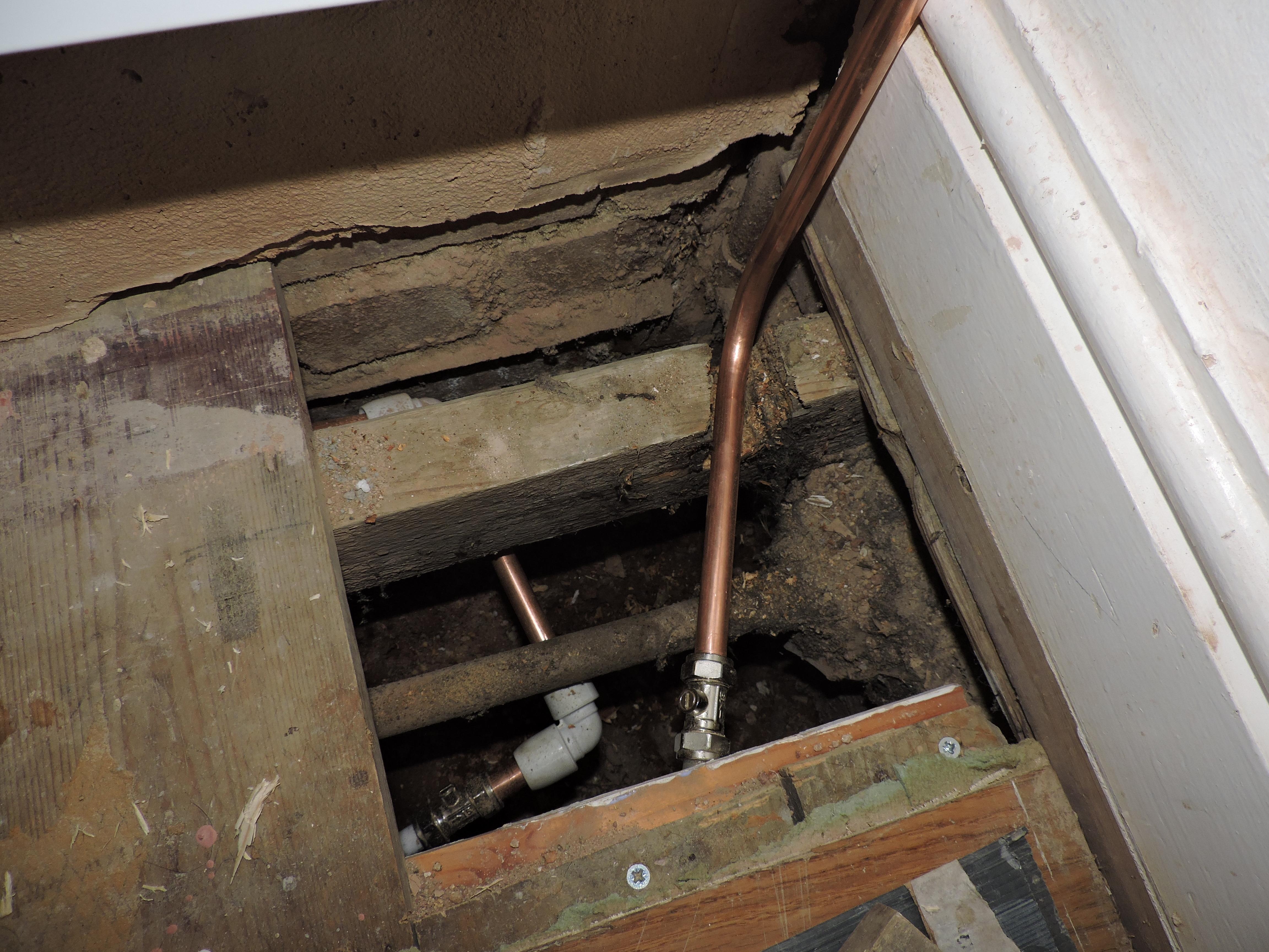

Question Posted October 16, 2022 Author Posted October 16, 2022 Thanks so much. We have quite a few isolation valves on CH system. Two recently installed ones are under wood flooring that would be difficult to access (see photo). Some were recently installed. What is the easiest way to sort this out? Should I replace them with full bore ones?
Nickfromwales Posted October 16, 2022 Posted October 16, 2022 (edited) Jesus Christ! Get them all taken out. Ticking time bombs. Stinks of a lazy plumber who’s used those to save draining down properly. Seriously, they all need coming out. Edited October 16, 2022 by Nickfromwales

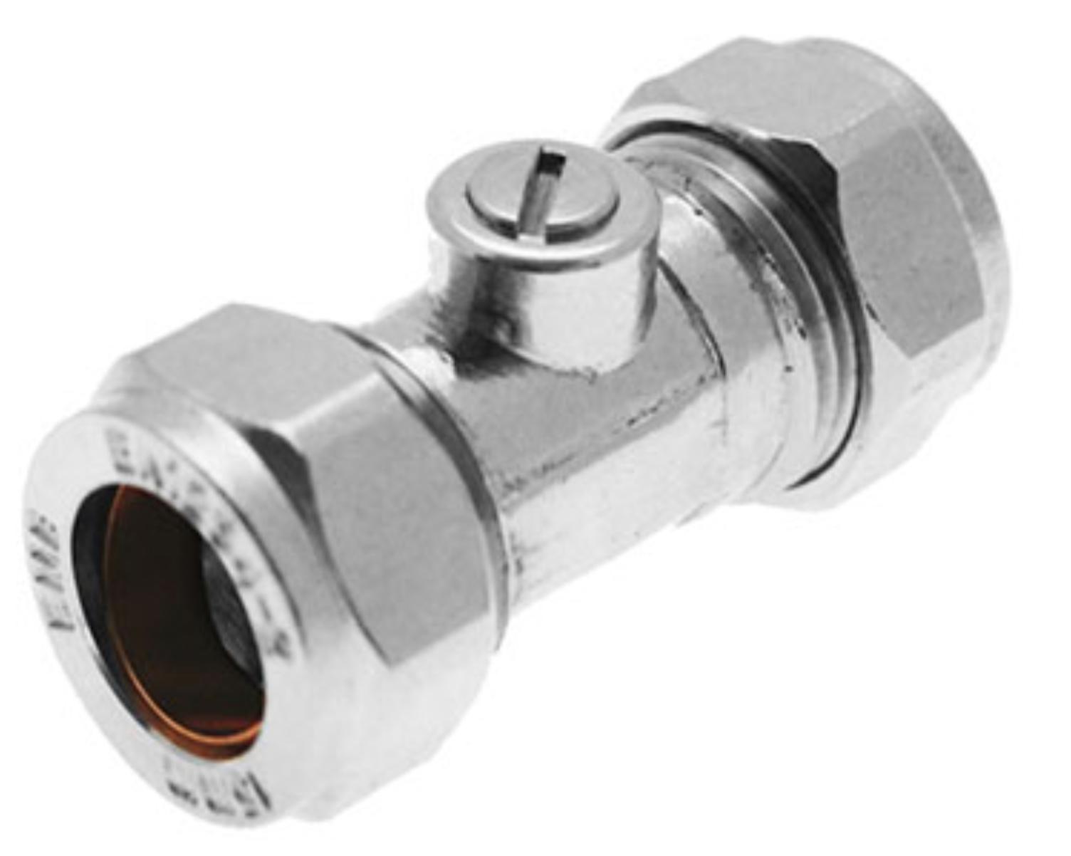

Nickfromwales Posted October 16, 2022 Posted October 16, 2022 (edited) Link You’ll see the full bore isolations have a much fatter body than the poky little ones. When they get removed, as to see inside one You can’t fit a pencil through one. Edited October 16, 2022 by Nickfromwales

Nickfromwales Posted October 16, 2022 Posted October 16, 2022 Bugger. Just spotted the compression onto pushfit, which I despise, but here it is catastrophic. The ballofix isolation valve does t have enough depth to get the insert and the olive in far enough to be robust. That one, and any others like it, need cutting out ASAP. This is especially problematic if the pushfit is JG speed fit pipe , but I can see a hep2o elbow there so it’ll hopefully have the very thin stainless insert. Sorry, but another issue to add to the rectify list……..
Spreadsheetman Posted October 16, 2022 Posted October 16, 2022 6 hours ago, Nickfromwales said: Link You’ll see the full bore isolations have a much fatter body than the poky little ones. When they get removed, as to see inside one You can’t fit a pencil through one. Can you recommend particular full-bore valves? Any have compact actuators, or are they all large levers?
Nickfromwales Posted October 16, 2022 Posted October 16, 2022 3 hours ago, Spreadsheetman said: Can you recommend particular full-bore valves? Any have compact actuators, or are they all large levers? For heating, I only ever use gate valves or suitable metal seated lever ball valves. For potable, eg hot / cold water, see the link I gave a few posts back 1
