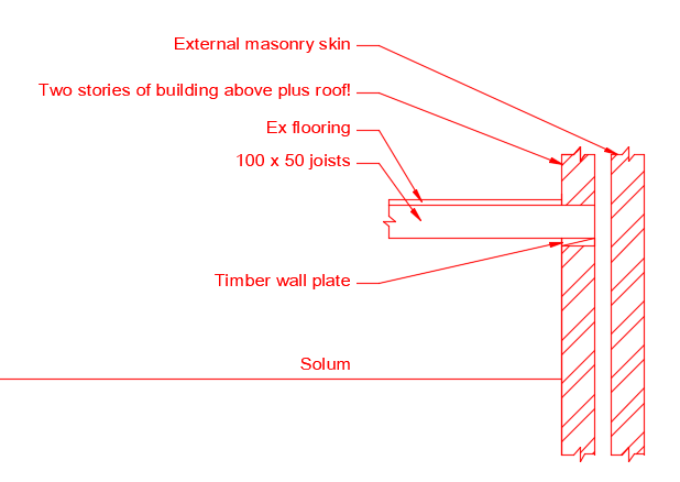

Gus Potter Posted October 14, 2022 Share Posted October 14, 2022 9 hours ago, andyscotland said: I don't have enough on my list I too have a 1960's house, want to insulate the living room floor. Good news for me is that it's not a kitchen or bathroom so moisture levels will be not too severe. Â Problem I have is that the joists are built into the inner leaf of masonry on a timber wall plate. Yes.. the inner skin is carrying all the roof load plus two stories of masonry above! Â I'm still trying to get my head around the best way of doing this. Big worry is that if I cause damp / condensation in the wall plate the whole house will drop! Â Will keep mulling it over. There must be a way! That is as far as I have got to date, like you that list is a journey. Â Â Â Â Â Â Â 1 Link to comment Share on other sites More sharing options...

andyscotland Posted October 14, 2022 Author Share Posted October 14, 2022 (edited) 1 hour ago, Gus Potter said: Problem I have is that the joists are built into the inner leaf of masonry on a timber wall plate. Yes.. the inner skin is carrying all the roof load plus two stories of masonry above!  Yikes! Fortunately mine are on sleepers so that makes life easier.  1 hour ago, Gus Potter said: Will keep mulling it over. There must be a way! That is as far as I have got to date, like you that list is a journey.  I'm finding one of the biggest issues bringing a house up in stages while living in it is the constant journey of "well, this would be viable at the moment but in X years time when we do Y then [something else will be easier/that will cause us a problem]"  Identifying the critical path and the logical way to approach things is a journey & a job in its own right!  Not to mention there is a budget for how many things can be in progress/look a bit of a mess for a while because finishing them would be undone in a future phase, without triggering divorce 🤣  Many evenings turning over ideas in the mind and trying to work out how it all fits together, then energy goes through the roof and you start to think "JFDI"! Edited October 14, 2022 by andyscotland Link to comment Share on other sites More sharing options...
