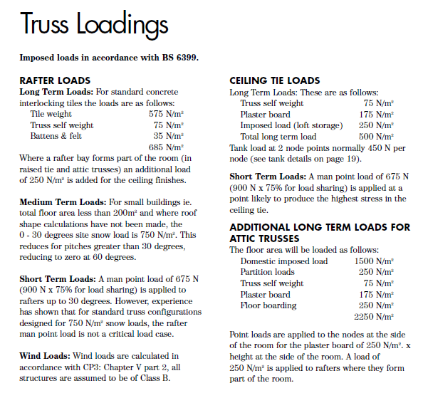

Gus Potter Posted October 14, 2022 Share Posted October 14, 2022 12 hours ago, Nick Thomas said: The way I read it, Yes Nick good point. Below is a screenshot from a typical truss manufacture. The loadings they use have been in common use for a long time so you can take these as a guide to an old cut timber roof. For ease of reading 100 N (Newtons) = ~ 10 kg so 250N = ~ 25 kg. The load we are looking at here is in the second column in the ceiling tie loads.. called imposed load (loft storage) .. that also includes anything you put on top of the original timbers @Ferdinand.. any legs, secondary flooring and so on. Confusion often arises as there is a difference between long, medium and short term loads in timber design. A bit of wood will carry quite a bit more weight if it is just subject to a load (short term) like a person of "large stature" walking about in the loft checking the plumbing.. but like glass it is less able to carry long term loading such as storage and the bits and bobs ( eg, extra flooring and insulation) folk put up there long term. Loft storage is considered a long term load for design purposes. But if you put a 50 kg tent and can be sure that after you have put in a "secondary floor" that spreads the load about and it will not overload the roof structure then you are good to go. Roughly you often find that if you put in an extra layer of flooring you can add another 10kg per sq m of say xmas decorations. Now to be on the safe side you need a lot of secondary unloaded floor! What folk often do is to say, can I put the tent over a load bearing wall below? Now you need to use common sense and make sure that the wall is truly load bearing all the way down the building. If so then the tent will have little impact compared to the weight of say a load bearing masonry wall. Link to comment Share on other sites More sharing options...
Ferdinand Posted October 15, 2022 Share Posted October 15, 2022 Yes - that all seems well expressed, @Gus Potter. This is the comment from the linked FAQ page, which a - specifies that a person accessing the loft shall temporarily be supportable, and b - is 1996 building regs, so earlier lofts need to be considered separately (and Wickes quotes 50kg). I'd do a couple of joist dimension and spacing measurements and span calculations and compare with load and span tables making conservativer assumptions eg *: https://www.timberbeamcalculator.co.uk/en-gb/span-table/floor-joists?load=1.5&class=C24 (Notes: 1 - a sensible assumption will need to be made about timber grade. 2 - a 1kg load imposes about 0.01 kN ) British Standards BS6399-1:1996 for new build homes installed with a loft hatch require trusses to be designed to carry a 25Kg per square metre storage load plus the temporary load of a person moving around in the loft. Some homes may have been designed to exceed this but if you want to exceed 25Kg per square metre we would recommend consulting a structural engineer. One tactic is deliberately to board only near the hatch so no large people climb into the loft. As for putting things like boilers and batteries in lofts - not something I like. I have one in a loft in a rental, and it is a bit of a sod. I boarded out a walkway to the boiler in 2ft wide OSB over the bottom layer of insulation, then put the top layer of insulation in the same direction so that removal of one stripe would clear the walkway, and put a sign next to the loft hatch. I would not put a potential fire hazard or weight like a battery anywhere near a loft. They go in the garage or in a fireproof booth. F Link to comment Share on other sites More sharing options...

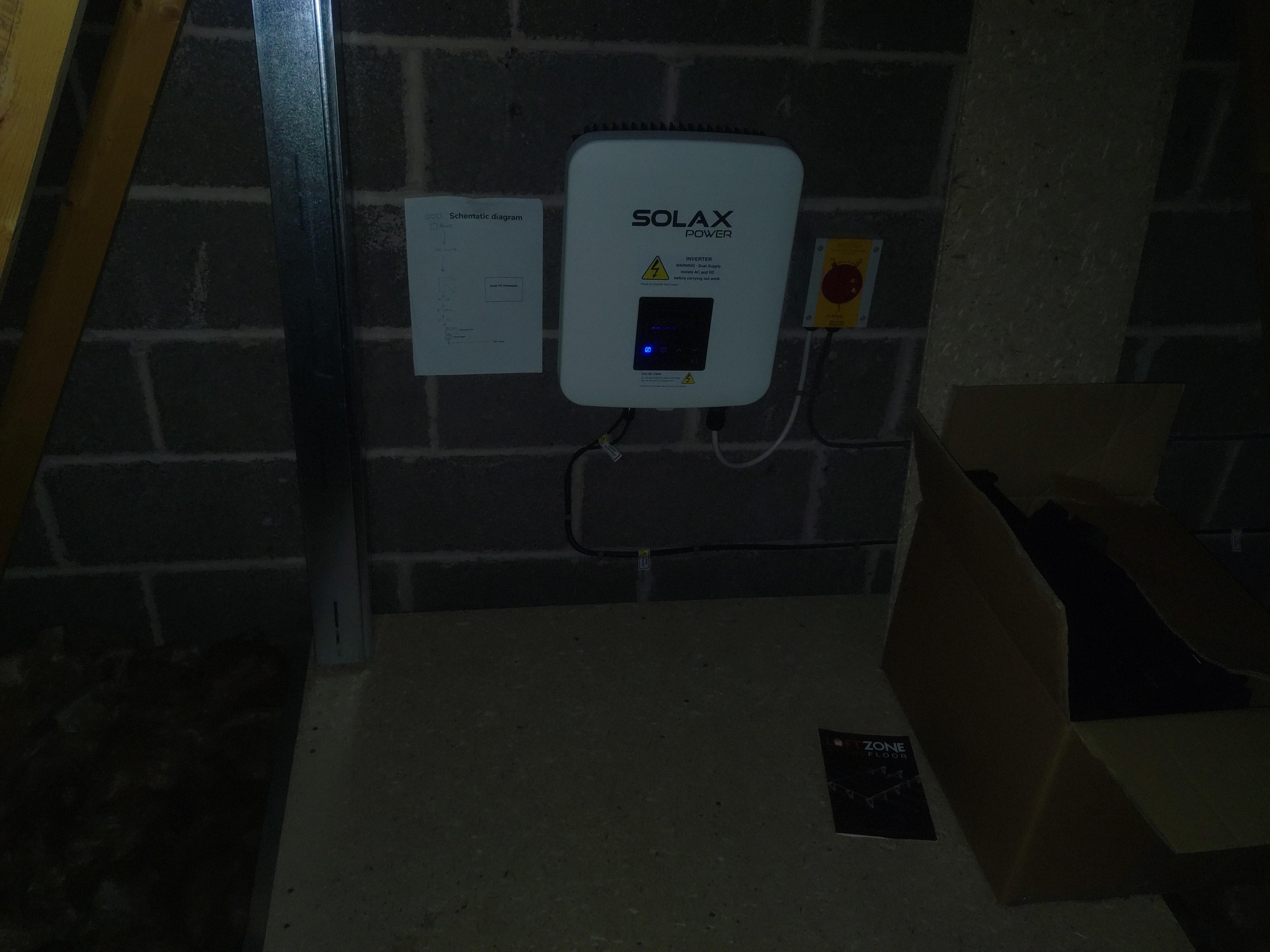

Nick Thomas Posted October 15, 2022 Share Posted October 15, 2022 (edited) Thanks for the extra detail! Anything that goes near structural calculations is way over my head at the moment, but it's good to get chapter and verse nonetheless. Couple of other suggested options come up in https://www.theloftboys.co.uk/lofts/loft-boarding/ - they also suggest counter battens, and (presumably their proprietary) "LoftZone StoreFloor"™®© system, which is like the legs, but maybe a bit less work to install. I hadn't really thought about the safety aspect of batteries in the loft, but fixing them to the wall at least avoids the loading issues - I just need to improve the access and get some boarding down that they can use while installing. The batteries I'm going for are LiFePO4, so not incredibly high-risk from a fire point of view. They're DC-side wth the solar, so putting them anywhere *but* the loft would imply a ridiculous DC cable run. They and the inverter rely on convection for cooling, so boxing them in would probably do more harm than good. Worst-case, at least the fire wouldn't be between me and the exit, right? Edited October 15, 2022 by Nick Thomas dc-side clarif Link to comment Share on other sites More sharing options...

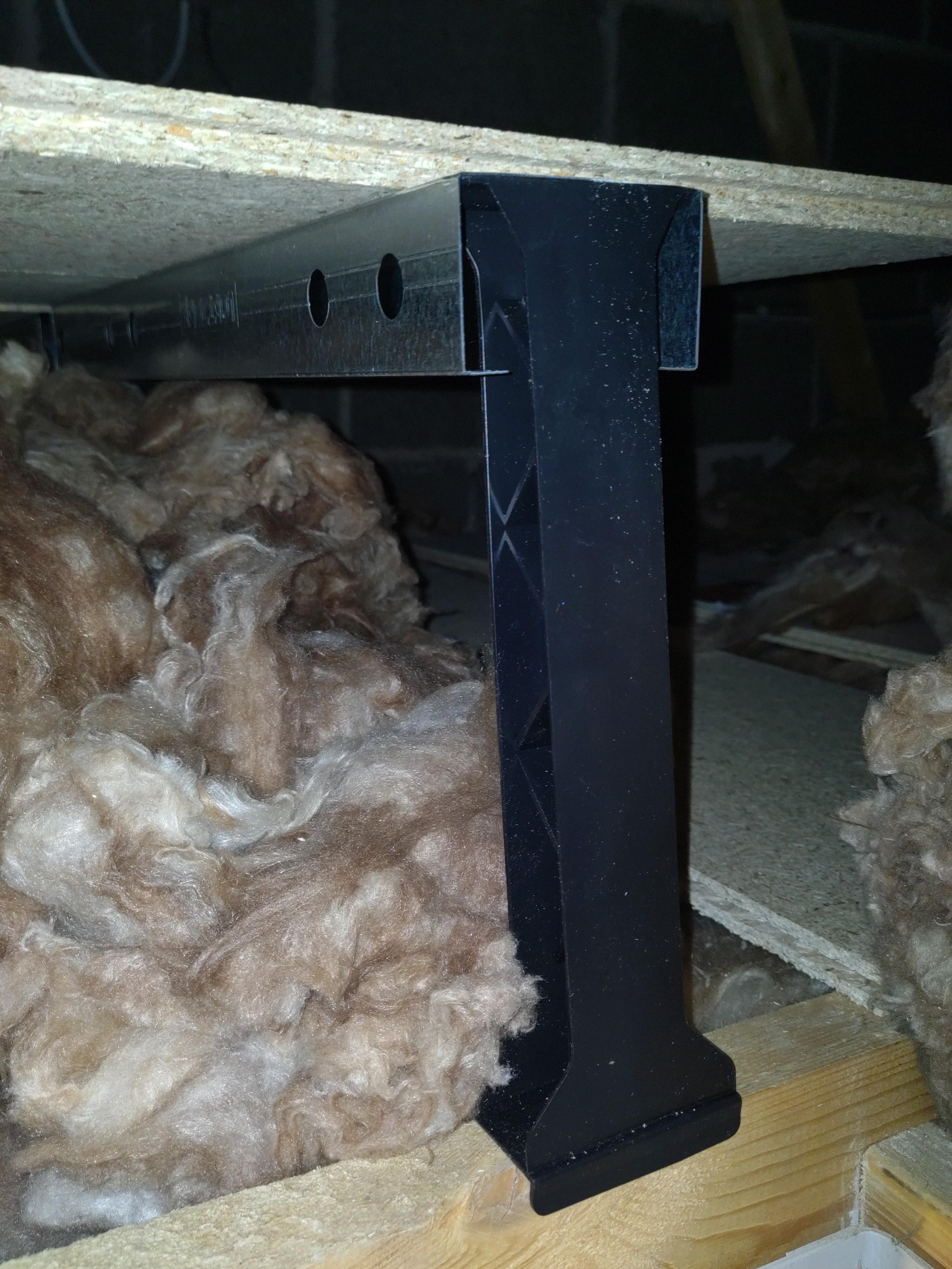

Nick Thomas Posted October 19, 2022 Share Posted October 19, 2022 With a bit more research I've decided to go with the "LoftZone StoreFloor". With the boards, it works out at £40-50/M² for the kit; on a supply+fit basis, it's ~£100/M². I don't have a huge acreage to do so it hardly matters either way, but it seems like an easy enough project. Famous last words. Link to comment Share on other sites More sharing options...
Nick Thomas Posted November 5, 2022 Share Posted November 5, 2022 Just an update on this - the stuff came last week and I've fitted the initial platform in front of the inverter in the loft. The alu rails go crosswise to the joists, and there are two types of legs - triangular and stick. The idea is to use the triangular legs every other joist, then come back and reinforce with the straight legs under half of the missed ones, in a staggered pattern. I seem to have picked the hardest bit to start with though - the rails start flush against the gable end and come down past the hatch, which is > 600mm long so it interrupts one of the rails. Gable to hatch is just over 1.2M, and no room to use the triangular legs at either end so it's straight, triangular, straight, which also meant cutting the alu rails (they're slightly shorter than 1.2M) for that section in half. I'm not missing any joists out for this section, so I'm sure it's still plenty strong enough, it was just.. awkward. Next is the section where the loft ladder will be attached, so I have an L-shaped boarded area around the hatch. They suggest using some of the boards to cover the legs around the hatch (shown in the second picture), I guess I can just add some wood behind that to give the ladder something to screw into. Link to comment Share on other sites More sharing options...
