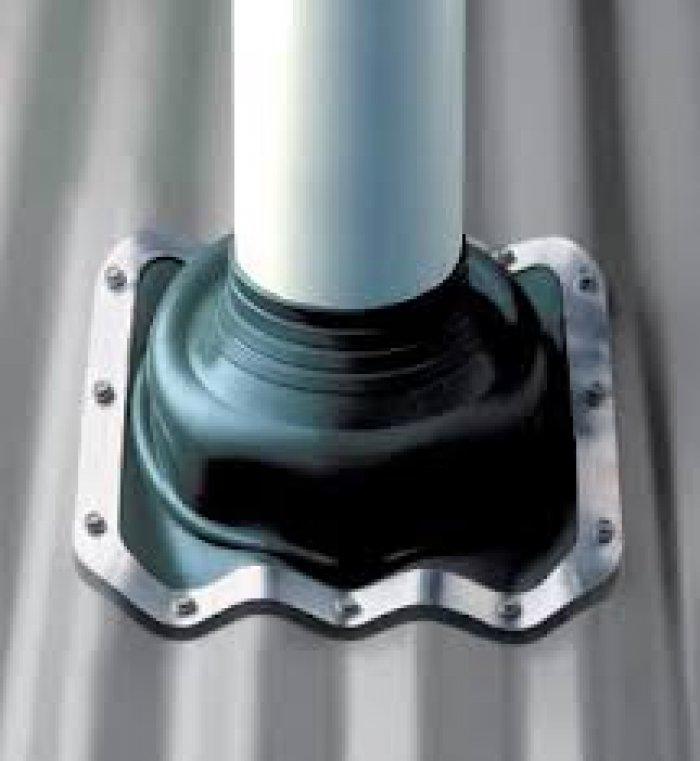

saveasteading Posted October 13, 2022 Posted October 13, 2022 One of these. Needs to be suitable for high temperatures so it is likely to be red, but worth asking for high temp black if possible. They each have a range of diameters they can be cut to. Choose the biggest as that allows more tolerance and best fit on the pipe. On a steepish roof the silicon skirt has to distort from slope to vertical. I have known plumbers make a right mess of installing these, so don't assume the skills are there. Needs roof screws and mastic tape. In answer to how much prep to do...it depends if you think you or the roofer will do the better job. I would us an old fashioned plumb bob to get the hole in the right place, then a vertical pilot hole. NB the circular pipe requires eliptical holes through the roofing materials. .or oversized circles. 2
