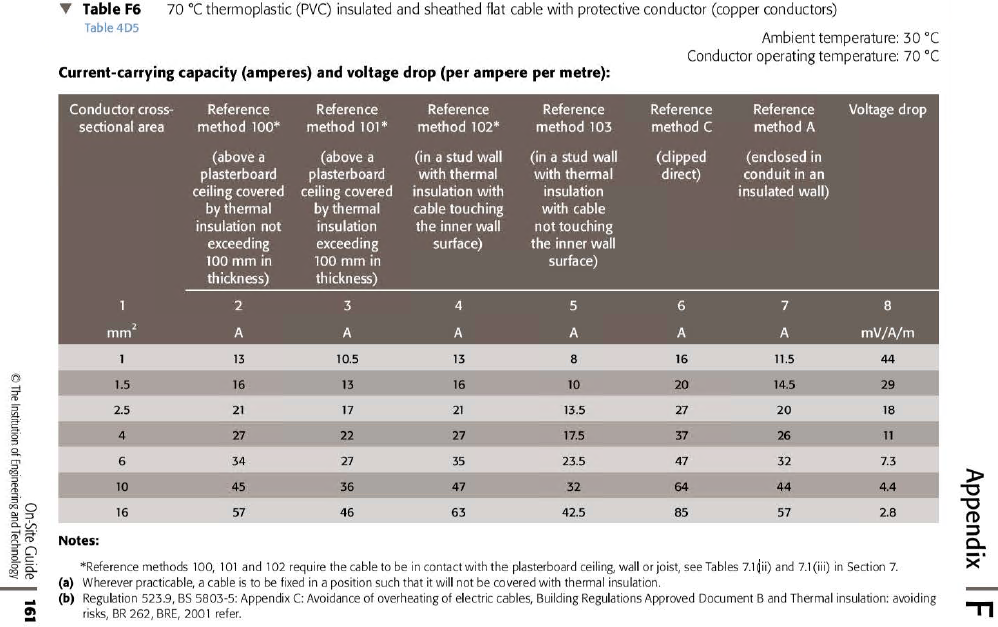

MortarThePoint Posted January 16, 2023 Posted January 16, 2023 (edited) Interestingly, if you adopted a completely centralised approach where all lights are directly powered by a centralised controller, you could probably wire it in 0.5mm2 T&E (which is apparently going to be available) if using 48VDC. Extending Table F6 to 0.5mm2, that should be 88mV/A/m. A 10W 48VDC light at 33m (66m round trip) would then suffer a voltage drop of 88mV/A/m * (10W / 48V) * 66m = 1.2V or 2.5%. I would expect that with a good choice of central control location, pretty much all lights could be <10m so suffer less than 0.367V --> 0.8% voltage drop. Another plus for 48VDC over 24VDC which would suffer 4x the percentage voltage drop. You'd have lots of long cables to run, but have only one central brain to which all switches communicated. A 10m 0.5mm2 cable would probably cost about £2. Edited January 16, 2023 by MortarThePoint

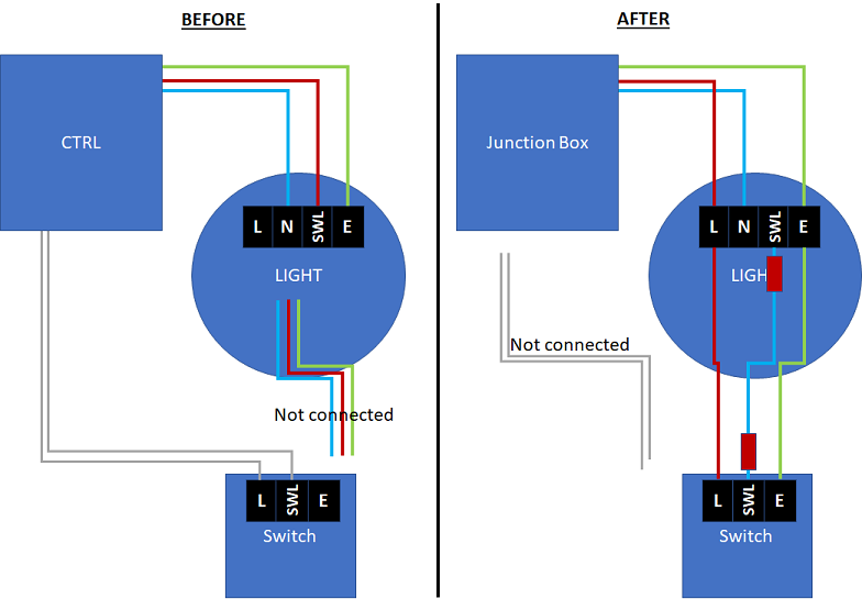

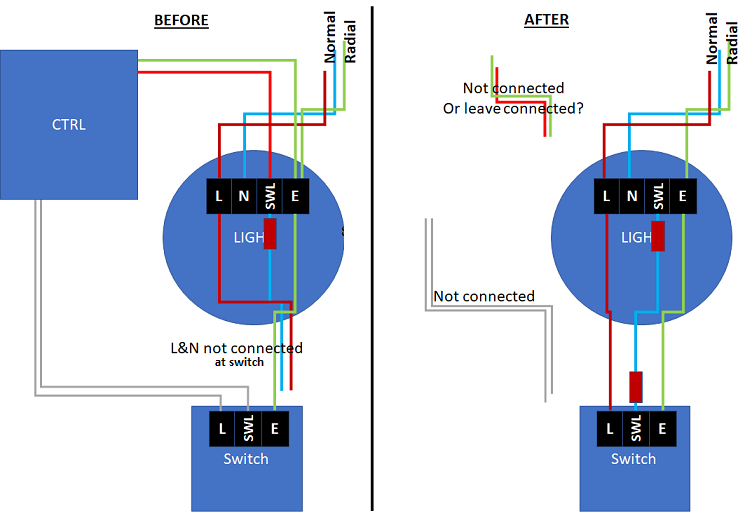

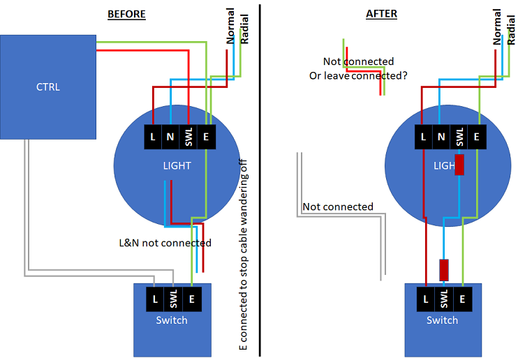

joth Posted January 17, 2023 Posted January 17, 2023 That seems crazy amount of cable to pull. In the before case I see 4x T&E per light fitting. That's on top of a data bus If you have smart switches (knx or Loxone tree). In my build we did one switch line T&E per light fitting, direct from the lighting cabinet to the light, plus the control bus linking up switches. I can still convert this to more or less conventional if ever needed by replacing the lighting cabinet with a bank of 24V to mains relays. Your other 3 T&E seem overkill
MortarThePoint Posted January 17, 2023 Posted January 17, 2023 (edited) 1 hour ago, joth said: That seems crazy amount of cable to pull. In the before case I see 4x T&E per light fitting. That's on top of a data bus If you have smart switches (knx or Loxone tree). In my build we did one switch line T&E per light fitting, direct from the lighting cabinet to the light, plus the control bus linking up switches. I can still convert this to more or less conventional if ever needed by replacing the lighting cabinet with a bank of 24V to mains relays. Your other 3 T&E seem overkill It is a lot of wires to pull, but in my case that doesn't take long as I have an open ceiling void atm. I count the following to the light in the before case: T&E from radial IN T&E from radial OUT (not for all) T&E to switch single&E to CTRL And at the switch: T&E to light (only E connected) bell to CTRL The bold is what a normal wiring would have. Your setup is need having only one cable to the light and only one cable to the switch. I get that you could revert your setup to something a bit more normal, but that would still be quite an unusual setup. As I understand it, my original BEFORE/AFTER drawing (3 posts back) is your layout with the addition of the light to switch cable. That drawing could be improved by pre-connecting the light to switch cable at the light end (but note, the blue wire would need a brown sleeve in the switch). This newer layout would allow it to revert to a totally standard radial setup with some wires left behind. The main issue I see (other than the amount of wires) is the bell wire shares the same containment as the T&E between light and switch. Sparkies would normally twitch at that (low voltage and mains sharing the same containment) but there are two things in its favour: All the bell wire (and the single& earth) would use permitted (aka 'safe') zones as if it was mains The CTRL would be in an earthed metal cabinet with appropriate labelling. If signals need to exit this metal cabinet for attachment to something (e.g. Raspberry Pi / PC) then an optically isolated USB connection could be used. If you have used T&E between your switch and the cabinet, then you could revert to a system without relays: At cabinet, connect one switch wire to Line At cabinet, connect other switch wire to SWL of light This would create an usual star circuit, but be easy for a Sparkie to understand. Here is a rewired example with just two lights, but more would just be similar: AFTER: red and different blue for clarity, earth omitted but would be wired. Edited January 17, 2023 by MortarThePoint
MortarThePoint Posted January 17, 2023 Posted January 17, 2023 (edited) This is perhaps a clearer drawing of that rewire star circuit (before and after): red and different blue for clarity, earth omitted but would be wired. The main downside of this type of star network is that there are two round trips for the current path to the CU and so the voltage drop is larger than if just one current path to CU and one to switch. Probably weighing up 2x10m vs 10m + 4m and probably comparable to a radial circuit that has longer current paths to the light as have gone via other lights rather than direct. Edited January 17, 2023 by MortarThePoint
MortarThePoint Posted January 17, 2023 Posted January 17, 2023 (edited) For clarity and to stay on thread topic, all of the before diagram could be 48VDC (or 24VDC), as indeed could the after diagram. [Note: with 1.0mm2 T&E BEFORE: (2*10m)*44mV/m/A*(10W/48V) = 183mV --> 0.4%, AFTER: double that so 367mV --> 0.8% if still at 48VDC or 77mV --> 0.03% if mains]. Edited January 17, 2023 by MortarThePoint

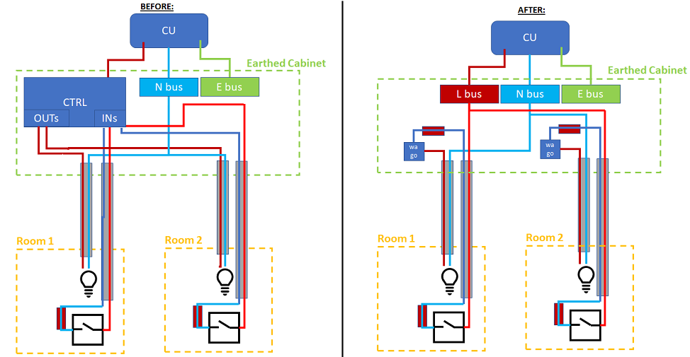

Alan Ambrose Posted January 17, 2023 Author Posted January 17, 2023 I don''t know if this helps any or just makes life more complicated - our 4-year old conversion was wired with 4-wire to the light switches, which seems pretty sensible. The extra wire was the N bus - this allows the standard mains set-up to be converted to mains powered wifi smart-switches. I have used this on a few occasions e.g. for outside lights. I was very grateful to find the N already there, rather than having to try to borrow it from somewhere else (which is, of course, dead dodgy). I appreciate that this is already 'old-tech'.
MortarThePoint Posted January 17, 2023 Posted January 17, 2023 16 minutes ago, Alan Ambrose said: I don''t know if this helps any or just makes life more complicated - our 4-year old conversion was wired with 4-wire to the light switches, which seems pretty sensible. The extra wire was the N bus - this allows the standard mains set-up to be converted to mains powered wifi smart-switches. I have used this on a few occasions e.g. for outside lights. I was very grateful to find the N already there, rather than having to try to borrow it from somewhere else (which is, of course, dead dodgy). I appreciate that this is already 'old-tech'. If going the more standard route, I had planned to do 3core&e between light and switch. You can now get smart switches that don't require Neutral (e.g. Sonoff). I guess they periodically charge a capacitor via the light at too low a current to light the bulb. May not work with all bulb types, I don't know.

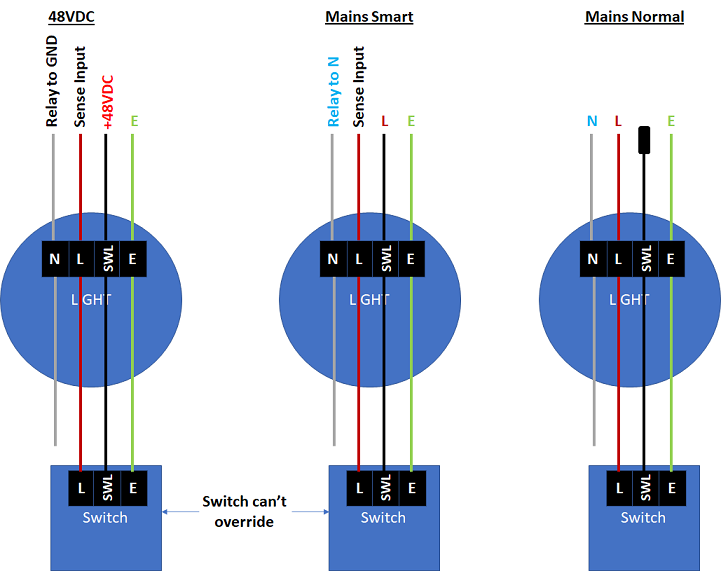

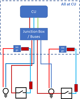

MortarThePoint Posted January 17, 2023 Posted January 17, 2023 Well here is a wiring strategy that falls back to a very standard approach by only rewiring back near the Consumer Unit. Nothing needs doing at the lights or the switches. The only thing that is weird about the "Mains Normal" end result is that it is a star circuit rather than a radial. That's because each light (or group) and switch is on a spur off a central set of bus bars. The Sense Input in the mains "Mains Smart" case is a bit tricky but could be done in a couple of easy ways: Relay switching e.g. 5V logic using a mains coil Mains optoisolator (e.g. Aliexpress, though that uses about 0.4W for the opto which is disappointing)
MortarThePoint Posted January 18, 2023 Posted January 18, 2023 (edited) 11 hours ago, MortarThePoint said: Well here is a wiring strategy that falls back to a very standard approach by only rewiring back near the Consumer Unit. Nothing needs doing at the lights or the switches. The only thing that is weird about the "Mains Normal" end result is that it is a star circuit rather than a radial. That's because each light (or group) and switch is on a spur off a central set of bus bars. The Sense Input in the mains "Mains Smart" case is a bit tricky but could be done in a couple of easy ways: Relay switching e.g. 5V logic using a mains coil Mains optoisolator (e.g. Aliexpress, though that uses about 0.4W for the opto which is disappointing) I'm concerned that the Mains Smart has Neutral side switching. Subject to confirmation, it looks to be allowed by BS7671 but still feels funny. It feels less safe than Line side switching as the light fitting will still have Line voltage present when changing a bulb with the light off, rather than in the normal situation when there would be Neutral present which is close to Earth potential. Edited January 18, 2023 by MortarThePoint
joth Posted January 18, 2023 Posted January 18, 2023 38 minutes ago, MortarThePoint said: I'm concerned that the Mains Smart has Neutral side switching. Subject to confirmation, it looks to be allowed by BS7671 but still feels funny. It feels less safe than Line side switching as the light fitting will still have Line voltage present when changing a bulb with the light off, rather than in the normal situation when there would be Neutral present which is close to Earth potential. Yeah totally agree neutral switching feels weird. I considered this just for some of the equipment inside my control cabinet: for efficiency it's nice to power down the DMX dimmer modules when not in use. They have a combined L terminal to power the dimmer and passthru to the lights being dimmed, but the N terminal is only required to power the module's internal logic (the light fitting's N line returns straight back to the RCBO, not via the dimmer module). So for simplicity it felt nice to just switch the N line on the dimmer module to power it down, as this way the switched load is only about 2W per dimmer, not the sum of all light fittings. I didn't do this in the end, even though the switched N line is purely internal to the cabinet and not out to the fitting. (In fact ultimately I replaced the cheap AlieExpress dimmers with Whitewing ones with much lower standby current per channel, and so now I just leave them permanently powered) (Full disclaimer: I haven't really followed the rest of your recent posts - it all seems technically possible but adds so practical overhead for something hopefully never needed, it is very far from the philosophy I followed I don't have much to add.) 1

MortarThePoint Posted January 18, 2023 Posted January 18, 2023 29 minutes ago, joth said: Yeah totally agree neutral switching feels weird. I considered this just for some of the equipment inside my control cabinet: for efficiency it's nice to power down the DMX dimmer modules when not in use. They have a combined L terminal to power the dimmer and passthru to the lights being dimmed, but the N terminal is only required to power the module's internal logic (the light fitting's N line returns straight back to the RCBO, not via the dimmer module). So for simplicity it felt nice to just switch the N line on the dimmer module to power it down, as this way the switched load is only about 2W per dimmer, not the sum of all light fittings. I didn't do this in the end, even though the switched N line is purely internal to the cabinet and not out to the fitting. (In fact ultimately I replaced the cheap AlieExpress dimmers with Whitewing ones with much lower standby current per channel, and so now I just leave them permanently powered) (Full disclaimer: I haven't really followed the rest of your recent posts - it all seems technically possible but adds so practical overhead for something hopefully never needed, it is very far from the philosophy I followed I don't have much to add.) It would be foolish anyway to work on an automated light setup only taking note of the wall switch and ignoring the fact that the automation could have turned the light on. The number bayonet is a much better solution that a threaded bulb for this sort of reason. The threaded section of such a bulb is Neutral.

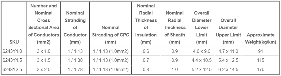

MortarThePoint Posted January 21, 2023 Posted January 21, 2023 Some useful dimensions for 3&e cable: https://www.expertelectrical.co.uk/6243y-cable#product-specs-dimensions
