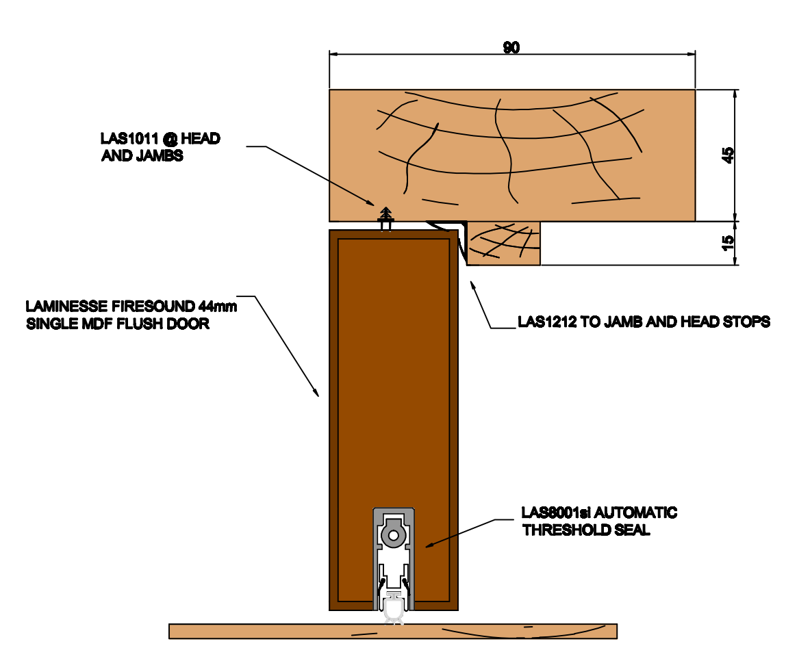

Moonshine Posted October 11, 2022 Share Posted October 11, 2022 (edited) This is all on the assumption that you aren't looking for crazy high levels of sound insulation. What is it you are trying to reduce the noise from? A standard solid core door (e.g. 44mm) will suffice, where you want to really pay attention to detail is the perimeter of the door at the jambs and threshold. Door jambs are fairly simple, its the threshold which is more tricky, and you will be looking for a threshold plate or a drop down seal Have a look at some of the solutions here https://www.lorientuk.com/acousticsearch/results?drawId=search-product Edited October 11, 2022 by Moonshine 1 Link to comment Share on other sites More sharing options...

Moonshine Posted October 11, 2022 Share Posted October 11, 2022 22 minutes ago, Adsibob said: I ordered a system that I think was lorient tech or similar from a company based in Enfield. Came to about £1100 without handles or locks. Not cheap, but worth it in my opinion as it really works well at isolating our utility room from the rest of the house. I would be interested to know the details on that and what the claimed Rw for the system is, that seems a lot a of money. The configuration below with two types of seals on the head and jambs, and drop down seal gives a tested performance with the 44mm fire door or Rw 39 dB, which is damn good for a door. The material cost of these seals is probably in the range of £50-70. Link to comment Share on other sites More sharing options...

Moonshine Posted October 11, 2022 Share Posted October 11, 2022 17 minutes ago, Adsibob said: Good luck getting those parts for that money. Yes, the seals on the two uprights and the top are just bits of rubber, but the drop down seal is more complex. I could only find the drop down seal as a standalone item for about £90 quid, and it was rather unsightly, as not integrated within the door. LAS8001si - £24 inc vat (https://www.noberneseals.com/product/lorient-las8001si-acoustic-threshold-seal/) LAS1212 (for all jambs) - £13 inc vat (https://www.noberneseals.com/product/lorient-las1212-batwing-seal/) LAS1011 (for all jambs) - £13 inc vat (https://www.noberneseals.com/product/lorient-las1011-firtree-seal-4mm-blade-las1011/) about £50 with some added on for delivery. The drop down seal is fitted by making a 36mm deep groove along the centre of the bottom of the door with a router, and drops with a push button onto the door lining when the door closes, hothing really that complex https://www.lorientuk.com/files/resources/LAS8001K-si-fitting-instructions.pdf 1 Link to comment Share on other sites More sharing options...
