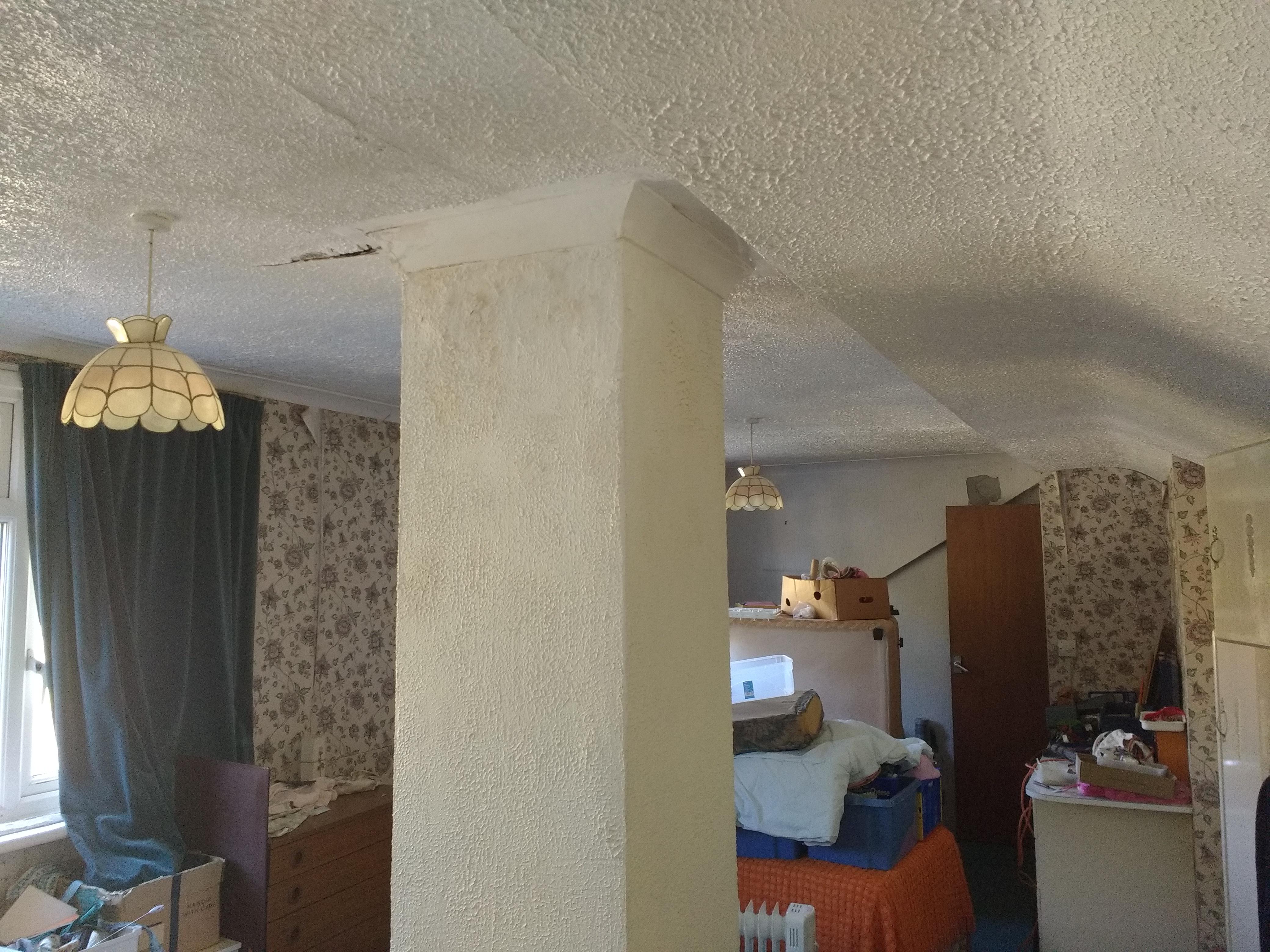

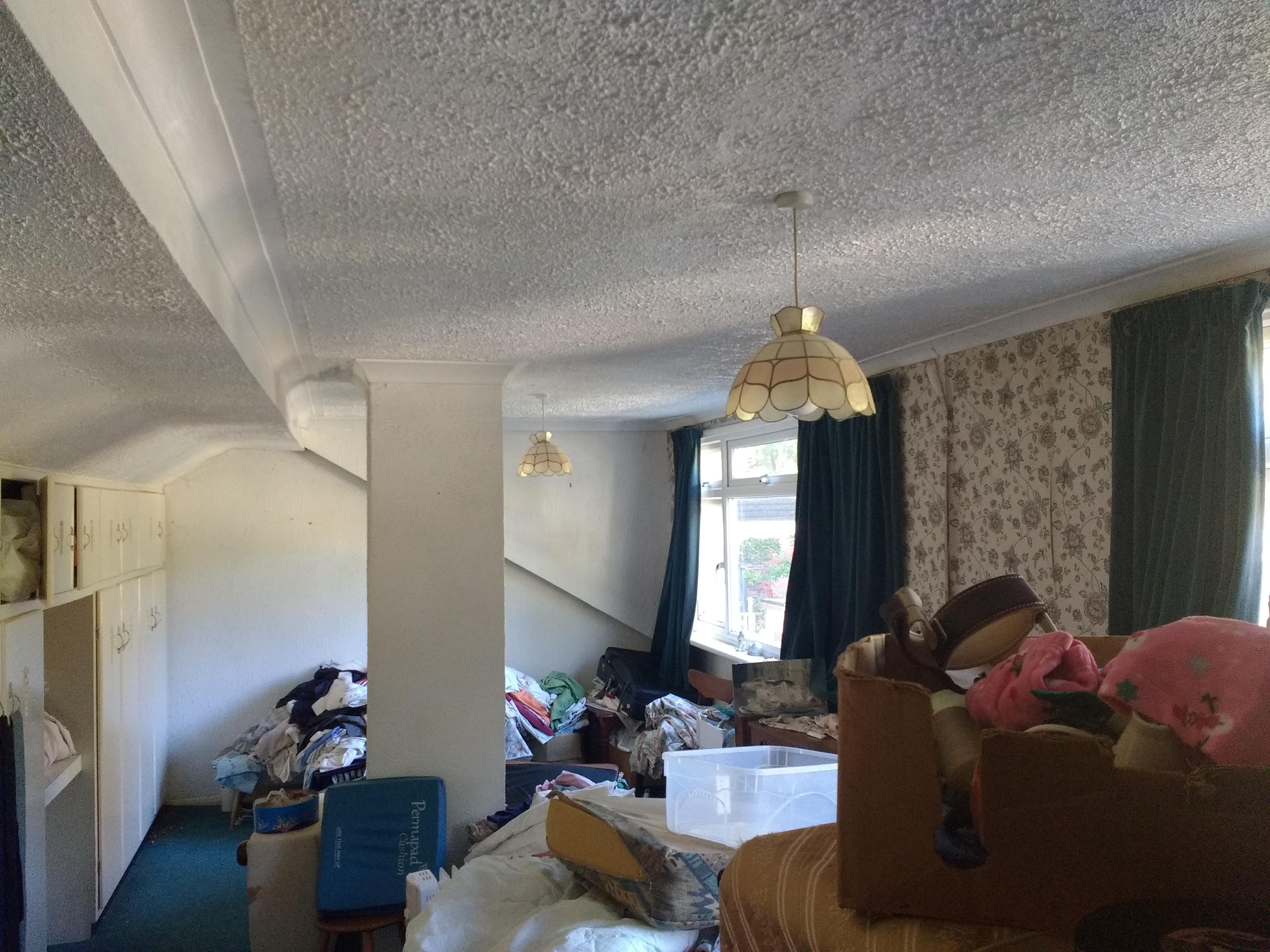

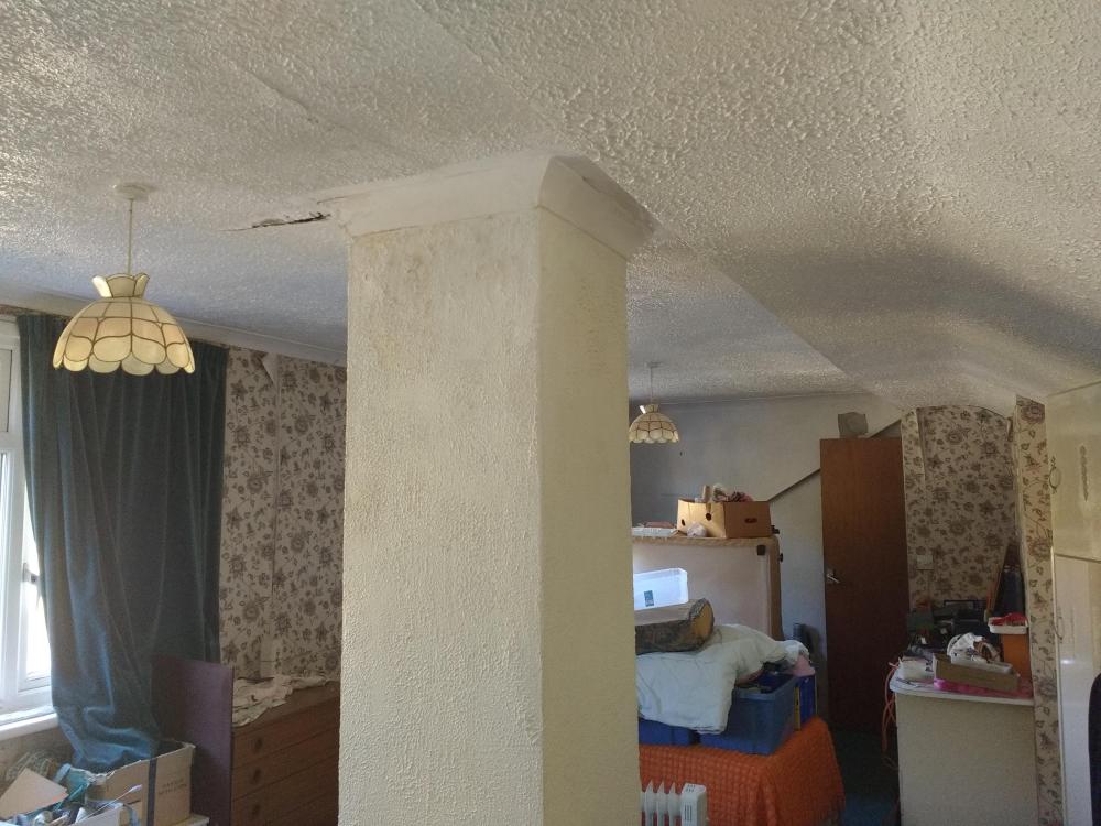

Onoff Posted October 9, 2022 Share Posted October 9, 2022 M&Ds bungalow. They had the upstairs dormer roof redone a while back but the Artexed ceiling inside had some old leak damage around the chimney stack that goes up through it. Brother has had a guy in who's quoted to remove the coving, board straight over the existing ceiling, re cove and paint. Area to be boarded is 2.3 X 6.9m. He's quoted £1750. Biggest issue I can see is you won't get 8'x4' sheets up the stairs and into the room. We have of course to clear everything out. Does that seem reasonable? Link to comment Share on other sites More sharing options...
Pocster Posted October 9, 2022 Share Posted October 9, 2022 Can’t you just get the artex skimmed ? 1 Link to comment Share on other sites More sharing options...
Mr Punter Posted October 9, 2022 Share Posted October 9, 2022 Skimming would save a load of hassle. 1 Link to comment Share on other sites More sharing options...
joe90 Posted October 9, 2022 Share Posted October 9, 2022 Nothing wrong with 6x3 sheets. Link to comment Share on other sites More sharing options...
nod Posted October 9, 2022 Share Posted October 9, 2022 Sounds reasonable Link to comment Share on other sites More sharing options...
Madasahatter Posted October 9, 2022 Share Posted October 9, 2022 Have you had the artex tested for asbestos? Link to comment Share on other sites More sharing options...
Pocster Posted October 9, 2022 Share Posted October 9, 2022 I’ve had artex skimmed in the past . Can’t believe we used to ‘ like ‘ it …. Be cheaper @Onoff ; as long as you don’t do it Link to comment Share on other sites More sharing options...
