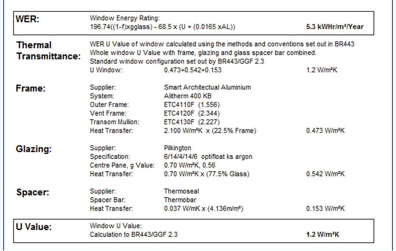

pstunt Posted October 5, 2022 Posted October 5, 2022 We have been let down so many times by windows suppliers we are losing the will to live. I am looking for views on this recent quote from a local installer to us, up in the North East. We have a lot of windows in our build and the attached screenshot is the worst performing U value of the different windows we have been quoted for. This is using one of the relatively newly updated Smart systems ( Alitherm 400 ) and on paper is delivering better U values to when I looked at them last year. I appreciate there are better performing products out there, and we do have a separate ongoing enquiry with a different supplier for a different product ( Mixture of Origin and Internorm ) but we are potentially talking many thousands of pounds difference in price. Given such a large price difference I am trying to reason why going down the Smart system would be wrong ?
JohnMo Posted October 5, 2022 Posted October 5, 2022 Pretty pants for triple glazing. Let down by the aluminium frame. You can get double glazed that performs as good or better if you are using krypton gas.
pstunt Posted October 5, 2022 Author Posted October 5, 2022 Thanks for the response. Do you feel that it’s the case of aluminium frames in general which lets it down or this particular frame ? I understand wood or Ali clad are always going to perform better. I am trying to get my head around why an overall U value of 1.2 is not great ? I get there is better out there but at what cost ? I am trying to weigh up going with “ok” windows with a sizeable cost saving against better performing windows. The consideration being that the possible additional energy expenditure is likely to be way less over the realistic lifetime of the windows.

Nick Laslett Posted October 5, 2022 Posted October 5, 2022 We went with Smart Alitherm Heritage for the Crittal style look. These frames couldn’t take a glass unit thicker than 28mm, so we had to have DGU. This gave us a U-value of 1.3. Smart were still using the older generation polyamide thermal break. Origin and SAS ( Senior Architectual Systems) have newer designs with polyurethane thermal break or Aerogel, these can get to 0.8 u-value. https://www.seniorarchitectural.co.uk/architectural-systems/pure-window/ https://origin-global.com/aluminium-windows/casement-windows https://www.aluminiumtradesupply.co.uk/43667/part-l-2021-how-it-affects-windows-and-doors/#more-43667

Andehh Posted October 26, 2022 Posted October 26, 2022 Just to correct my above point; the U value I quoted above was for the glass alone...due to the Ali frame it is more likely to be 1.5; Frame AND glass. Im pretty pissed off over this, as I didn't bother upgrading/seeking alternatives as asking the U Value of the windows & being told 1.3 meant I chalked it up as an easy win and never gave it a second though, had I known 1.5 I'd have sought better performance in one form or another, I do feel the Window supplier was misleading in quoting a half-truth!!!
