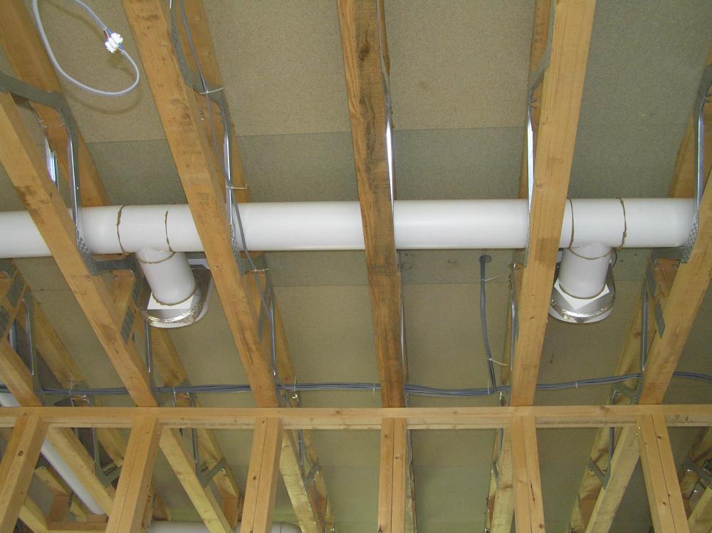

TimCx Posted October 4, 2022 Share Posted October 4, 2022 I have done some searching and not found a definitive answer hence this post. I am using 125mm rigid plastic ducting close to my new MVHR (replacement for a failed MVHR unit installed from 11 years ago). The joints on my the old rigid plastic duct are taped together with Aluminium tape but they have no sealant. People here mention using ducting sealant but this does not seem to be used everywhere. Furthermore I have seen 'Soudalduct' being used but that seems to be designed for use with metal ducting and makes no mention of being used with plastic, I have also seen 'Domus DDSEAL' mentioned and that is marketed as for use with plastic ducts but it mostly seems to be used by electricians. So my questions are: 1) Should I use a duct sealant with rigid plastic duct (in addition to the aluminium tape) ? 2) if yes then what duct sealant should I use. Thanks Link to comment Share on other sites More sharing options...
Triassic Posted October 4, 2022 Share Posted October 4, 2022 My rigid plastic duct is glued together using the same glue as the plastic waste pipe. 1 Link to comment Share on other sites More sharing options...
Gone West Posted October 4, 2022 Share Posted October 4, 2022 My rigid plastic duct was also glued together, and I only used aluminium tape as well on awkward fittings. 1 Link to comment Share on other sites More sharing options...

TonyT Posted October 4, 2022 Share Posted October 4, 2022 Solvent weld cement Link to comment Share on other sites More sharing options...

Gone West Posted October 5, 2022 Share Posted October 5, 2022 14 hours ago, TimCx said: Do you know what sort of glue was used? I used PU gel glue on my fittings as I wasn't sure that the plastic was suitable for solvent weld as it was more flexible than ABS type plastic. 1 Link to comment Share on other sites More sharing options...
jamieled Posted October 5, 2022 Share Posted October 5, 2022 I used duct sealant on the plastic fittings, think it was something like this: illbruck | LD410 Duct Sealant 1 Link to comment Share on other sites More sharing options...
Bonner Posted October 5, 2022 Share Posted October 5, 2022 I used cheap flexible frame sealant from Screwfix and duct tape. Link to comment Share on other sites More sharing options...
TimCx Posted October 7, 2022 Author Share Posted October 7, 2022 Thanks all, I have done a but more research and managed to speak to someone who has fitted this stuff before, his preference was Soudaduct. As the Soudal state that is for metal duct I phoned their technical help line to ask if its OK for plastic and they said yes its fine, so I think I will use that. Link to comment Share on other sites More sharing options...
