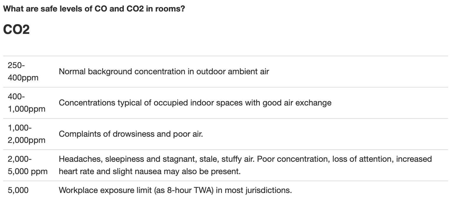

1163078155_Screenshot2022-09-30at18_39_01.thumb.jpg.74ec6fe55daf6f23c5155724db2b79f2.jpg
There's an app for that:
https://www.engineeringtoolbox.com/pollution-concentration-rooms-d_692.html

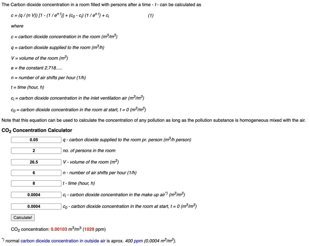

997483632_Screenshot2022-09-30at18_53_23.thumb.jpg.6f0c4d1643e110ae5decc99b92b5b48c.jpg
1271720445_Screenshot2022-09-30at18_55_00.thumb.jpg.64f13c658ca7bc6857e0ddd014738de9.jpg
1767067801_Screenshot2022-09-30at18_53_49.thumb.jpg.72f056ad58f8368e19ef042db47d50f2.jpg

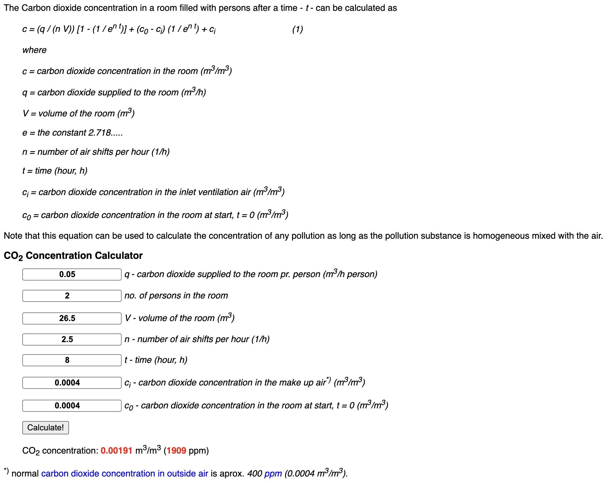

So we need 2.5 air changes per hour in the largest of the bedrooms to keep CO2 to 2000 ppm or 6 air changes per hour to keep it to 1000 ppm.
2.5 * 26.5 = ~65 m3/hr or ~1.1 m3/minute or 18 L/sec
6 * 26.5 = ~160 m3/hr or ~2.5 m3/minute or 45L/sec

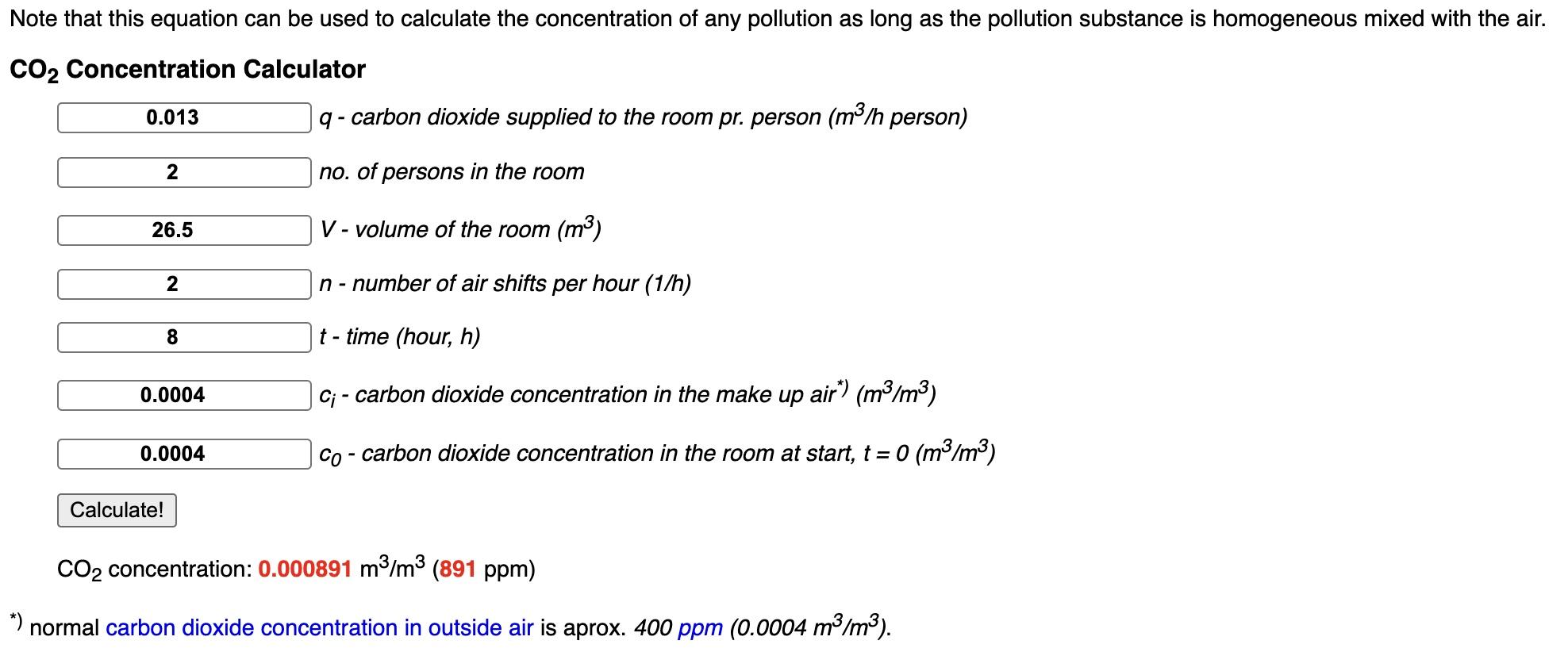

Sleeping...probably involves less CO2...so a ventilation rate that gives 2000 ppm for active duty would give 1000 ppm for sleeping duty.
There's a page for that too:
https://www.engineeringtoolbox.com/co2-persons-d_691.html

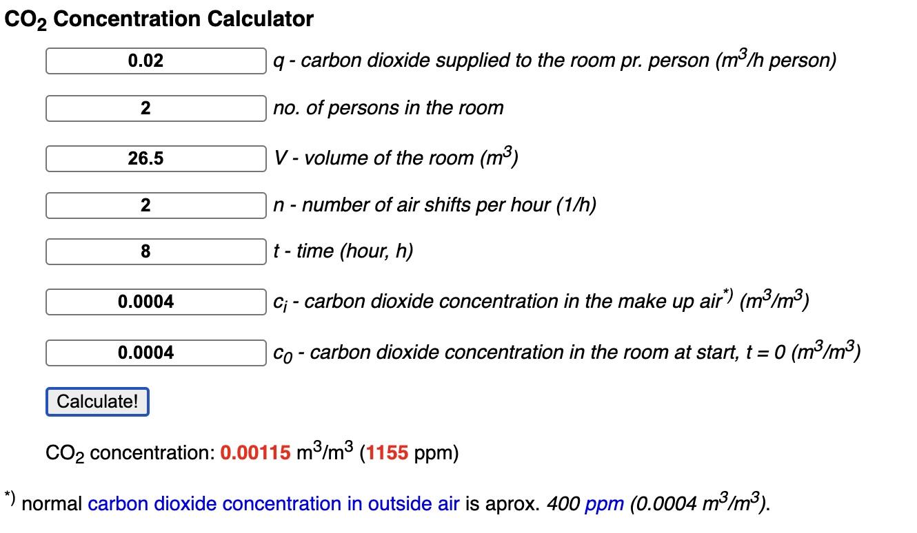

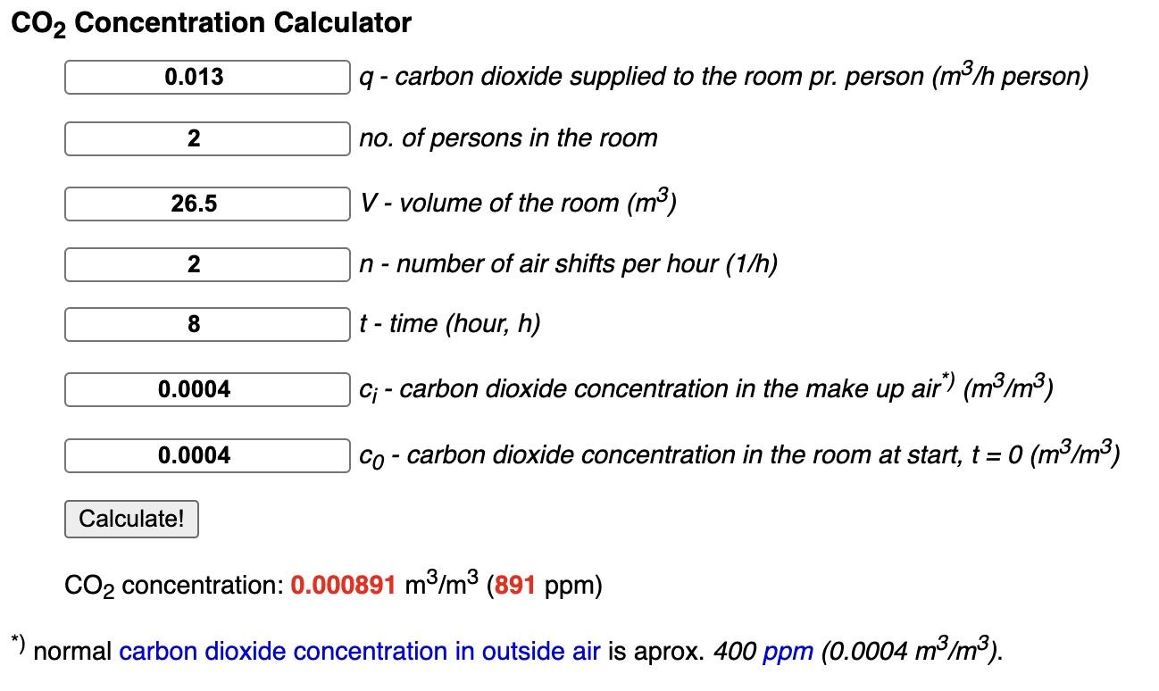

Sleeping should be 0.013 to 0.02 per person not 0.05 which gives about 2 ACH or 15 Litres/sec or 0.9 m3/min or 54 m3/hr per double bedroom:
1228257793_Screenshot2022-09-30at19_40_18.thumb.jpg.19c43bf57669700009dd1b61db80b52b.jpg
1183790772_Screenshot2022-09-30at19_39_36.thumb.jpg.f6ccd23e585221c6a0fc9b1db2f9351b.jpg

So likely needs to run at 40-50% overnight if serving just the upstairs bedrooms. (which it is)
In answer to the door grille: 15 litres/sec. One and a half paint buckets.
If door gap 0.8 metres wide and 0.01 metres tall area is 0.008 m2 so velocity for 0.015 m3/sec would be 2 m/sec or so. Breezy! Is my maths right here? Top and sides leaking a bit (depending on how badly the door fits) will add a fair bit more as length is longer.
2 cm door undercut brings that to 1 m/sec Or you trick of leaving off the top door stop bead and having 1 below / 1 above. Assuming forced fresh air input to drive that air change.

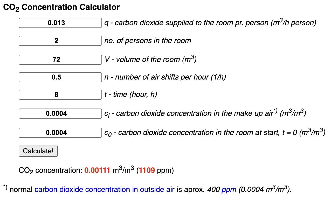

0.5 ACH works fine for out LT apartment: (double bedroom 6 x 4 x 3 metres = 72 m3)
1224706917_Screenshot2022-09-30at20_32_42.thumb.jpg.b2720ab873edb1047899f66945278555.jpg
That's the equivalent of 1.35 ACH in a 26.5 m3 room AND you've got that much more volume to dilute into over the 8 hour period.
