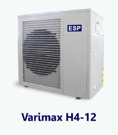

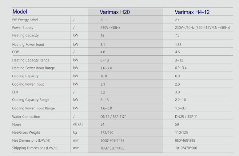

Hi All
Does anyone have any expedience of this particular model ASHP? Its sold by Earth Save Products (ESP) but I assume it will simply be a re-badged unit from someone.
Price and performance seems to stack up but I'm a bit wary of paying good  money for a product which would only be warranted by a small company. At least with Samsung, Mitsubishi et all you've got some reassurance of warranty cover.
http://www.earthsaveproducts.com/product/varimax-4-12-inverter/
https://www.greenworks.co.uk/wp-content/uploads/2016/12/Varimax-Brochure-V4.pdf

It's almost certainly Chinese, or been made from mainly Chinese sub-assemblies, I suspect, so getting hard info from anywhere other than ESP may well be difficult.  I've found that searching around on the Chinese sales sites, like Aliexpress, for images of units will often show whether something may originate from China, as there often seem to be a large number of different outlets for the same looking product.
The control board is made by Carel Electronic (Suzhou) Co Ltd, in Suzhou, China, for example, which is a good clue.
It may well be fine, but I suspect you'd be relying on a single source of support, spares etc, as support from the Chinese OEM may well be challenging.

Thanks that confirms what I expected. Not having a main brand warranty for service and parts is a big turn off for me.
It would be for me, too.  I did take a risk when buying our Glowworm ASHP, because Glowworm seemed to have pulled out of the market, but the price was good and I looked upon it as an acceptable risk, thinking that a well-established company like Glowworm would almost certainly be able to provide legacy product support.
As it turned out, the risk was justified, as the unit is really just a badge-engineered Carrier, and Carrier are the inventors of these things, have been in business for a century or so, and still make the same base model, so spares are not going to be a problem for the foreseeable future, I think.

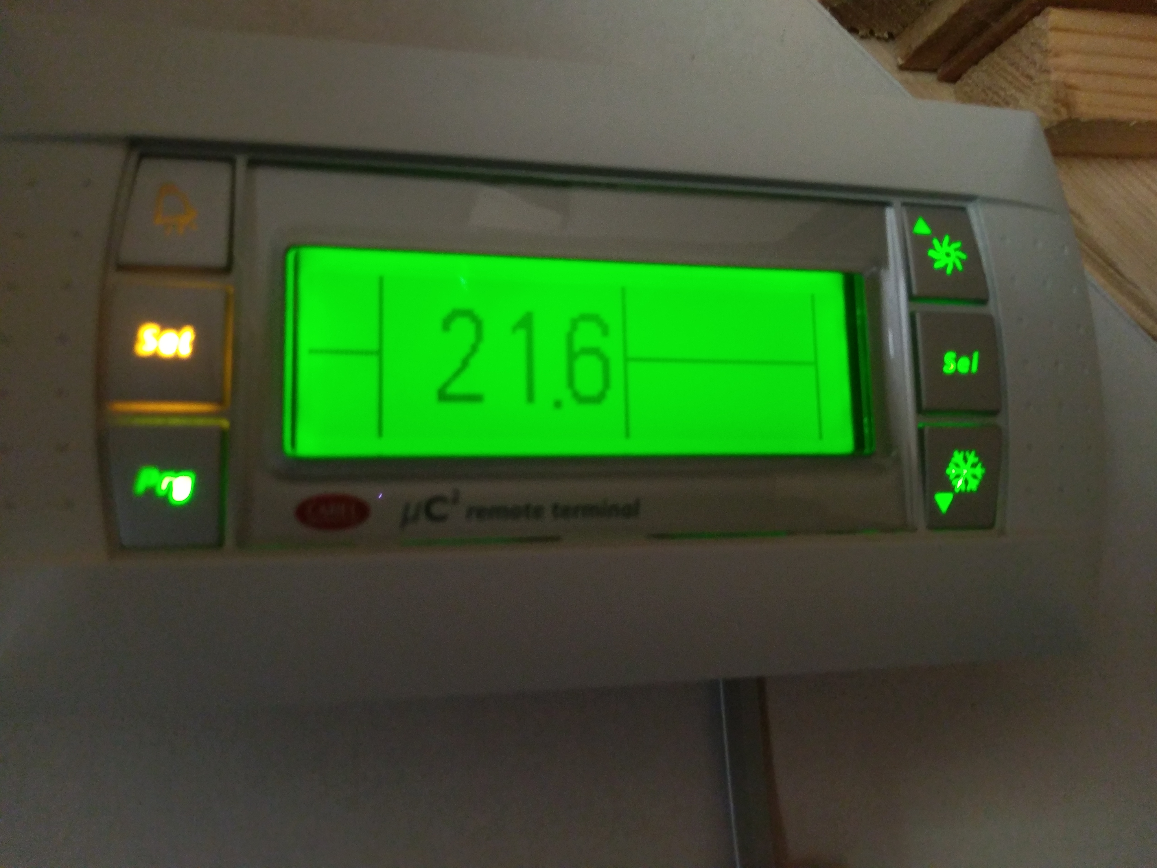

There is an advantage with companies like Earthsave. They do not lock down their software or hide features. You have access to all the settings in the controller and they are more than happy to talk you through any set-up issues individual to your installation.
My Carel controller has one button to switch it to cooling mode. I do have to agree their installation manuals are a bit Chinglish. (is that how you spell it)
I'd partially disagree with that !!
The reason that a lot of manufacturers lock out admin functions is that they use the same systems in multiple regions - for example, the defrost and temp curve for Scandinavia will be different to that for Japan. If you let a customer "play" with the settings then you can potentially cause an issue with the system that could result in a warranty claim.
This is even more important where a system is being used for RHI payments as if you lock out the ability for cooling for example which is not part of the RHI, you then also void the RHI agreement.
On the whole I would say less than 0.01% of consumers fully understand the functions of their own boiler controls, let alone the detailed settings !! You wouldn't access the admin settings on a gas boiler, so why would you want to on an ASHP..?

Fully agree Peter. I am in that group so my pump is as set by Earthsave when it was commissioned
However i think most of us on here are looking to use ASHP to cool and need that access unless its simple such as mine. long press switches to cooling mode
