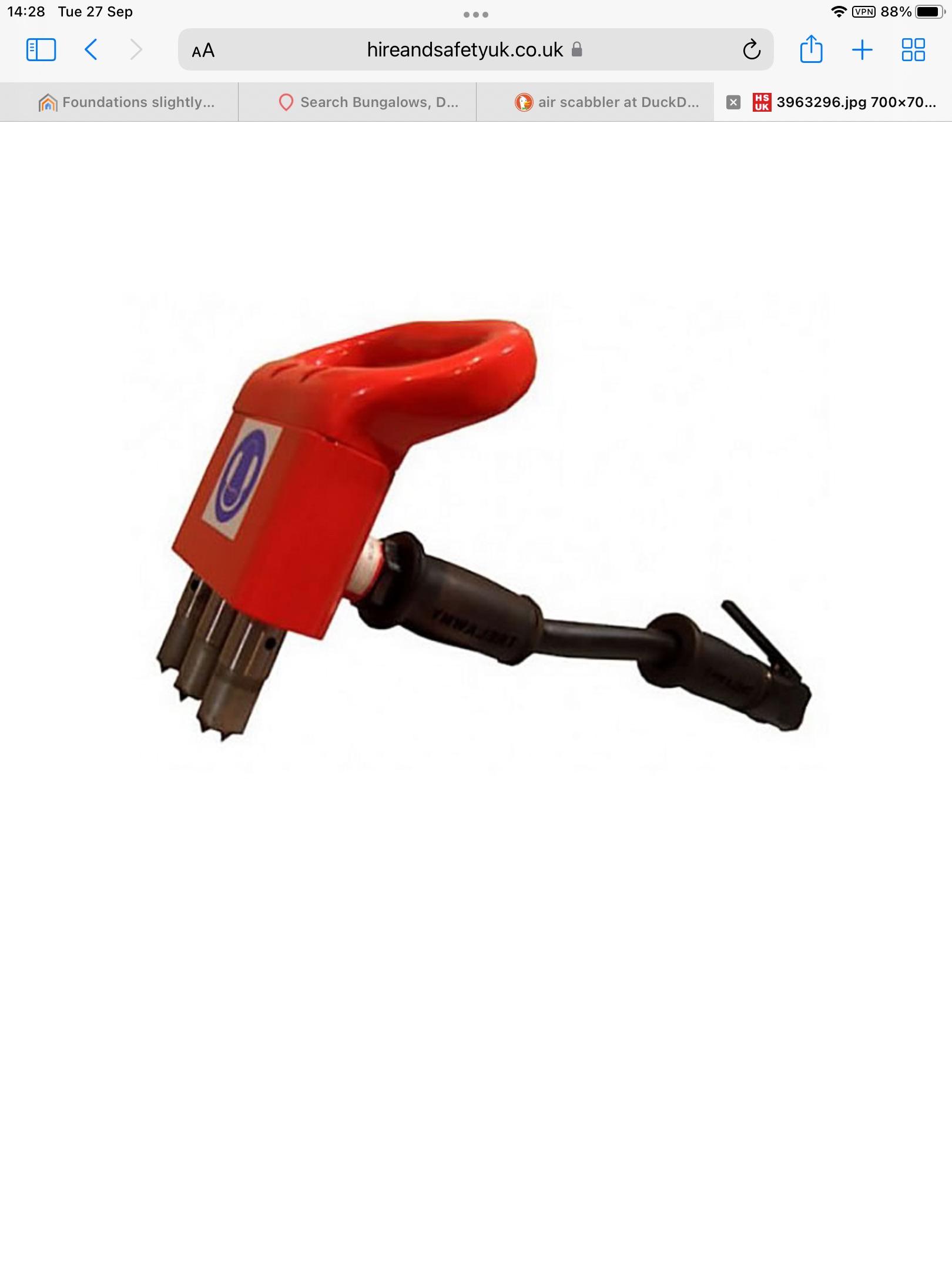

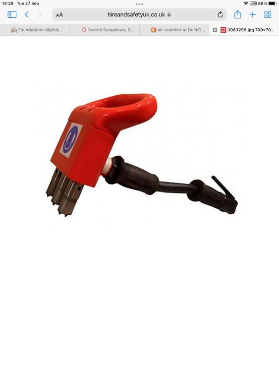

I have just spoke to my SE and he is happy with a 300mm footing next the ‘cock up’ one. He said I will need to expose the side of the foundation (1m deep) and scabble it to expose the aggregate.
do people think 300mm is wide enough for me to get in and get to it to expose it or would be better to do a 450mm bucket for excess?
Link to comment
Share on other sites
1 hour ago, markc said:
450mm isn’t enough for a straight scabbler  anyway so might as well go for 300 and use right angle scabbler
Thank you, I have googled it but not sure exactly what to use
Could you recommend any tool to use to do this?
Thanks again
