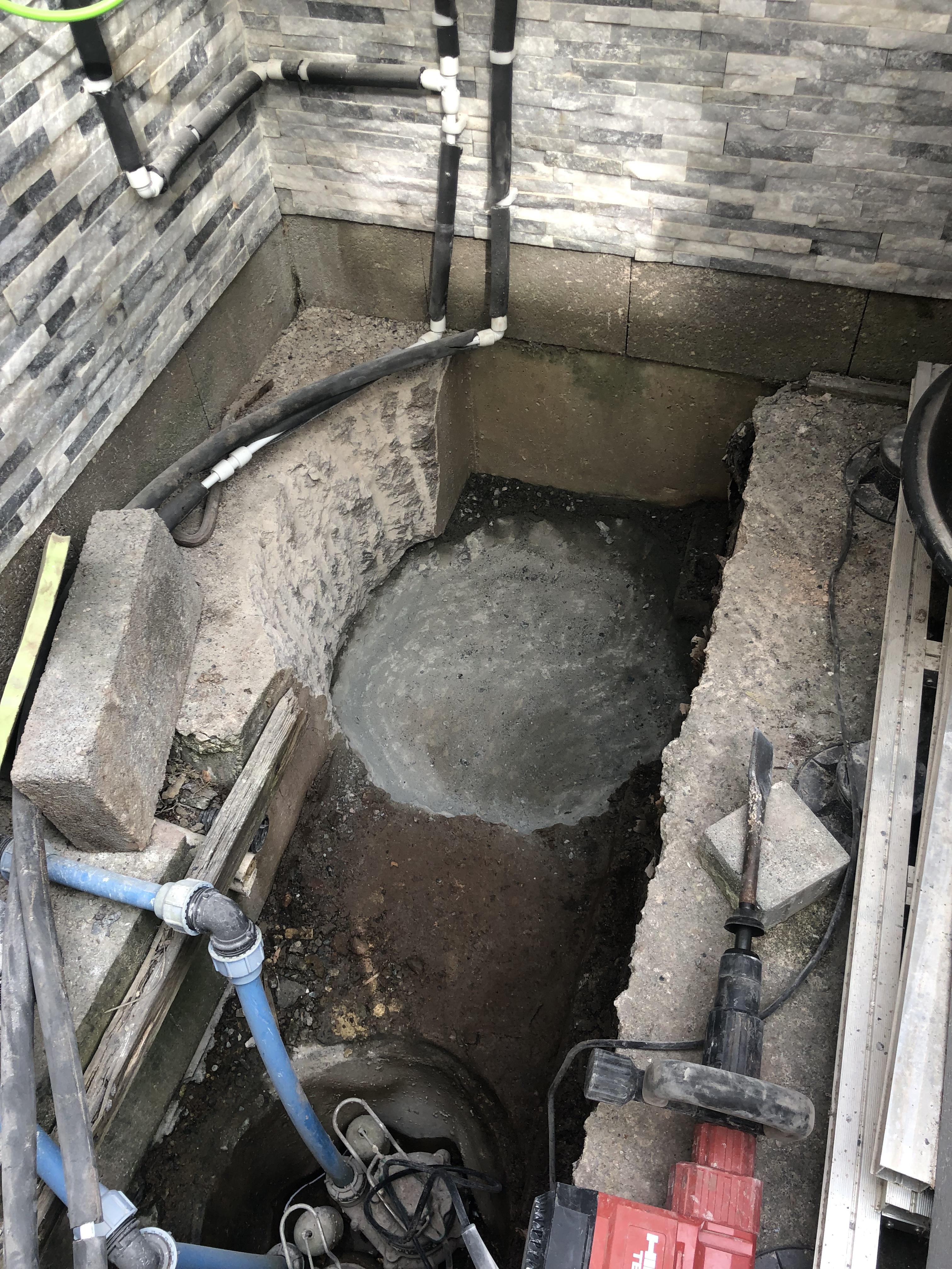

Pocster Posted September 22, 2022 Posted September 22, 2022 Deep in the bowels of the earth I break out concrete so I can get a sump in . There’s no way I can get the base ‘smooth ‘ . How best to bed the sump so no sharp bits puncture it ? . Dry sand and cement mix ? - then gently allow water to soak in around the base ? Better method ? Keen eyed amongst you will notice that this job was too much for the black and gold team ( Dewalt ) so we called in the Hilti boy . Appreciate Makita users won’t be familiar with that and need to go back to their cocktail at the Pink Flamingo nightclub .
TonyT Posted September 22, 2022 Posted September 22, 2022 Put a gorilla tub in the hole. drill some holes in the tub , drop pump into gorilla tub. sorted
Pocster Posted September 22, 2022 Author Posted September 22, 2022 3 minutes ago, TonyT said: Put a gorilla tub in the hole. drill some holes in the tub , drop pump into gorilla tub. sorted Would that really do ? . Still need to ‘bed’ gorilla tub . Currently sump tub can ‘wobble ‘ around as base isn’t flat .
TonyT Posted September 22, 2022 Posted September 22, 2022 I have one down a hole with a 450 mm duct on top keeping a concrete slab dry, so works for me. been in 1 year.. in sure there will be bespoke solutions but I just needed a fix to the problem
Pocster Posted September 22, 2022 Author Posted September 22, 2022 (edited) 54 minutes ago, TonyT said: I have one down a hole with a 450 mm duct on top keeping a concrete slab dry, so works for me. been in 1 year.. in sure there will be bespoke solutions but I just needed a fix to the problem The sump lid can be walked on so must be stable .,,. Edited September 22, 2022 by pocster

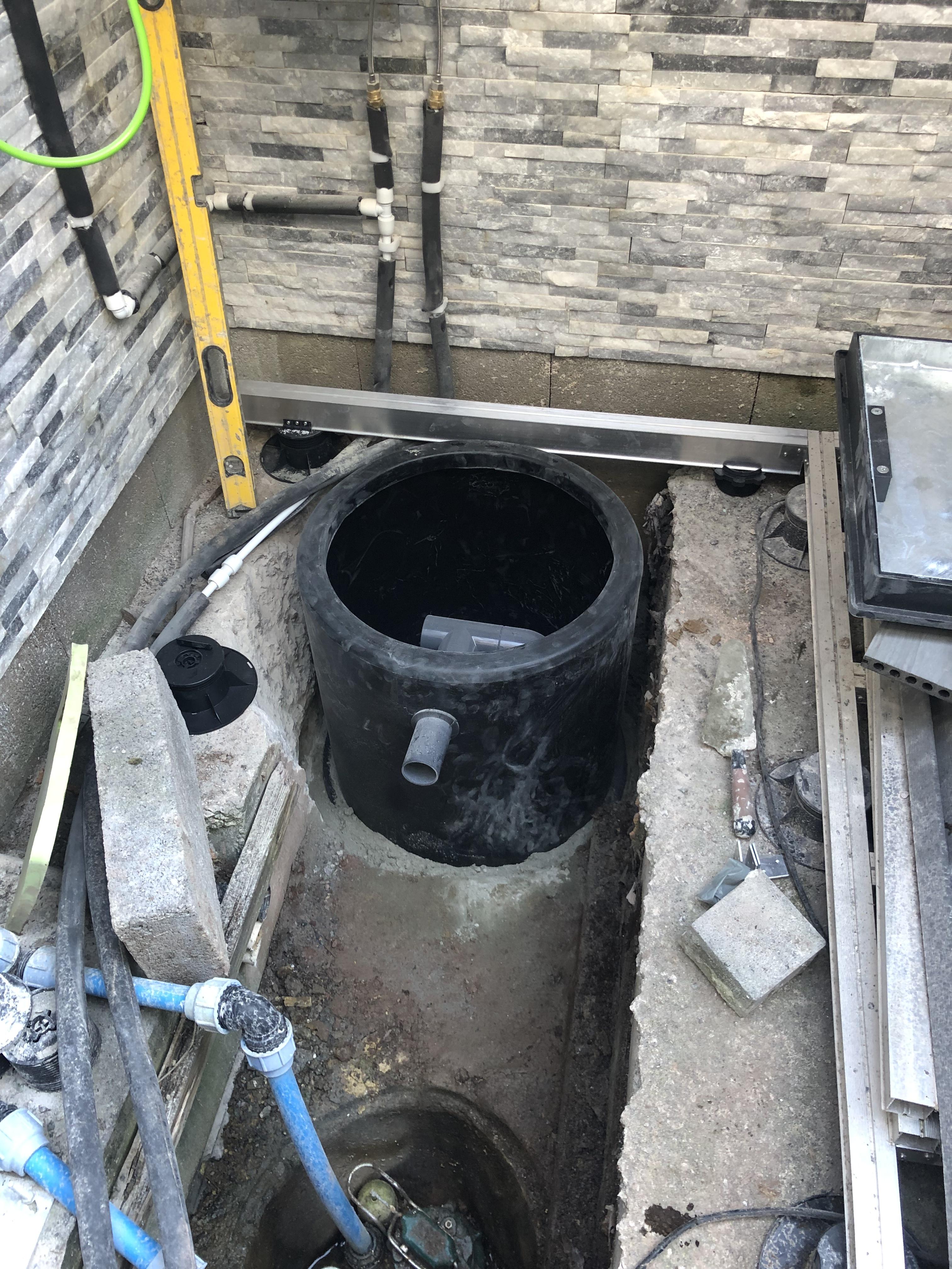

TonyT Posted September 23, 2022 Posted September 23, 2022 Bed it in a mortar mix, back fill with similar mortar/concrete

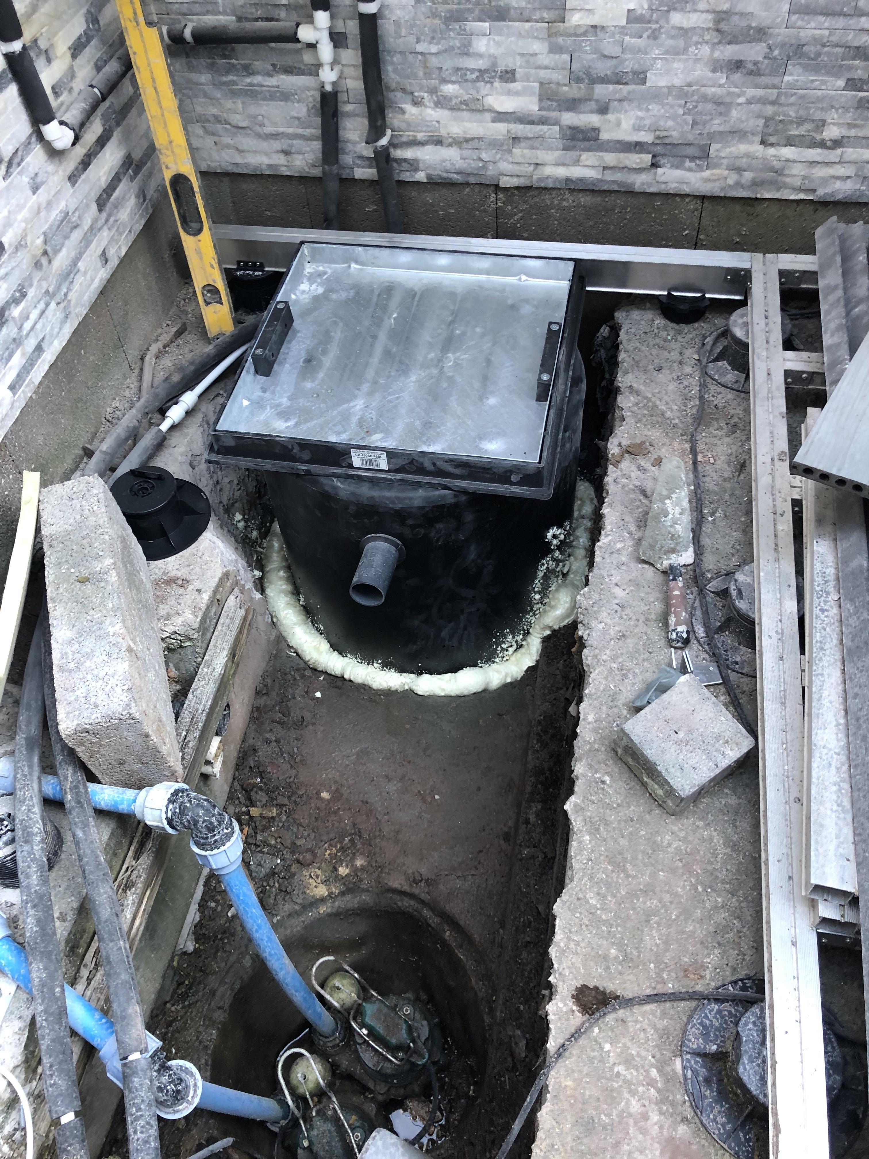

Pocster Posted September 23, 2022 Author Posted September 23, 2022 So I decided to do a sand/ cement mix at the base of the depression ( hole in the ground not my mental state ) . Seems fairly stable and level . Will water can around it now . As fear of it moving and poo pipe breaking I’ll even expanding foam the sides for peace of mind .
Pocster Posted September 23, 2022 Author Posted September 23, 2022 The (expletive deleted)er doesn’t move now
