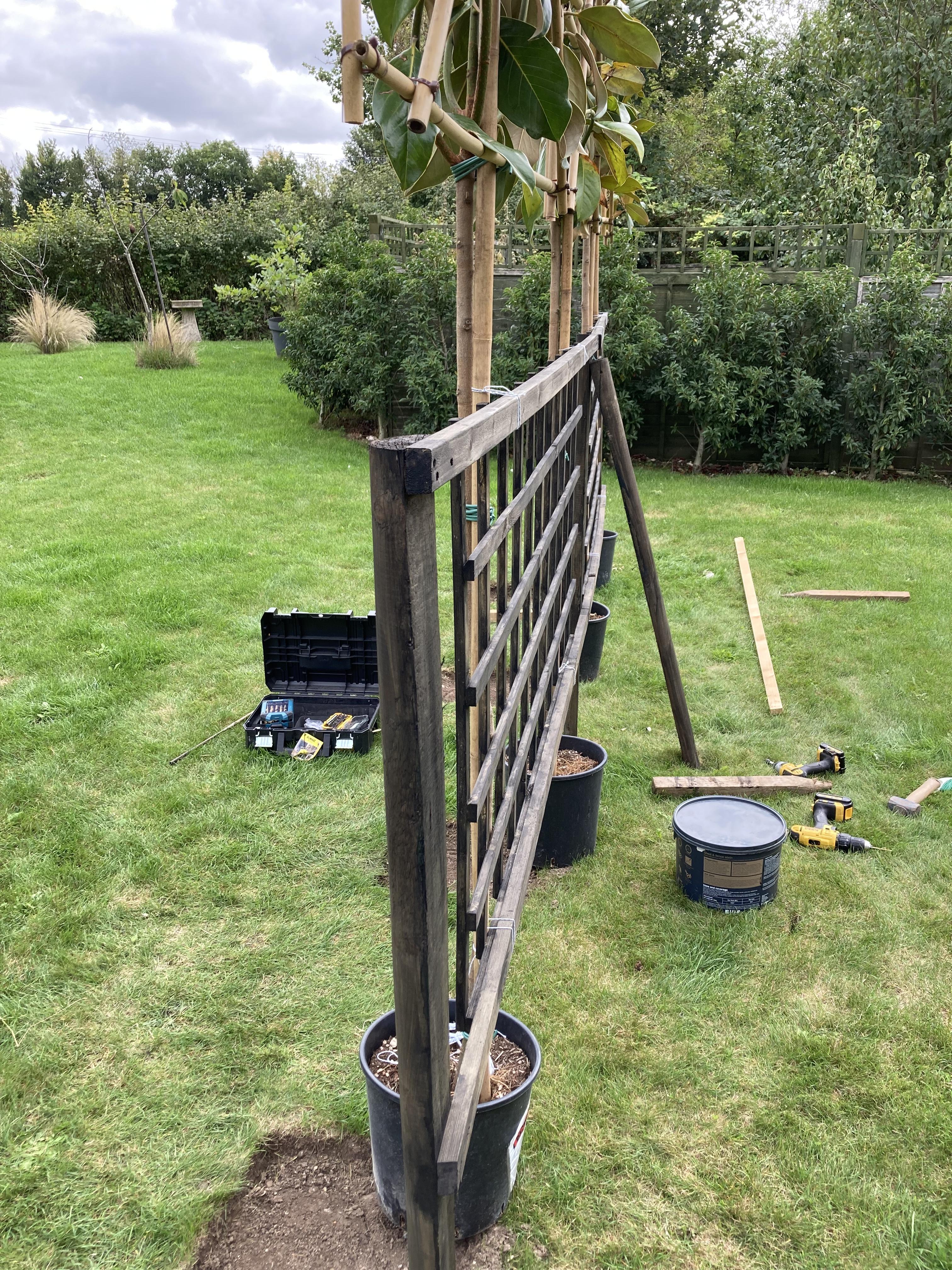

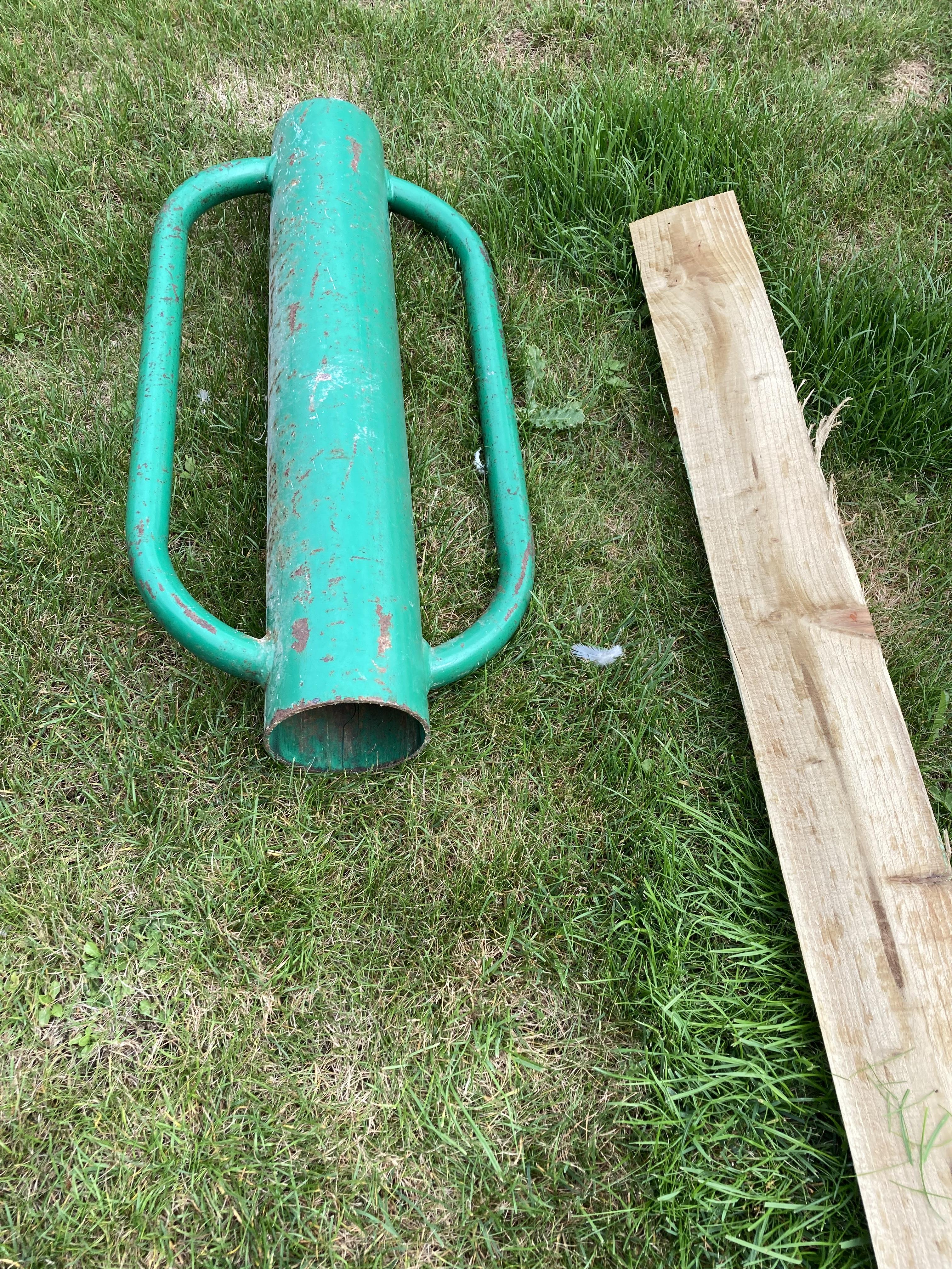

Russdl Posted September 15, 2022 Share Posted September 15, 2022 …when whacking them in to the ground? I needed three half round post in a straight line but as soon as I started knocking them in they do their own thing regarding the line. I guess it’s stones in the ground that dictate where the post will go. Also the posts rotate slightly as they get deeper, maybe stones again. Is there a secret way to get the posts to go in straight and stay aligned with one another and not rotate? Link to comment Share on other sites More sharing options...
markc Posted September 15, 2022 Share Posted September 15, 2022 Only way is a couple of battens across the two with a single screw so they can rotate and knock in sequentially 1 Link to comment Share on other sites More sharing options...
Russell griffiths Posted September 15, 2022 Share Posted September 15, 2022 Pilot hole with a large breaker bar. Pound it in to full depth and wiggle it. 1 Link to comment Share on other sites More sharing options...
Russdl Posted September 15, 2022 Author Share Posted September 15, 2022 Thanks both. I think I’ll use a combination of the two methods so that hopefully my next three half rounds will be in a dead straight line (anything else is not acceptable!) Link to comment Share on other sites More sharing options...
JohnMo Posted September 16, 2022 Share Posted September 16, 2022 Postcrete, set up everything as you need it before postcreting in. 1 Link to comment Share on other sites More sharing options...
