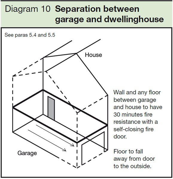

5.4  If a domestic garage is attached to (or forms an integral part of) a dwellinghouse, the garage should be separated from the rest of the dwellinghouse, as shown in Diagram 10.
5.5  Where a door is provided between a dwellinghouse and the garage, the floor of the garage should be laid to fall to allow fuel spills to flow away from the door to the outside.  Alternatively, the door opening should be positioned at least 100mm above garage level.

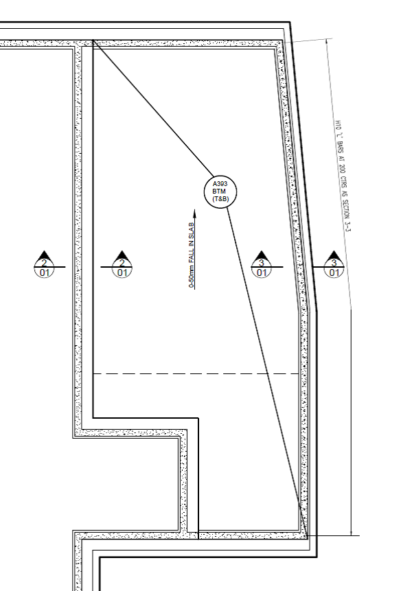

@Russell griffiths, you either have to have a step between the house and garage or slope to the outside garage door, this is what we have done:
This has been accepted by building control.
