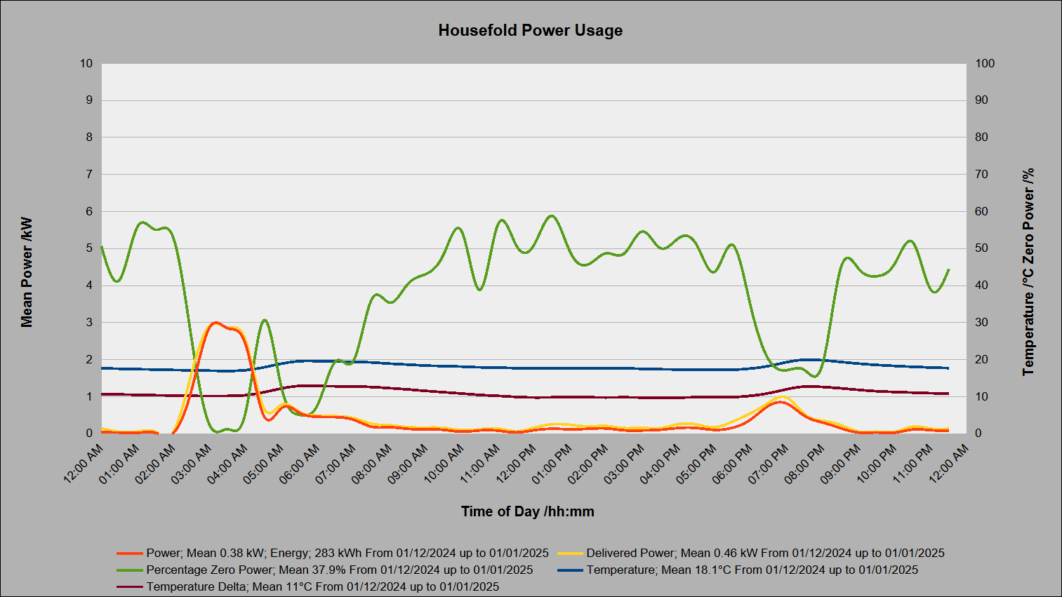

DamonHD Posted December 20, 2024 Author Share Posted December 20, 2024 (edited) Our overall electricity demand curve this month up to yesterday shows some successful load shifting for DHW at least: https://www.earth.org.uk/heat-pump-16WW-control.html#2024-12-20 Load profile over 2020-12-01 to 2020-12-19 inclusive, gross and net/imported. DHW consumption spikes starting at 07:40 and 19:10 are clearly visible. Edited December 20, 2024 by DamonHD Link to comment Share on other sites More sharing options...
DamonHD Posted January 1 Author Share Posted January 1 Whoops, I borked that image by moving it and I can't edit my post. Here's a newer and betterer one for the whole of December: Link to comment Share on other sites More sharing options...

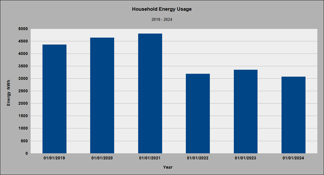

SteamyTea Posted January 1 Share Posted January 1 33 minutes ago, DamonHD said: newer and betterer one for the whole of December: Right, in the best 4 Yorkshiremen manner. Ere is my December. 1 Link to comment Share on other sites More sharing options...
SteamyTea Posted January 1 Share Posted January 1 This is my favourite chart at the moment. The big drop 3 years ago was the secondary glazing I added to my double glazing, making it triple glazed. Getting harder to use less now. There is a load of PU foam boards at work which I intend to have away to add to my loft insulation. 2 Link to comment Share on other sites More sharing options...

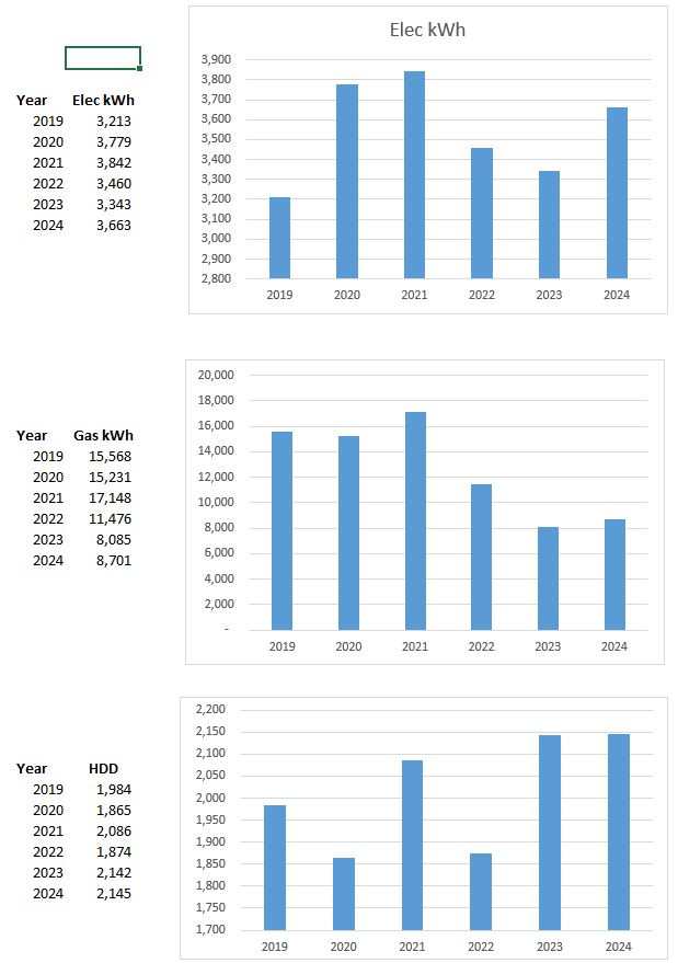

marshian Posted January 2 Share Posted January 2 18 hours ago, SteamyTea said: This is my favourite chart at the moment. The big drop 3 years ago was the secondary glazing I added to my double glazing, making it triple glazed. Getting harder to use less now. There is a load of PU foam boards at work which I intend to have away to add to my loft insulation. Nice work Here's my favorite From top to bottom Elec kWh for 2019 to 2024 Gas kWh for 2019 to 2024 HDD data for 2019 to 2024 Bloody labels disappeared for some reason!! Yes 2024 is an increase on both elec and gas but electric was driven by my hobby (welding takes a fair chunk of electrickery) and Gas is a result of going 24/7 this heating season. Data For a 113 m2 (290 m3) 4 bed 2 storey detached house with 2 occupants (one of which makes a lot of noise if it's cold) Oh and just to say when we moved into the house in 1991 we were using 25,000 kWh of gas a year - but the house had single glazing throughout the house, 25mm of loft insulation, no jacket on the uninsulated copper HWC and a non condensing glow worm boiler from 1982 that needed to run at 80 deg on the flow temp all winter to allow the 10 undersized T11 rads to be able to get the house warm.......... Now I'm running 30 deg flow temps at Zero outside!!!!! 1 Link to comment Share on other sites More sharing options...
SteamyTea Posted January 2 Share Posted January 2 2 hours ago, marshian said: when we moved into the house in 1991 we were using 25,000 kWh of gas a year When I moved in 20 years ago, I was using around 11,000 kWh/year. Been slowly reducing it most years, even when I had a lodger (once trained) my usage did not increase too much. What base temperature did you use for your HDDs? Link to comment Share on other sites More sharing options...
