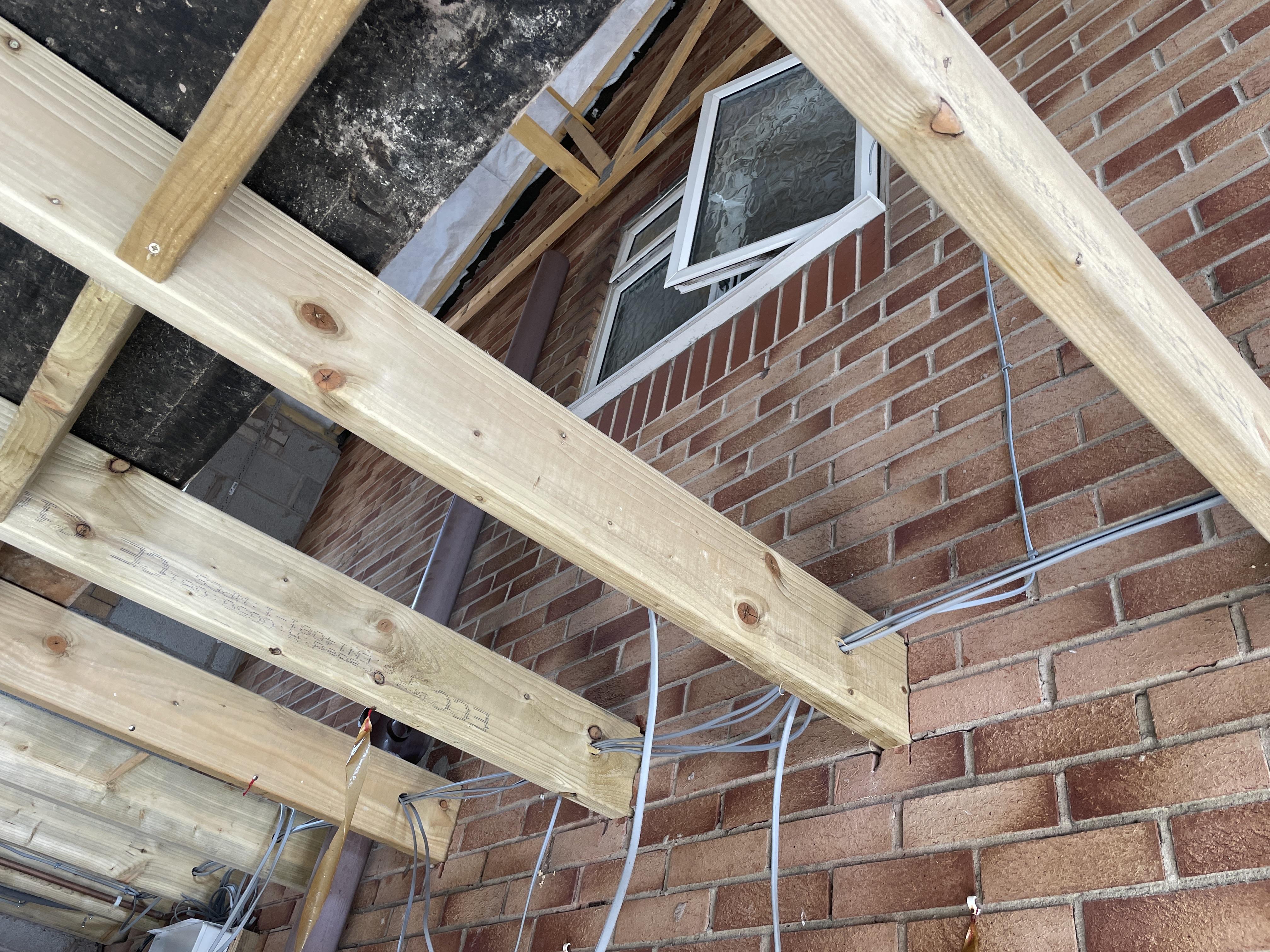

Paul Alan Posted September 7, 2022 Share Posted September 7, 2022 Hi we’re extending 2 story to side and one across the back. we’ve had walls and roofs done, boiler moved and first fix electrical done and windows in we need to knock through old bathroom to put new into new part of house and partition plaster etc etc but not sure what needs to be done first? we obviously don’t have money to pay a builder to manage it for us we’re just doing what we can ourselves and getting people in where we can. is there some type of consultants we can pay to come and have a look for us and put us on the right track? many thanks Link to comment Share on other sites More sharing options...

Paul Alan Posted September 7, 2022 Author Share Posted September 7, 2022 16 minutes ago, nod said: Knock through Put your partitions up Get plumber back Then Electrian When both of these two are happy Get your plasterer back to board out and skim and fit any tiles We need to remove the bathroom to knock through as that’s in the way through to new part. I need to at least have the toilet and sink in the new bathroom before knock through. I also need to re route the soil pipe before I can install the new toilet. it’s probably easy if you know how but it’s not something I’ve done before. I’ll post a pic of new side part the window you see is the old bathroom Link to comment Share on other sites More sharing options...

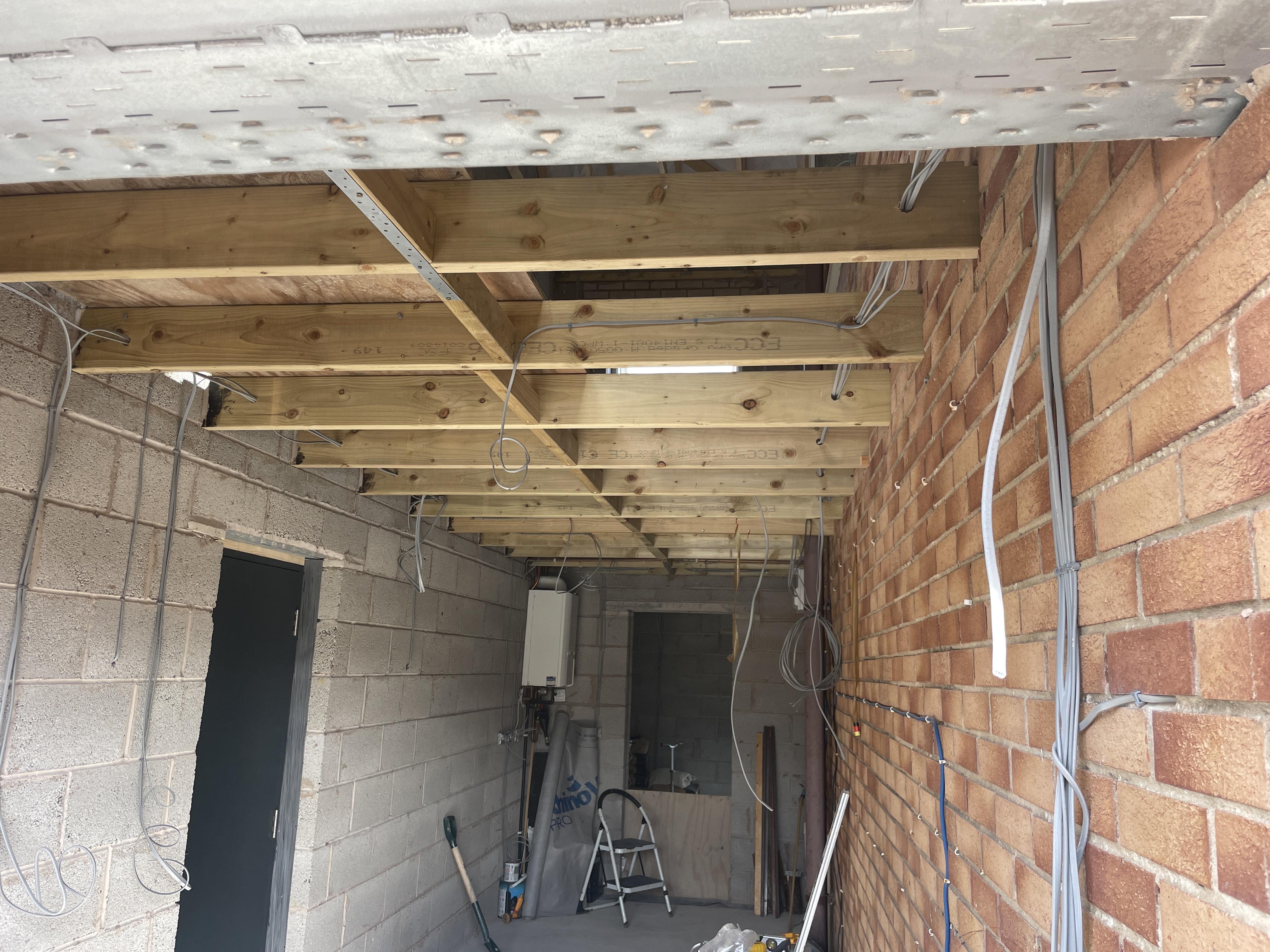

Paul Alan Posted September 7, 2022 Author Share Posted September 7, 2022 I can’t work out what to do next, the bricklayer we employed is coming to do the knock through but I’m not sure when that’s being done in relation to everything else. I want to put the plumbing roughly in place and then floorboards up stairs so I can start laying out for the bathroom with a view to getting some things in place. after that I’m not sure where to go with it all. the awkward part is having to remove the old bathroom in order to proceed with new one. I’ll have to disconnect the soil pipe and re route it before I can connect the new one and I imagine it will take me a while to do Link to comment Share on other sites More sharing options...
Mr Punter Posted September 7, 2022 Share Posted September 7, 2022 It looks like you are making decent progress. You could get Building Control to visist just to confirm that they are happy to date. Can you get the whole thing watertight? Very neat housing of joists into the wall btw. Link to comment Share on other sites More sharing options...
Paul Alan Posted September 7, 2022 Author Share Posted September 7, 2022 9 minutes ago, Mr Punter said: It looks like you are making decent progress. You could get Building Control to visist just to confirm that they are happy to date. Can you get the whole thing watertight? Very neat housing of joists into the wall btw. Building control are not being helpful in the slightest, I emailed them for guidance on fitting a fire rated door myself and they ignored me,3 phone calls all ignored. They dont like having to deal with me instead of a builder, I have lots of questions and I think theyre too busy to answer. I fitted the door and will be very unhappy if they tell me its wrong as I asked for theyre guidance but was not responded to. They are due next for pre-plaster inspection. We need a garage door then were watertight, the guy took the £500 deposit and has dissapeared. I do need to move the soil pipe first though as its venting inside the upstairs, we have the windows open full time for now but its not ideal I know. I need to dissconnect the current toilet etc from the soil pipe before I can re-route it to the outside wall. Link to comment Share on other sites More sharing options...
