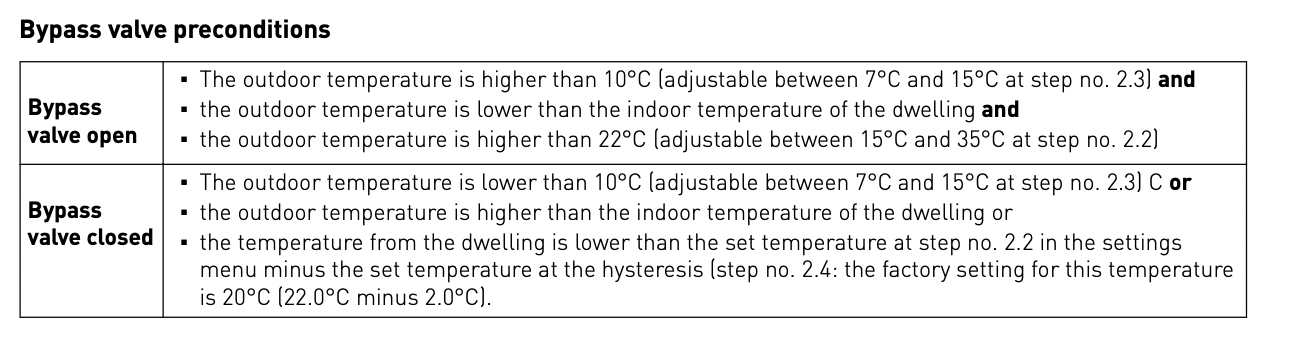

Dreadnaught Posted September 6, 2022 Share Posted September 6, 2022 On the subject of summer bypass, here are the rules for my Brink unit. I think most units work similarly. Link to comment Share on other sites More sharing options...
Blooda Posted September 7, 2022 Share Posted September 7, 2022 Looks like a Sentinel Kinetic plus [but check out the model before ordering filters], same as ours. First thing, as others say, Change the filters, they will be clogged up, you've been in there some months, and if previous owner did not change them, a hoover out will not be sufficient. Filtermate.co.uk will supply them [other companies are available :)] about £20 per pair. You tube video here on changing on a similar unit. How to replace the filters on a Vent-Axia MVHR unit - Sentinel Kinetic - YouTube A bit on summer bypass here. Vent Axia Sentinel Kinetic - summer bypass info (greenbuildingforum.co.uk) Might want to sort out a working platform around it as well, something the Builder / Installer should have done, Link to comment Share on other sites More sharing options...

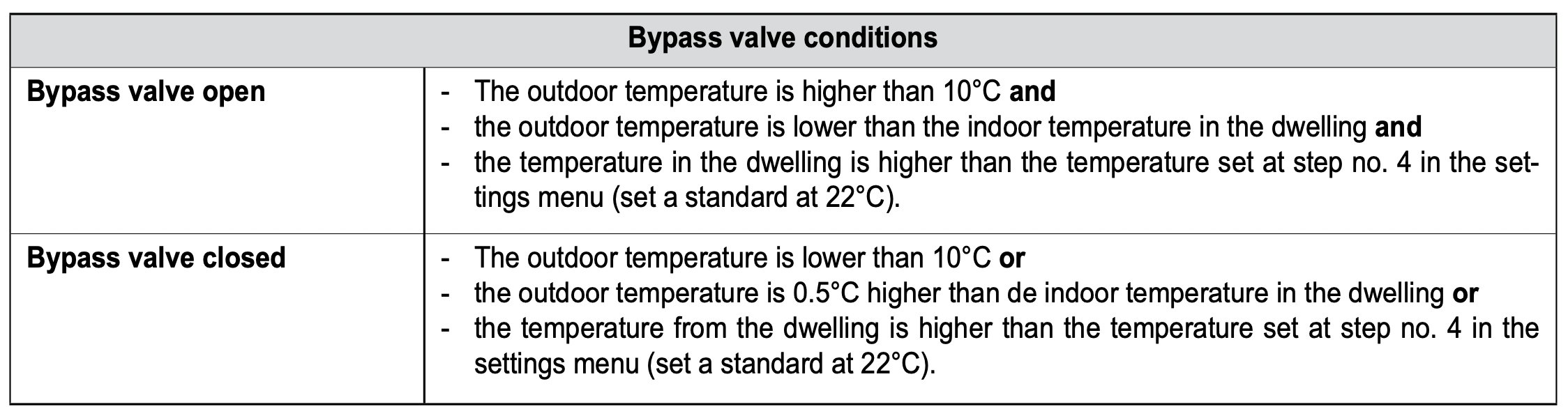

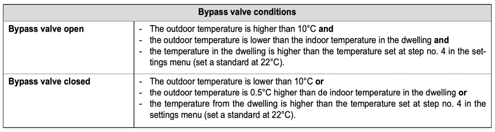

Adsibob Posted September 7, 2022 Share Posted September 7, 2022 On 06/09/2022 at 20:10, Dreadnaught said: On the subject of summer bypass, here are the rules for my Brink unit. I think most units work similarly. I have a brink as well, probably the same machine, and never understood the logic of this. E.g. on the first row, isn’t the third bullet rendered redundant by the first one? Link to comment Share on other sites More sharing options...
Dreadnaught Posted September 8, 2022 Share Posted September 8, 2022 2 hours ago, Adsibob said: never understood the logic of this. E.g. on the first row, isn’t the third bullet rendered redundant by the first one? Good point. I think the third bullet is a typo. It should refer to "Bypass temperature from dwelling". This is how the setting is referred to in the setting menu. It makes sense then. It being a typo is supported by the conditions in the manual for the Brink Renovent Excellent 400, as follows: Link to comment Share on other sites More sharing options...
