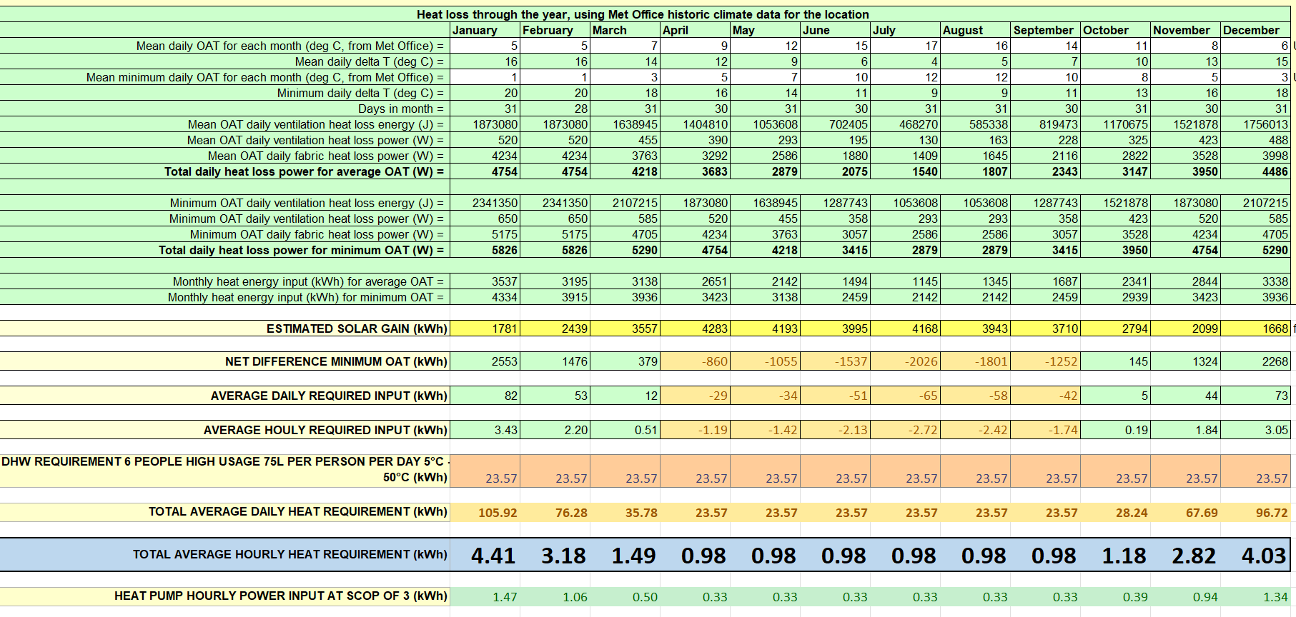

I have been looking, sourcing and trying to design a heating system for our barn conversion. I initially contacted several reputable GSHP/ASHP suppliers and they have come back with system designs with pumps in the region of 25kW to 30kW. Granted our property is quite large but I have been suspicious over their assumptions and calculations as none of them asked me any detailed questions about our build materials etc.
Before just slinging something in I have consequently made the effort to  use @Jeremy Harris Heat Loss Calculator, whilst at it I also used @Lilly_Pines Solar Gain Calculator.
At the worst in January I have calculated a hourly requirement of 4.41 kWh if we exclude any solar gain it is 5.82 kWh. Now I can't understand why I would need a 30kWh capable pump?
Either my calculations are too good to be true and the building will never perform so well in real life/a input mistake has been made... or the suppliers are massively overcompensating. Or am I missing something else?
The next issue is (whether the above is right or wrong) is installing a system that can run on ASHP and another heat source. We are off-grid - so no choice but to use another source of heat. Probably oil for ease of use. However I am seriously considering using a boimass boiler or woodburner with back boiler, this would have to be connected up to a thermal store which from most forum posts is unpopular compared to UVC. (Why is that?)
I have provided monthly solar generation from a 33kW Solar PV array as per https://re.jrc.ec.europa.eu/pvg_tools/en/tools.html I assume it is accurate enough - it is suggesting a PV generation in winter which is 19% of summer output which I have seen bounded around.
If my calculations are correct I have expanded Jeremy's spread sheet to estimate oil usage and it is relatively negligible so burning wood seems unnecessary unless my calculations are all wrong... I have attached my spreadsheet for those interested/willing to have a look - I have noticed @SteamyTea is pretty good at crunching the numbers.

Sounds like the designers are very lazy and not doing the job they should.  Maybe avoid.
Quick question are you sure your coldest day never goes below zero?
Jeremy spreadsheet shows slightly lower than SAP (for me), so may be worth looking at your SAP report also.
You need to basically size for your coldest day, with no solar gain.  Plus you need an allowance for DHW heating.
But if your having an oil/biomass boiler it may make sense to run a smaller heat pump for heating only and leave the oil/bio and solar to sort out the DHW.  That way you get away with something like 5-6kW heat pump.  The benifit of a smaller heat pump is no buffer likely and it energy use will be low and you make use of running on solar in the summer for cooling
Yes I found Jeremy's spreadsheet very accurate, more accurate than the SAP calculations (which had all the same input figures)
If your max heating demand is just over 4kW then I would be fitting a 10kW ASHP to allow it some time off, and some time to heat DHW.

Yes they do - I have struggled across the board to find reassurance from a lot of companies that they know what they are looking at -  but to be this far apart on the calculations has me worried I have it wrong.
Well it is Mean minimum OAT - Devon doesn't get many sub-zero days. I have already included DHW (over compensated this one) If I drop the outside temperature to -3 and remove all solar gain we calculate a hourly heat requirement of 7.88 kWh. Without any solar the Oil will be running anyway as we will be conserving battery power for electrical amenities.

Good to know it is accurate - and I am confident my inputs are right. But as stated it worries me how the 'professionals' can be so wrong.
I was looking at about 10-12kW. Samsung 12kW comes to mind... not sure if they are any good.

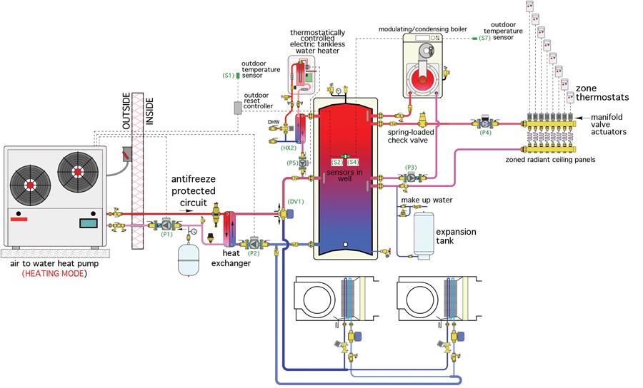

UVC is full of drinking water, so if you wanted to take UFH from that cylinder you would need a coil for the UFH heat exchange.
Have attached a thermal store scheme with heat pump.
Neither scheme is that good for your CoP.
