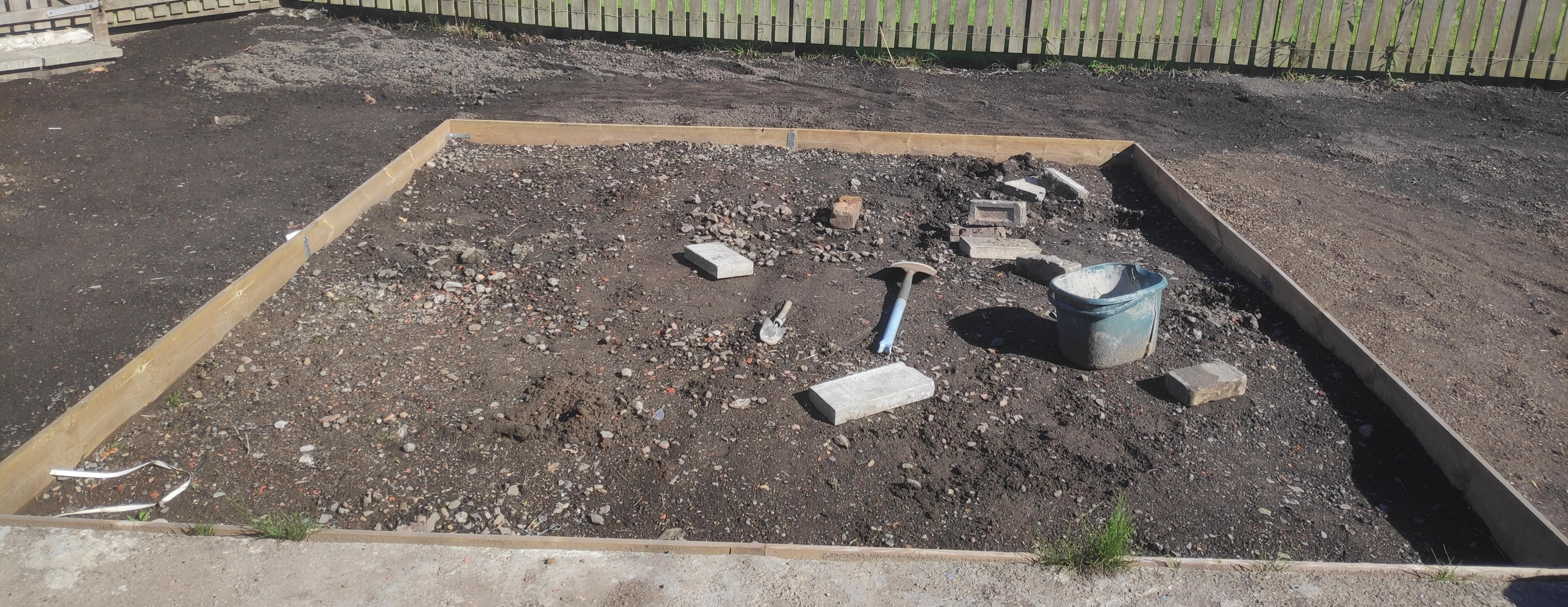

800w Posted August 21, 2022 Share Posted August 21, 2022 Hi I'm going to do a 3.6m x 3.6m patio, I'll be using, new paving, but nothing fancy just plain 600mm x 50mm, with a mortar base of 40mm. So what depth should my sub base be, I'm reading that the standard should be 75mm, just wondering though could I get away with 50mm, it isn't soft soil, and fairly untouched, apart from me digging out the weeds. I had a look on paving expert UK, and it seems that the usual depth is between 75 - 100 for patios, but it is a little vague in areas, and says that sometimes no sub base is needed, so I'm thinking then why not 50mm or is that too thin. I'm a novice I've layed a small path, with 3x2 x 50 mm, and done a couple of other jobs, but the patio will be more of a challenge, so I want to get it right and have it look nice, and as I said I'm using 600mm x 50mm, so I'm not sure because of this you can get away with a smaller depth of sub base, or its the total opposite because I'm using a heavier slab I need a thicker base, Thanks. Link to comment Share on other sites More sharing options...
markc Posted August 21, 2022 Share Posted August 21, 2022 Sub base depends on ground you have and load that will be applied. Remove the vegetation layer (turf, weeds, roots etc) as that will shrink and swell, also to reduce stuff growing back. Lay a geotextile sheet and your 50mm type1 etc will be plenty for a small patio Link to comment Share on other sites More sharing options...
800w Posted August 21, 2022 Author Share Posted August 21, 2022 2 hours ago, markc said: Sub base depends on ground you have and load that will be applied. Remove the vegetation layer (turf, weeds, roots etc) as that will shrink and swell, also to reduce stuff growing back. Lay a geotextile sheet and your 50mm type1 etc will be plenty for a small patio Hi thanks for the reply, can I ask have you done this kind of work, or have experience in this kind of DIY job, I'm not trying to be cheeky, but your the first person that has said go with 50mm, most replies have been 100mm on other forums, some have even said as much as 10" of hardcore, it's not for a car lol, I just think some people it is just overkill, or they've read from some site and are passing it on. I can easily read from a paving site, and apply what they've said but every situation is different and you just need a little common sense, and if it is going to work, the slabs I lay will 2x2 x 50, so all I needed to know was if you were laying tiles say 25mm thick are they going to need a thicker foundation or a lighter one, but I'm laying heavy concrete slabs, FWI all the weeds are gone and there was no turf to begin with, Thanks. Link to comment Share on other sites More sharing options...
markc Posted August 22, 2022 Share Posted August 22, 2022 Morning, yes I’ve done loads of patios, driveways. It all depends on the ground you are working with, many pavements were laid with slabs directly on the ground without any base, most new builds have patios with slabs laid directly on whatever ground they have. Are you working on clay, sand, peat, infill ? These all have a bearing on what you need to do. I wasn’t saying 50mm is ok for everything but you are not laying a road or driveway or say a base for a oil or water storage tank. Dig a small hole and post a pic to show the ground conditions Link to comment Share on other sites More sharing options...

Conor Posted August 22, 2022 Share Posted August 22, 2022 The depth isn't important as much as how compacted everything is. 100mm would be the default as it allows you to get away with an uneven ground below, e.g. if you are on stoney ground you don't have to worry about picking out every protrusion. We dad did ours 20 years ago, we just put 50mm of quarry dust on the (rock hard) ground, and it still hasn't moved. Hire a vibrating plate compactor and make sure everything is firm. 1 Link to comment Share on other sites More sharing options...
800w Posted August 22, 2022 Author Share Posted August 22, 2022 7 hours ago, markc said: Morning, yes I’ve done loads of patios, driveways. It all depends on the ground you are working with, many pavements were laid with slabs directly on the ground without any base, most new builds have patios with slabs laid directly on whatever ground they have. Are you working on clay, sand, peat, infill ? These all have a bearing on what you need to do. I wasn’t saying 50mm is ok for everything but you are not laying a road or driveway or say a base for a oil or water storage tank. Dig a small hole and post a pic to show the ground conditions I had to crop the pic for upload, this is my ground, the wood surrounding it is 160mm high just to give you an idea, so I was thinking just to go down another 5mm, and with 75mm mot1, 50mm paver 40mm full mortar, that would be overall height of 165mm level with the wood or there abouts, I know you can't see the soil clearly but I thought a pic would help. Link to comment Share on other sites More sharing options...
markc Posted August 22, 2022 Share Posted August 22, 2022 Yes, get on with it! Main thing here is compaction to prevent settlement later on. hire a wacker plate go over it a few times, spread the type1, plenty more wacker ing and you are sorted 1 Link to comment Share on other sites More sharing options...
800w Posted August 22, 2022 Author Share Posted August 22, 2022 10 minutes ago, markc said: Yes, get on with it! Main thing here is compaction to prevent settlement later on. hire a wacker plate go over it a few times, spread the type1, plenty more wacker ing and you are sorted Thanks, so should I whacker the soil first as well, before adding type 1? I also have a question about the fall, I know the standard is 1:80, but I'm nowhere near the house as you can see, so should I still stick to the standard, if I did with the size I'm doing, the patio would drop gradually around 4-5cm from one side to the other. Also regarding the fall should I incorporate that straight away on the soil as you see in the picture eg have it sloping down slightly by removing a little soil, in other words create a little slope and keep it there as I add in my type 1, hope that makes sense. You can maybe tell I'm a little nervous about the fall or slope, when It comes to putting down my paving I think I'll be ok, it's just the preparation I'm inexperienced with. Maybe you could help and explain how you go about preparing the area from the start, up untill laying the paving, if you wouldn't mind, I'm just preoccupied thinking about the slope, that when it's finished it's going to look stupid, hope I'm making sense, Thanks. Link to comment Share on other sites More sharing options...
markc Posted August 22, 2022 Share Posted August 22, 2022 2 hours ago, 800w said: Thanks, so should I whacker the soil first as well, before adding type 1? I also have a question about the fall, I know the standard is 1:80, but I'm nowhere near the house as you can see, so should I still stick to the standard, if I did with the size I'm doing, the patio would drop gradually around 4-5cm from one side to the other. Also regarding the fall should I incorporate that straight away on the soil as you see in the picture eg have it sloping down slightly by removing a little soil, in other words create a little slope and keep it there as I add in my type 1, hope that makes sense. You can maybe tell I'm a little nervous about the fall or slope, when It comes to putting down my paving I think I'll be ok, it's just the preparation I'm inexperienced with. Maybe you could help and explain how you go about preparing the area from the start, up untill laying the paving, if you wouldn't mind, I'm just preoccupied thinking about the slope, that when it's finished it's going to look stupid, hope I'm making sense, Thanks. Yes wacker the soil if it has been disturbed, in an ideal world you remove the top without disturbing anything. 1:80 is really aimed at soil pipes and drains to ensure they take “solids” with them. as this is a patio and away from your house then it can effectively be level, but a small crest in the centre is a good thing to prevent pooling. sequence remove any loose soil, vegetation etc. Lay out the working area, wacker the area throw in some sub base … type 1 etc and give it a good compacting, add more type1 and wack again bring up to your level. using a spirit level and straight edge level the surface and ideally give a bit of fall to the edges. laying slabs is just like tiling, start with centre and work outwards, mortar should be 5 or 6 sharp sand to 1 cement, fairly soft mix. some good vids on YouTube regarding laying slabs as it’s easier to watch than explain. Link to comment Share on other sites More sharing options...
800w Posted August 22, 2022 Author Share Posted August 22, 2022 1 hour ago, markc said: Yes wacker the soil if it has been disturbed, in an ideal world you remove the top without disturbing anything. 1:80 is really aimed at soil pipes and drains to ensure they take “solids” with them. as this is a patio and away from your house then it can effectively be level, but a small crest in the centre is a good thing to prevent pooling. sequence remove any loose soil, vegetation etc. Lay out the working area, wacker the area throw in some sub base … type 1 etc and give it a good compacting, add more type1 and wack again bring up to your level. using a spirit level and straight edge level the surface and ideally give a bit of fall to the edges. laying slabs is just like tiling, start with centre and work outwards, mortar should be 5 or 6 sharp sand to 1 cement, fairly soft mix. some good vids on YouTube regarding laying slabs as it’s easier to watch than explain. Thanks, couple queries what is a crest in the centre, and start from the center when laying, I'm not telling you how you do your job, but would you not start from the corner, if I started from the center that would confuse me even more lol, I've no cutting my patio is 3.6m so 36 pavers no cutting and just a simple square. Link to comment Share on other sites More sharing options...
markc Posted August 22, 2022 Share Posted August 22, 2022 2 hours ago, 800w said: Thanks, couple queries what is a crest in the centre, and start from the center when laying, I'm not telling you how you do your job, but would you not start from the corner, if I started from the center that would confuse me even more lol, I've no cutting my patio is 3.6m so 36 pavers no cutting and just a simple square. Hi, if you don’t have to force the water in one direction I.e away from a wall then you can slightly raise the centre of the area, sort of a very slight hump in the centre so water runs off in any direction. if you are using whole slabs then yes you can start in a corner, most pavers and tilers have a set size so starting in the centre gives even cuts around the outside edge. it is always easiest to start at the highest point tho regardless of where the slope runs and work your way downhill Link to comment Share on other sites More sharing options...
800w Posted August 22, 2022 Author Share Posted August 22, 2022 (edited) 34 minutes ago, markc said: Hi, if you don’t have to force the water in one direction I.e away from a wall then you can slightly raise the centre of the area, sort of a very slight hump in the centre so water runs off in any direction. if you are using whole slabs then yes you can start in a corner, most pavers and tilers have a set size so starting in the centre gives even cuts around the outside edge. it is always easiest to start at the highest point tho regardless of where the slope runs and work your way downhill Thanks so I think I'll just have it running with a slight slope, but not as much 4-5cm, but just enough to stop pooling, I think the crest idea would be fine if you were starting in the centre, and slope down gradually as you get to the edges, so if I go with where my garden naturally has a fall, and follow that for my paving, instead of trying to create a fall, then my first row of pavers should run that way naturally sloping down slightly. I've watched YouTube videos and they're good info, all there patios seem to be close to the house though, and they always bang on about the fall, there never seems to be someone creating a patio, in the middle of the garden like mine lol. Edited August 22, 2022 by 800w Link to comment Share on other sites More sharing options...
