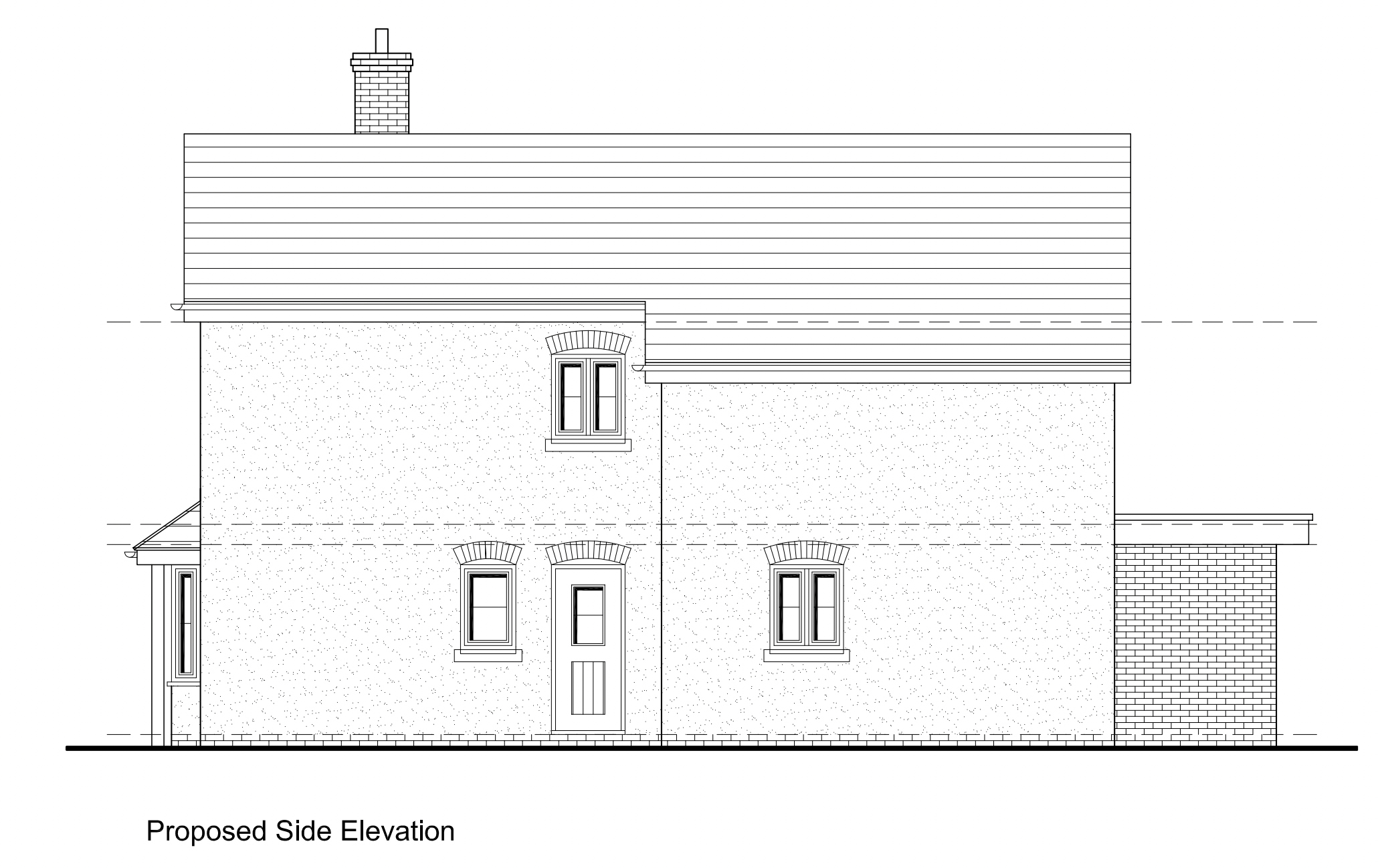

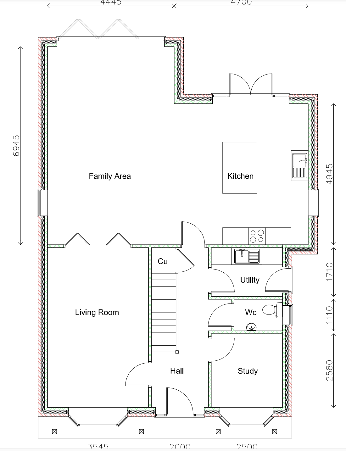

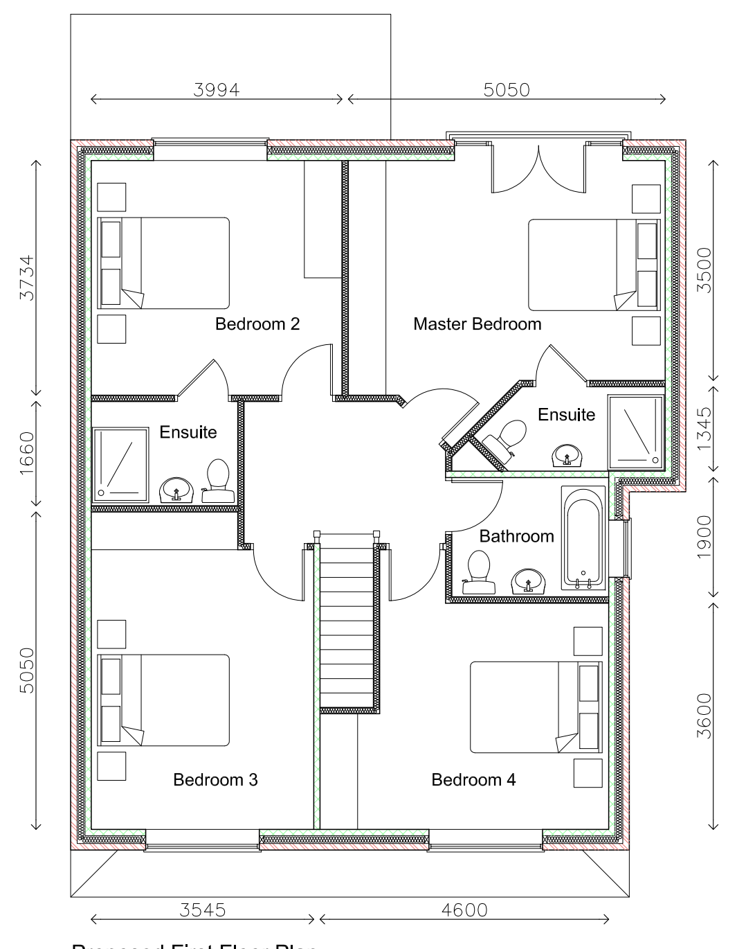

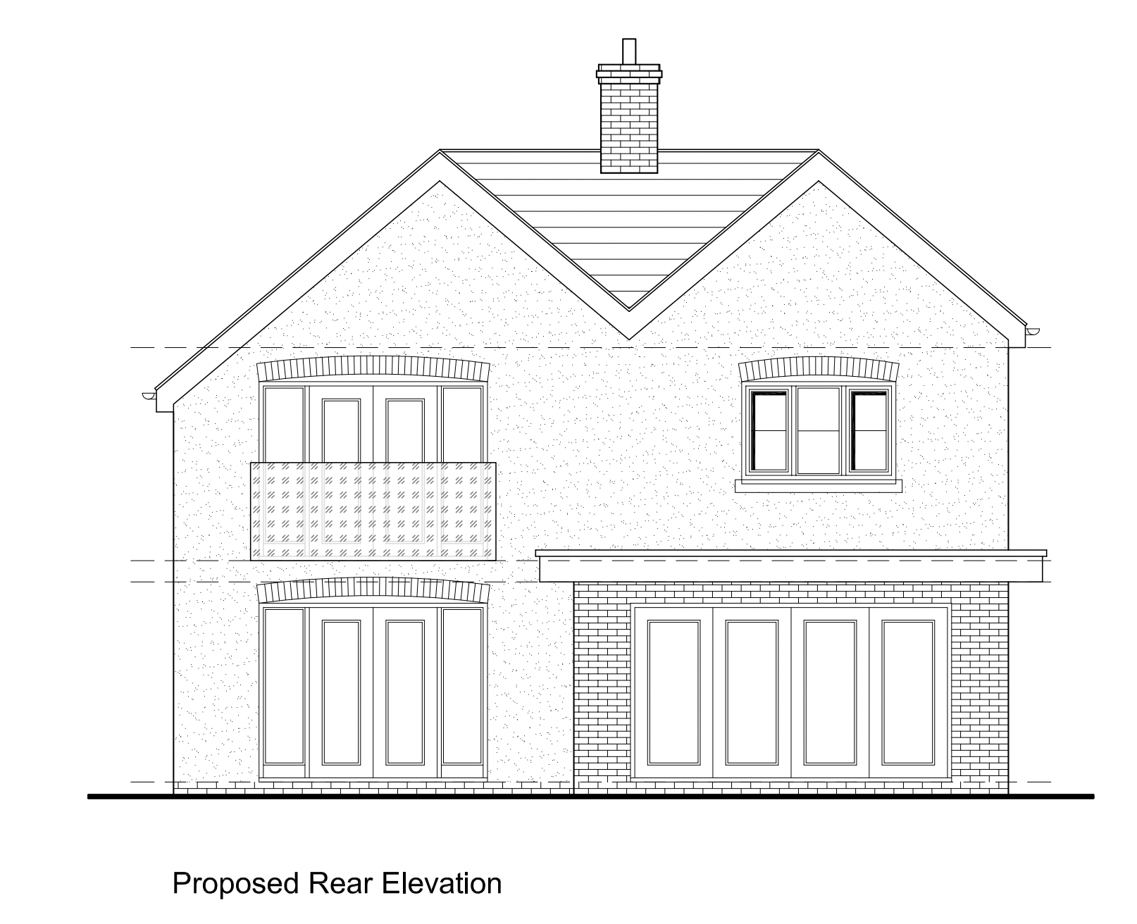

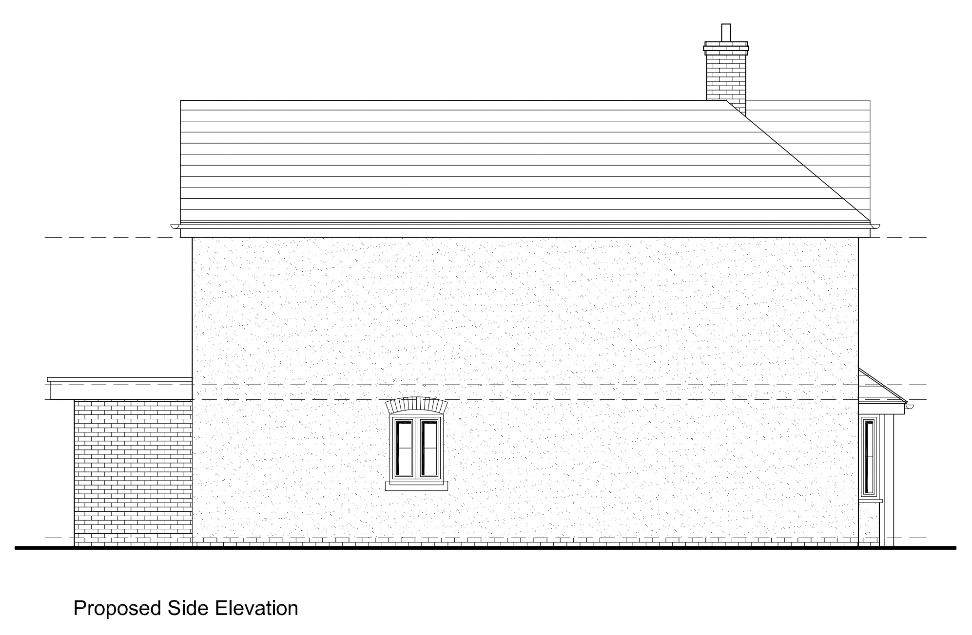

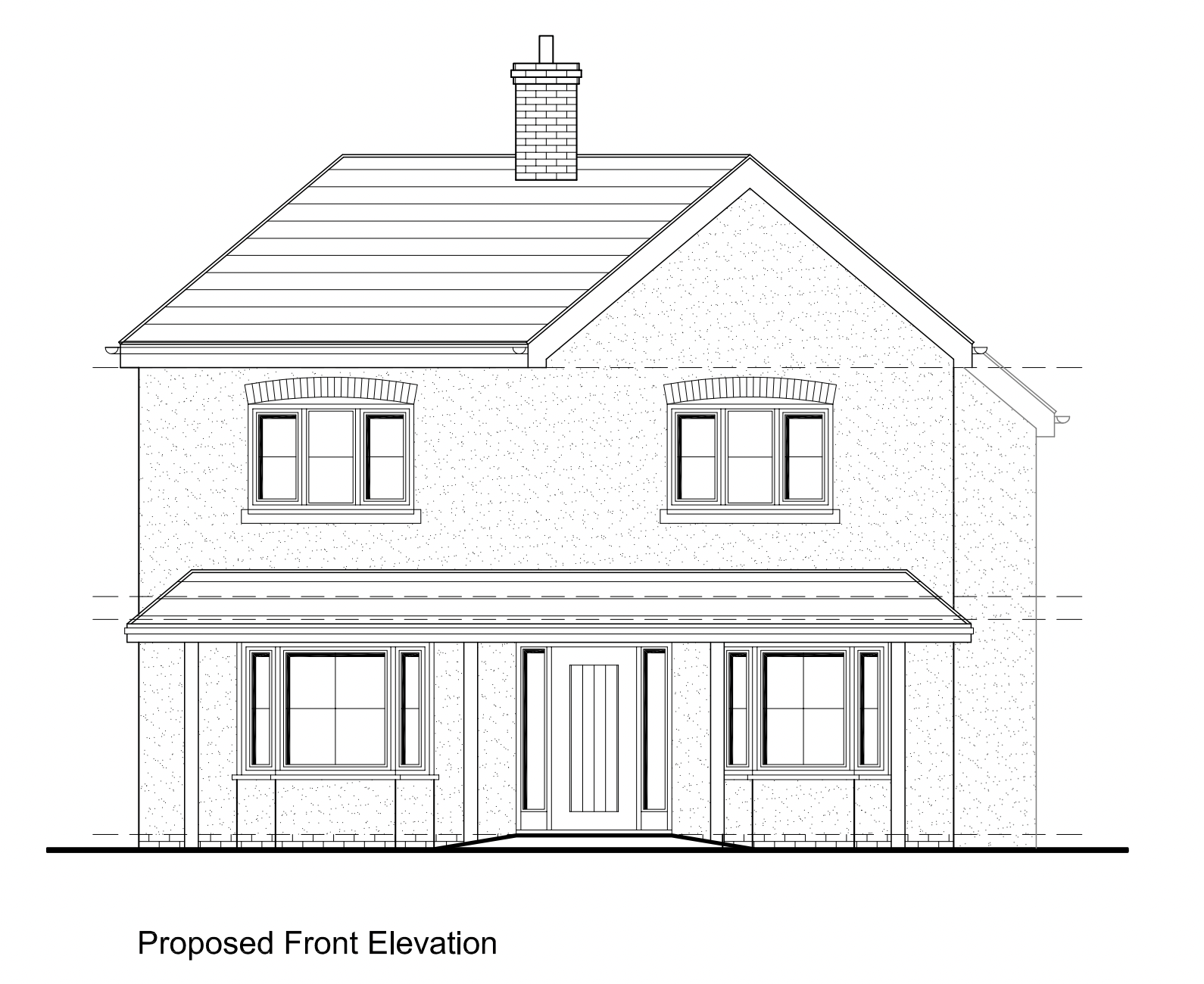

TheSalopian Posted August 17, 2022 Posted August 17, 2022 (edited) I've the following design but concerned RE: the crazy prices across the industry - can we afford to build this in 2022? we're hoping to keep costs around £1500sqm. @ 187m2 GFA Our plan is to use a local builder/contractor/TF to get us to a watertight stage; then takeover the management for the fitout. No consideration to method of construction; so any insight there would also be useful. Externally, the building will be rendered. I would've liked to extend the ground floor extension across the whole width of the house, however that area is within a TPO RPA. However, I think you can encroach up to 20% of the RPA, so it might be possible - but again need to consider costs. (Would this be classed as a material amendment for planning? - or could we argue it's a minor change?) EDIT: forgot to mention, this will be built in the west midlands. Edited August 17, 2022 by TheSalopian
nod Posted August 17, 2022 Posted August 17, 2022 It looks like a nice straightforward design Using TF as apposed to traditional will make your build convenient But will cost quite a bit more

CharlieKLP Posted August 17, 2022 Posted August 17, 2022 Timber frame and brick was about the same until recently, not I’m not so sure. What is better with timber frame is the speed and ability to get the better u-values. In the South people often work to £2000 per m2, maybe it’s cheaper there? I think you’ve missed your chimney flue off your floor plans. In terms of design, it’s a bit clunky but I’ve seen far worse.

TheSalopian Posted August 17, 2022 Author Posted August 17, 2022 28 minutes ago, CharlieKLP said: I think you’ve missed your chimney flue off your floor plans. When I submitted this post I was looking at the pictures for ages thinking something didn't add up! RE: TF vs Brick, I was thinking that the deciding factor would probably be reduce time to build, resulting in reduced finance costs (less time with high rate self build mortgage). What I'm struggling to figure out here is if I've got £300k to build this to completion, how much "wiggle room" do I have to play with for some creature comforts (to me anyway) things like PVs, AC, GSHPs etc. Or, perhaps it would better to just put those niceties out of mind for now?
