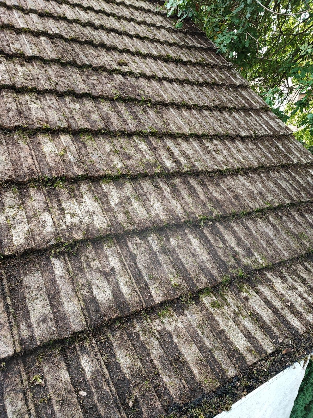

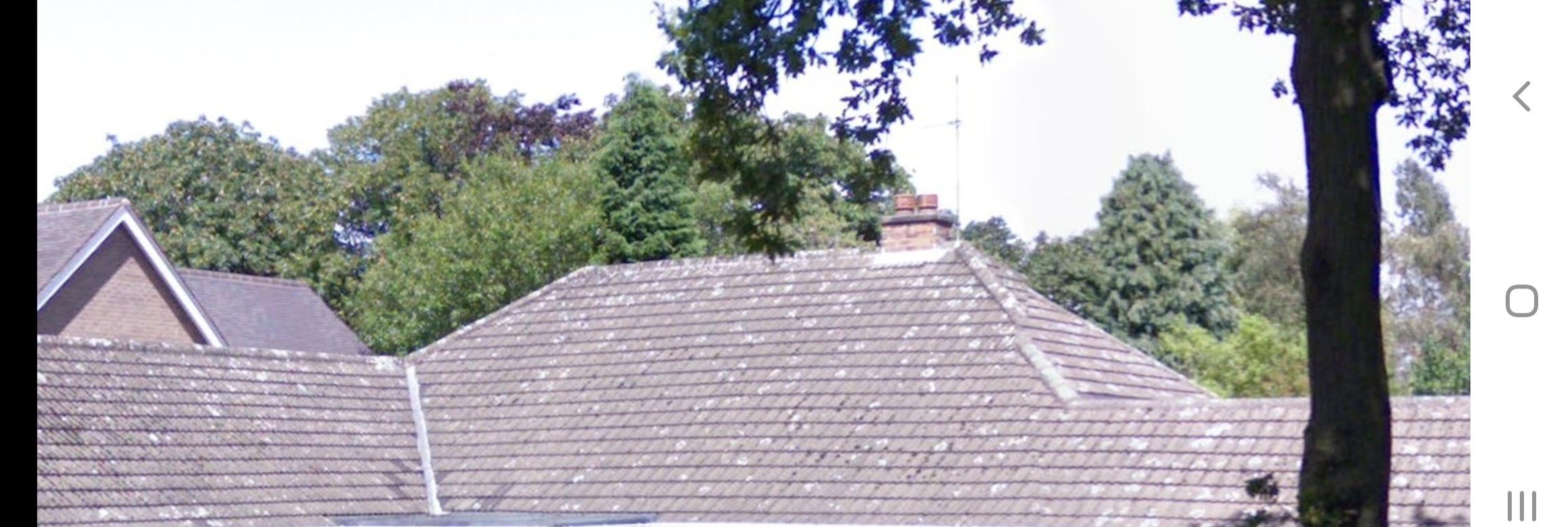

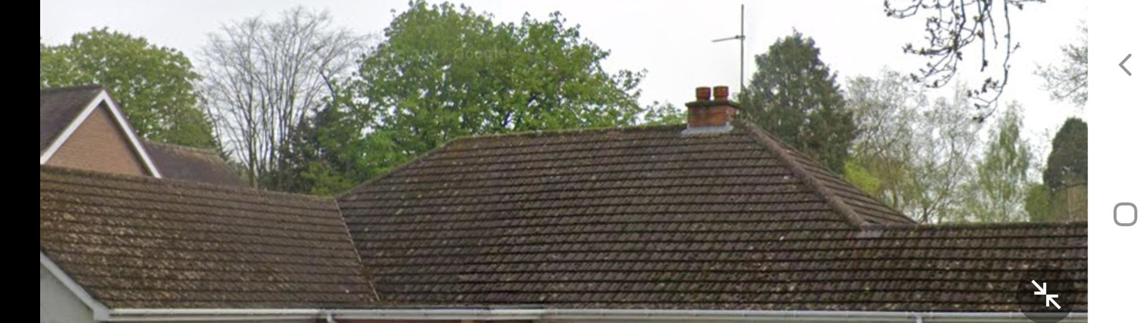

Zak S Posted August 16, 2022 Share Posted August 16, 2022 Hi. My banglow was built in 1960 and now it has concrete roof tiles. It seems that at some stage it was roof was retiled (probably around 1997) but I am not totally sure - see the google street image from 2008 and 2022. There are lots of trees around and as a result roof tiles get a bit mossy. We have not yet moved in but the area where we are living all houses here were built 1970s and one of the house right behind my house had concrete tiles jet washed and sealed (not painted/coated). When I spoke with the guy he said he can do the roof coating as well on my banglow. He gave me a name (which I am not sure I am allowed to mention here - it rhymes with plymashield 🙂?) But I have tried to find video about this product as well as reviews but couldn't find any except on the company's own website. All reviews on Amazon are also disabled. Are you able to share your views with me if cleaning the roof, resealing and applying roof coatings are worth it. My roof seems a bit dirty but other than that seem solid. The cost is 550 cleaning and sealing and 550 roof coating. Thanks in advance. Link to comment Share on other sites More sharing options...

Simplysimon Posted August 17, 2022 Share Posted August 17, 2022 save your money, fair chance they will wash upwards under the tiles, walk up the roof while doing so and break a good few tiles. you will also be removing the top layer of cement which will have the result of making the tiles even rougher and therefore gather moss more quickly. the sealant doesn't/can't sink into the tile and will sit on the surface and wear off relatively quickly. Link to comment Share on other sites More sharing options...

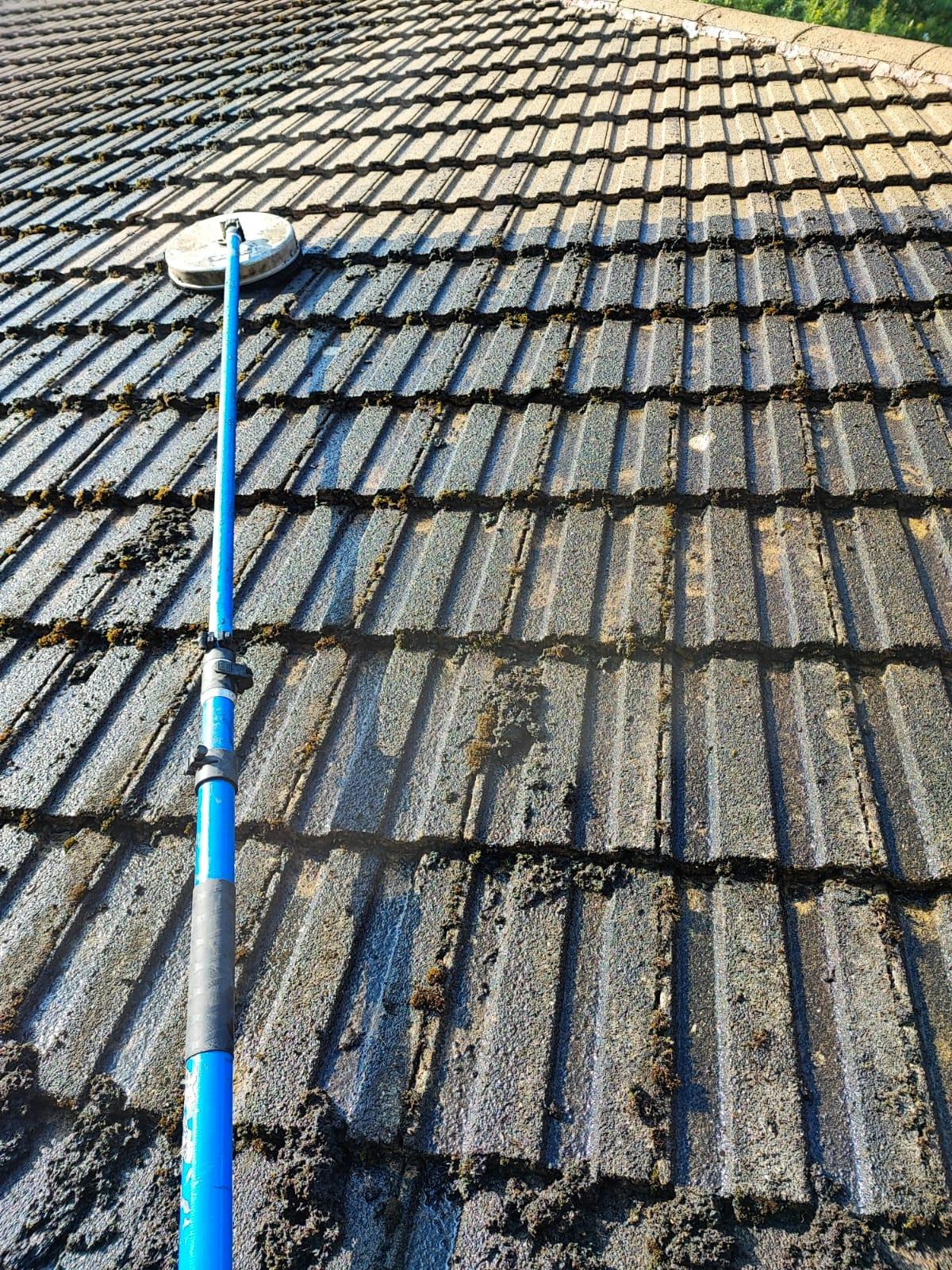

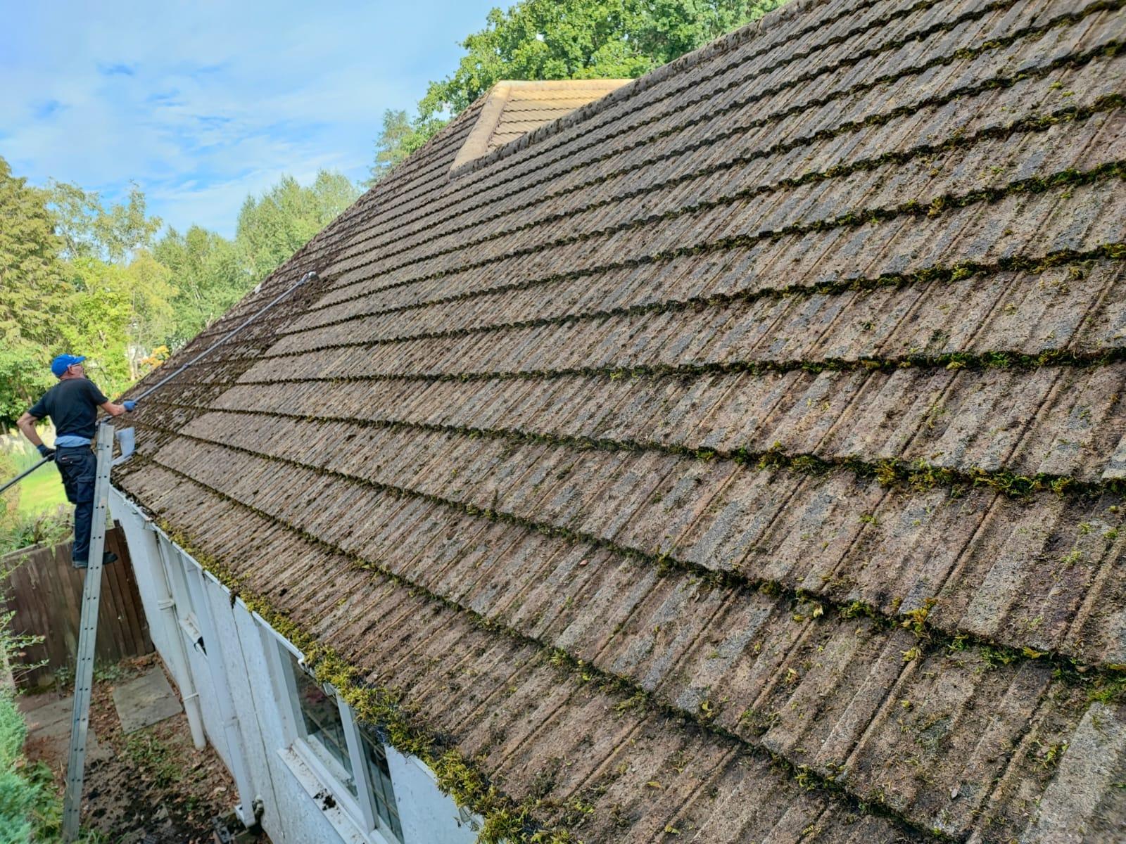

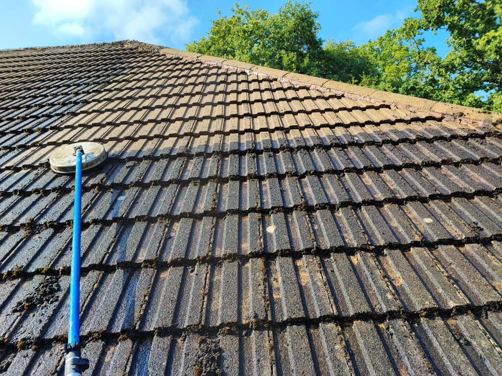

Zak S Posted August 18, 2022 Author Share Posted August 18, 2022 8 hours ago, Simplysimon said: save your money, fair chance they will wash upwards under the tiles, walk up the roof while doing so and break a good few tiles. you will also be removing the top layer of cement which will have the result of making the tiles even rougher and therefore gather moss more quickly. the sealant doesn't/can't sink into the tile and will sit on the surface and wear off relatively quickly. Thanks. I have dropped the idea of jet washing but had a quote for the steam cleaning which based on the videos seem quite satisfying. They use the extension pole rather than walking on the tiles and and gently wash with hot water and then apply biocide. The price is 1k and it does not include painting the roof tiles as the claim is that steam clean retun the tile to original colour. Given the tiles are only 25years old, this might be sensible thing to do. What do you think? Also any idea about render clean? Link to comment Share on other sites More sharing options...

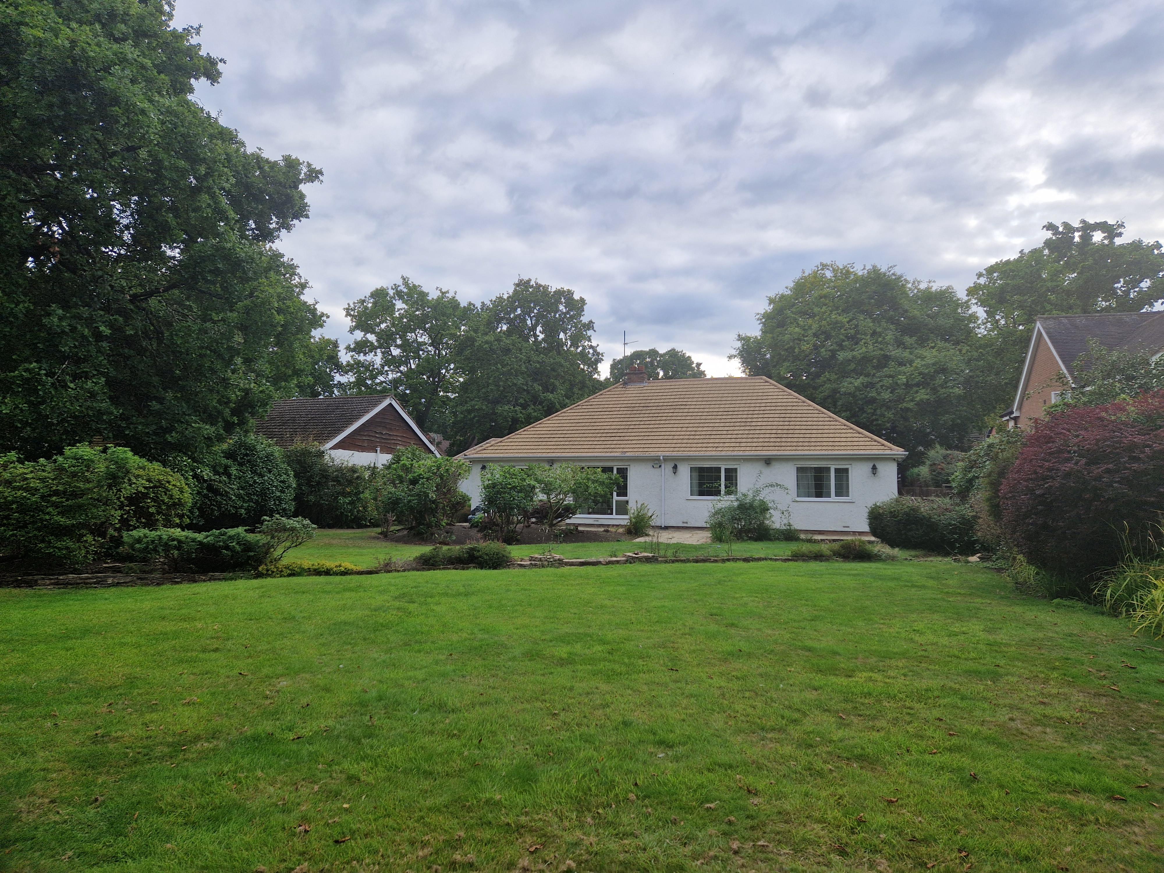

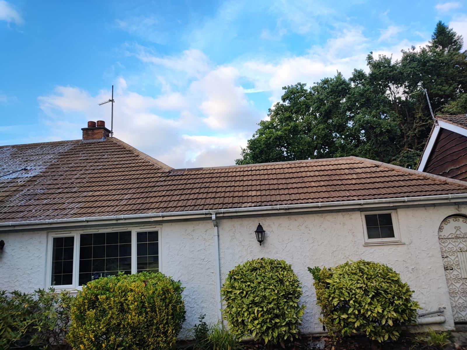

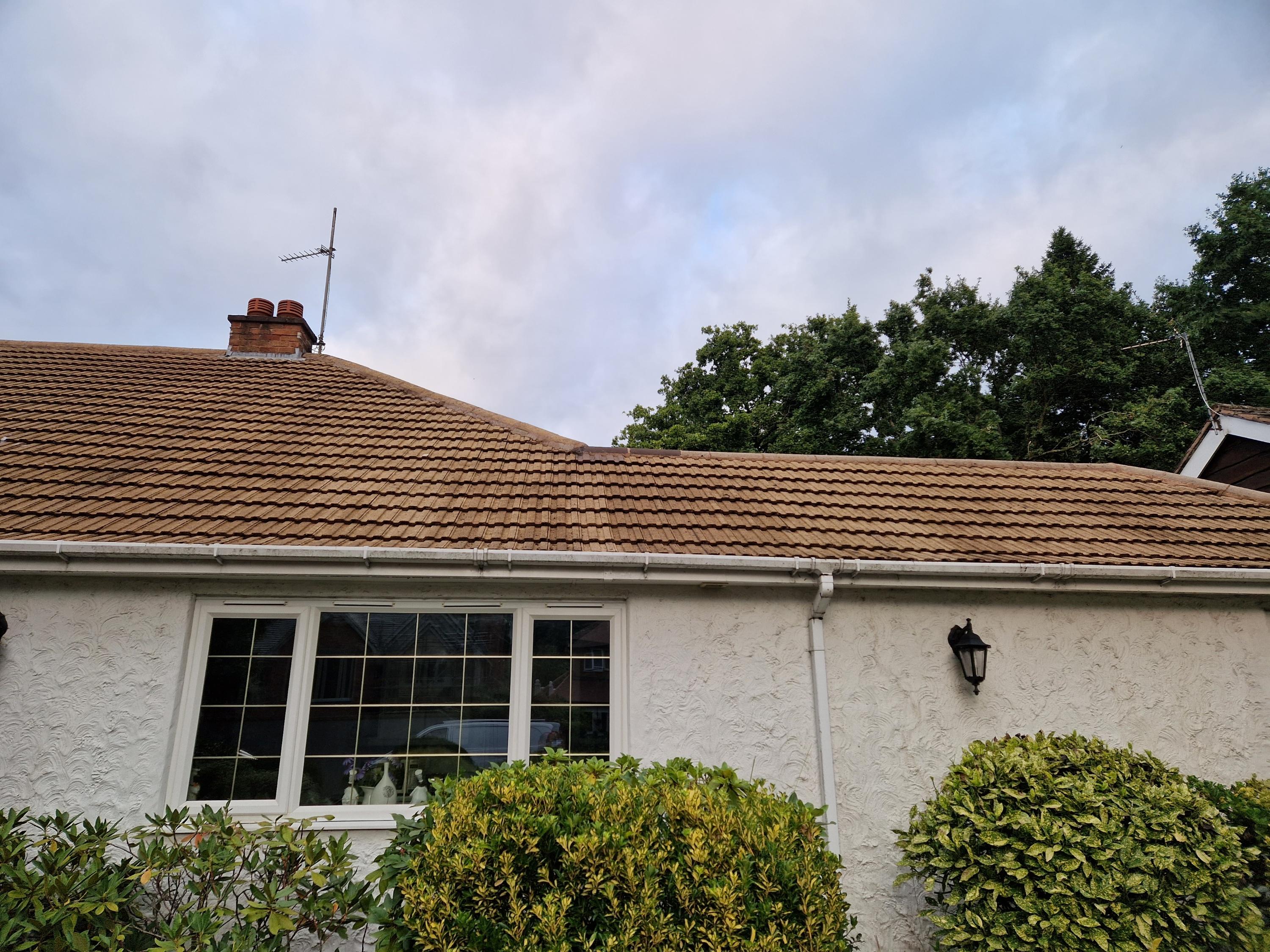

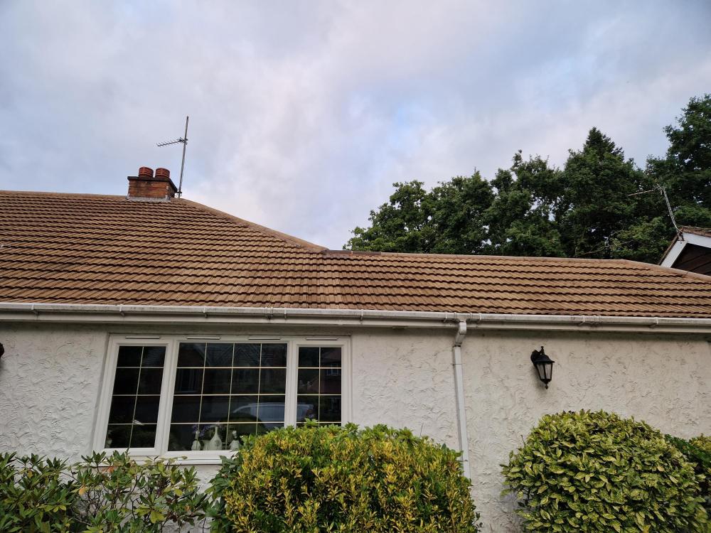

Zak S Posted September 17, 2022 Author Share Posted September 17, 2022 Before and in progress view. My personal view us that cleaned roof is not far-off from new roof though colour and design is not common these days. With windows, guttering facias and render clean it looks very good. I will post picture of completed view.  The work carried out: Scrapped moss Steam clean Biocide treatment Facia, garage door, guttering Nd windows clean Patio clean Render cleaned (side only with soap, all with gental water and brush) Cost: £1.8k Number of man hours working: 72hrs (3days for two men working 12hr each day). It comes to c£23 per hour  Roof size is huge so though initially quote was 1.6k I paid 1.8 as the hard work was evident  Link to comment Share on other sites More sharing options...
Simplysimon Posted September 17, 2022 Share Posted September 17, 2022 looks good cleaned, however, with the moss covering i think roofs blend into the landscape a bit more especially in the country, home for bugs and food for birds but obviously gutters need cleaning. 2 Link to comment Share on other sites More sharing options...
Zak S Posted September 20, 2022 Author Share Posted September 20, 2022 On 17/09/2022 at 22:26, Simplysimon said: looks good cleaned, however, with the moss covering i think roofs blend into the landscape a bit more especially in the country, home for bugs and food for birds but obviously gutters need cleaning. With few properties dotted around with new roof, dirty roof of the nanglow felt a bit dated. The view from the rear. Property to left was an example how it was before. Link to comment Share on other sites More sharing options...
Simplysimon Posted September 20, 2022 Share Posted September 20, 2022 yup, it does look good, almost like new, however, the roof on the left looks 'more settled in it's surroundings' Link to comment Share on other sites More sharing options...
Zak S Posted September 20, 2022 Author Share Posted September 20, 2022 (edited) 10 minutes ago, Simplysimon said: yup, it does look good, almost like new, however, the roof on the left looks 'more settled in it's surroundings' House on the left has planning permission to be rebuilt as two story house so it will be no more. To be honest I would have left it as is if their was not so much development happening on the road. There are the 8 properties out for 20 with new roof (having either rebuilt or renovated) and three are right opposite. Probably its the competition 😀. It would get weathered soon given lots of trees around. Edited September 20, 2022 by Zak S Link to comment Share on other sites More sharing options...

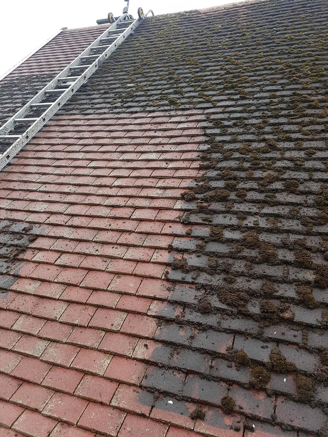

Zak S Posted March 22 Author Share Posted March 22 On 07/01/2024 at 12:07, NorthernLiam said: It's definitely worth it if you are starting to notice it from the ground looking up. My roofer told me that instead of seeing it as a way of making your roof look nice, it's better to think of it as a preventative measure. A full roofing replacement later down the line will be much more expensive than roof moss removal now. There is no best time of year to remove moss from a roof either. Looks likes your clay tiles (if I am right) in pretty good condition so definitely worth keeping tidy. I am sure aesthetically looks much better. Link to comment Share on other sites More sharing options...
