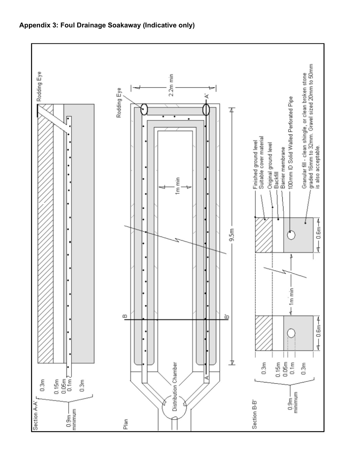

Kelvin Posted August 16, 2022 Share Posted August 16, 2022 I thought infiltration (or a soakaway in some cases) was pretty standard. As understand it it’s not just about surging water but also about removing potential pollutants from the water. I haven’t got everything back yet from the SE but I’m expecting something similar. We will have a soakaway for the treatment plant. It was also originally 1mx25m but I pointed out it was within 50m of my neighbour’s borehole so it’s been redesigned to be 9mx2m and however deep it needs to be. Link to comment Share on other sites More sharing options...

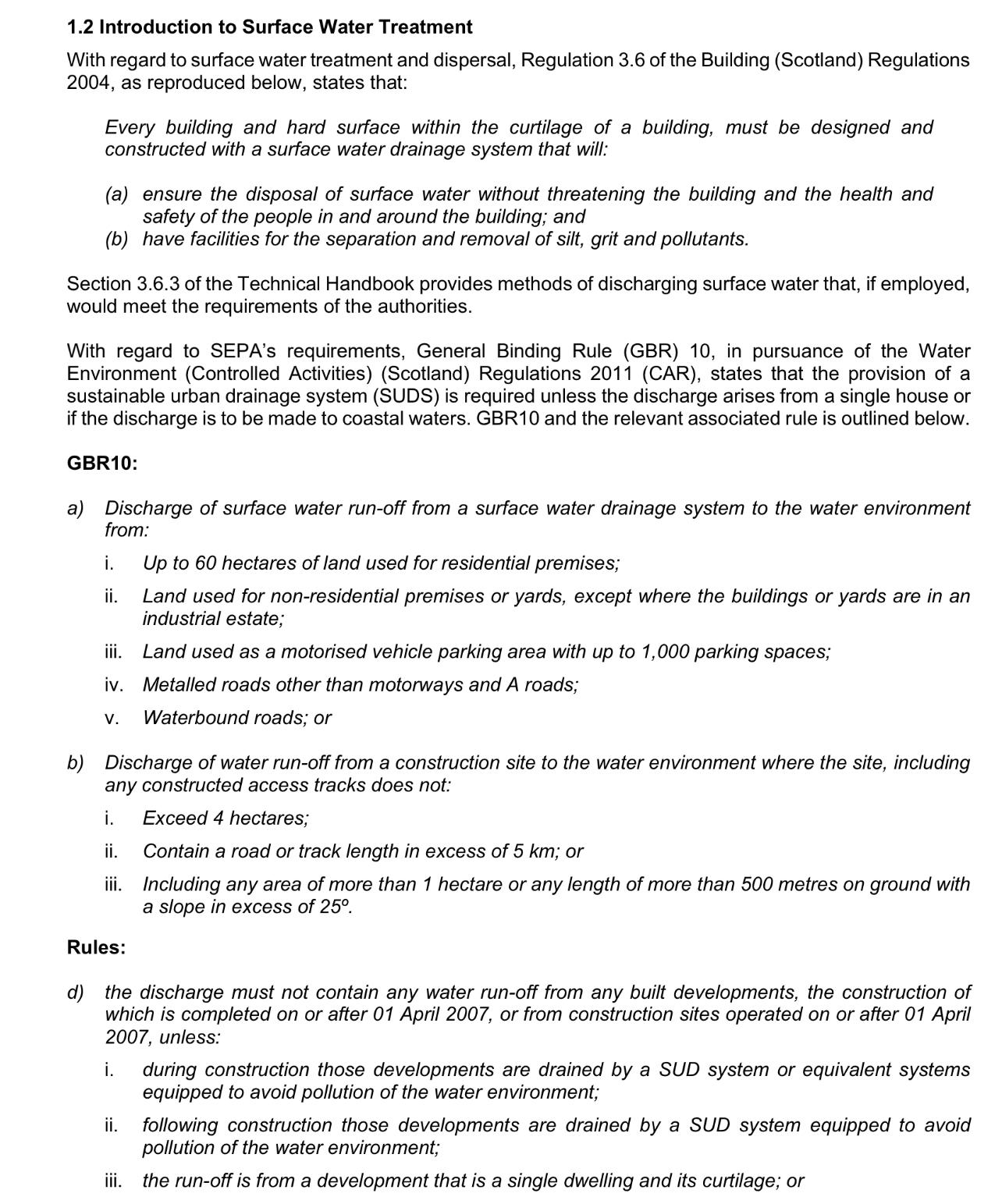

Kelvin Posted August 16, 2022 Share Posted August 16, 2022 (edited) Roofs can be sources of concentrating pollutants that is subsequently picked up by water run off. I don’t know whether it’s of particular consideration here. There’s quite a lot of research done on it. Anyway, here’s the regs for the domestic technical handbook (I’ve assumed Scotland) which has a section on surface water drainage and soakaway sizing. My understanding, which isn’t much, is that a filter trench is much the same as a soakaway except that a certain amount of the runoff is allowed to drain to the water course via a pipe. https://www.gov.scot/binaries/content/documents/govscot/publications/advice-and-guidance/2017/01/building-standards-2017-domestic/documents/building-standards-technical-handbook-2017-domestic/building-standards-technical-handbook-2017-domestic/govscot%3Adocument/Building%2Bstandards%2Btechnical%2Bhandbook%2B2017.pdf?forceDownload=true Edited August 16, 2022 by Kelvin Link to comment Share on other sites More sharing options...

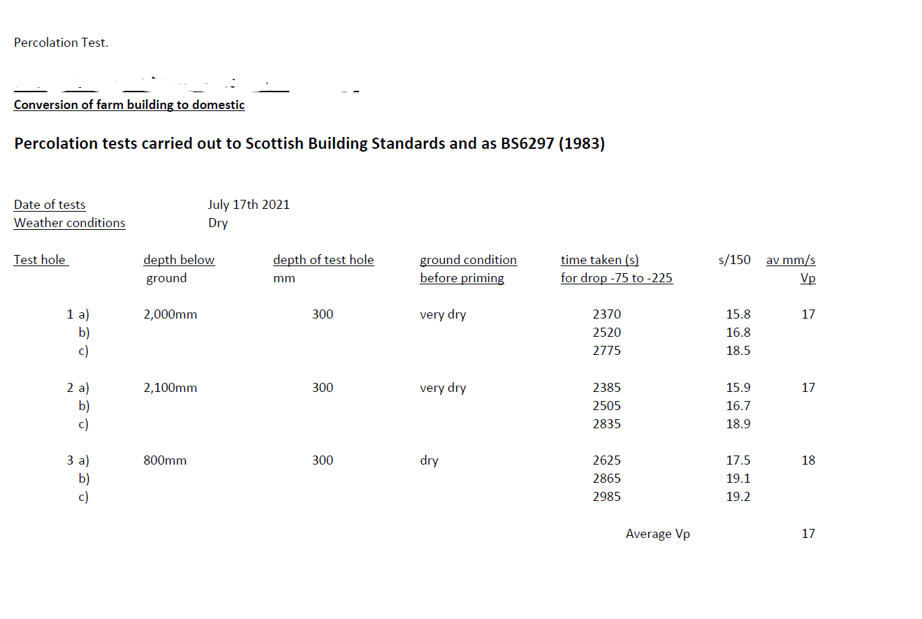

Barryscotland Posted August 23, 2022 Author Share Posted August 23, 2022 Does anyone have there percolation test findings and soakaway design they can share with me so I can see what I need to present to BC? Link to comment Share on other sites More sharing options...

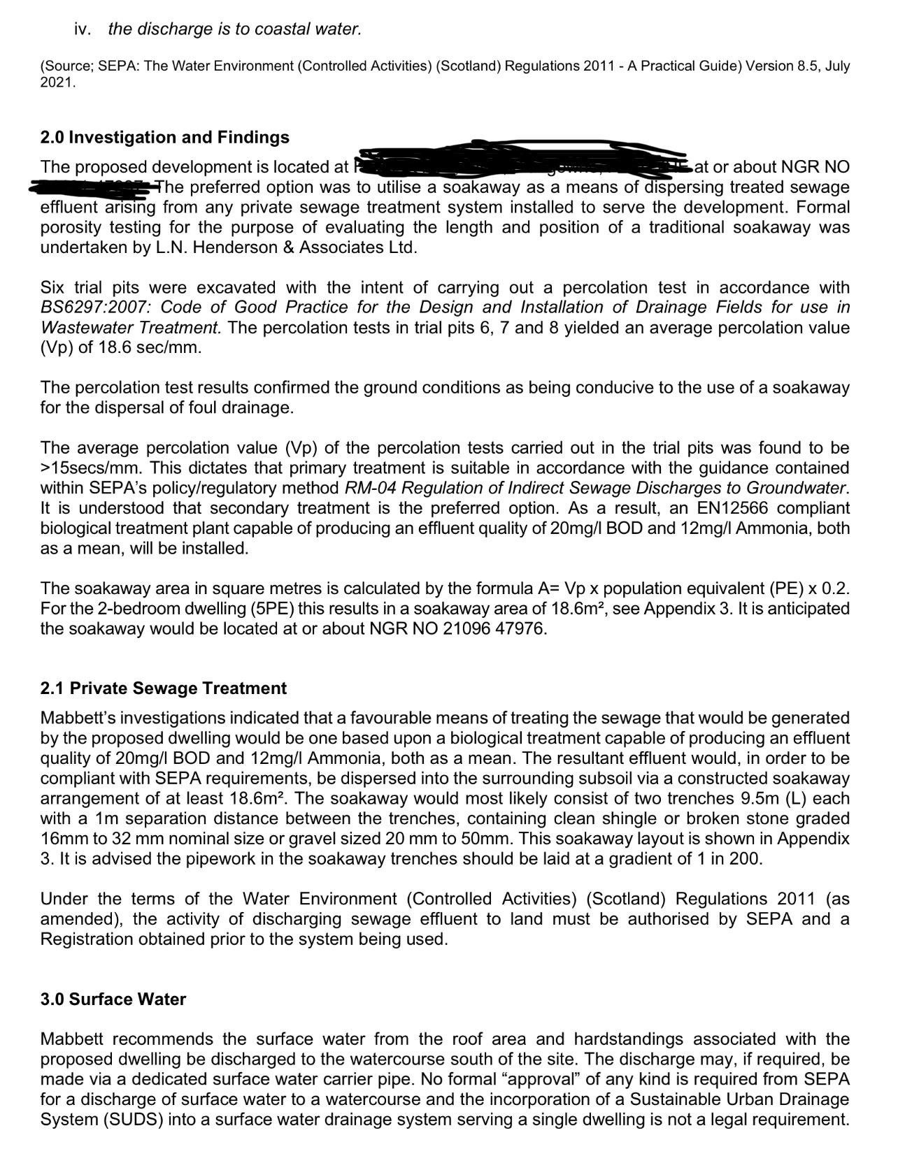

Kelvin Posted August 23, 2022 Share Posted August 23, 2022 (edited) My surface water drainage is straight into a water course. My soakaway design is for foul drainage. Here are screenshots of the relevant sections of the report: Edited August 23, 2022 by Kelvin Link to comment Share on other sites More sharing options...

saveasteading Posted August 23, 2022 Share Posted August 23, 2022 (edited) Here is mine. NB this is exceptionally porous. Our soakaways are very small. We happened to have deep pits dug for other reasons so tested within them. The test holes can be nearer the surface. Soakaway design I am not publishing at present. See how you get on with percolation first. Then you have to do rainfall calculations before doing a soakaway proposals, which are not easy. Edited August 23, 2022 by saveasteading Link to comment Share on other sites More sharing options...
Gus Potter Posted August 24, 2022 Share Posted August 24, 2022 Wow.. these show a really fast results.. you are lucky.. but did you check if they are too fast? From memory there is an upper limit in the BRE design guide. Will stand corrected though. Link to comment Share on other sites More sharing options...
Barryscotland Posted August 24, 2022 Author Share Posted August 24, 2022 Thanks for the info shared, what I've taken from it is I will need to pay somebody to put together something to present to BC as its not something I can put together myself. The ground worker has done two percolation tests and given me a VP of 38 and recommended a soakaway of 4.5m3 if using crates but he is unable or unwilling to put it all together into something like Kelvin has shared above. So back to the SE to see if he will accept our tests and work from there or wants to come out and do his own and how much he will charge us for the pleasure. Section 3.0 on kelvins report makes it clear to me that we should of been able to pipe straight into the burn without the need of the 25m3 of filtration strip. Link to comment Share on other sites More sharing options...

saveasteading Posted August 24, 2022 Share Posted August 24, 2022 8 hours ago, Gus Potter said: but did you check if they are too fast? Yes, the stated limit is 15, so we are just outside that. However, I'm sure SEPA would have accepted a faster flow, as there is 15m of the same sand below that, so the water will be very well spread out before it hits the stone and runs off to the burn. The fast limit is to prevent erosion and sinkholes, and over-fast flow to watercourse, and neither would apply, Link to comment Share on other sites More sharing options...
