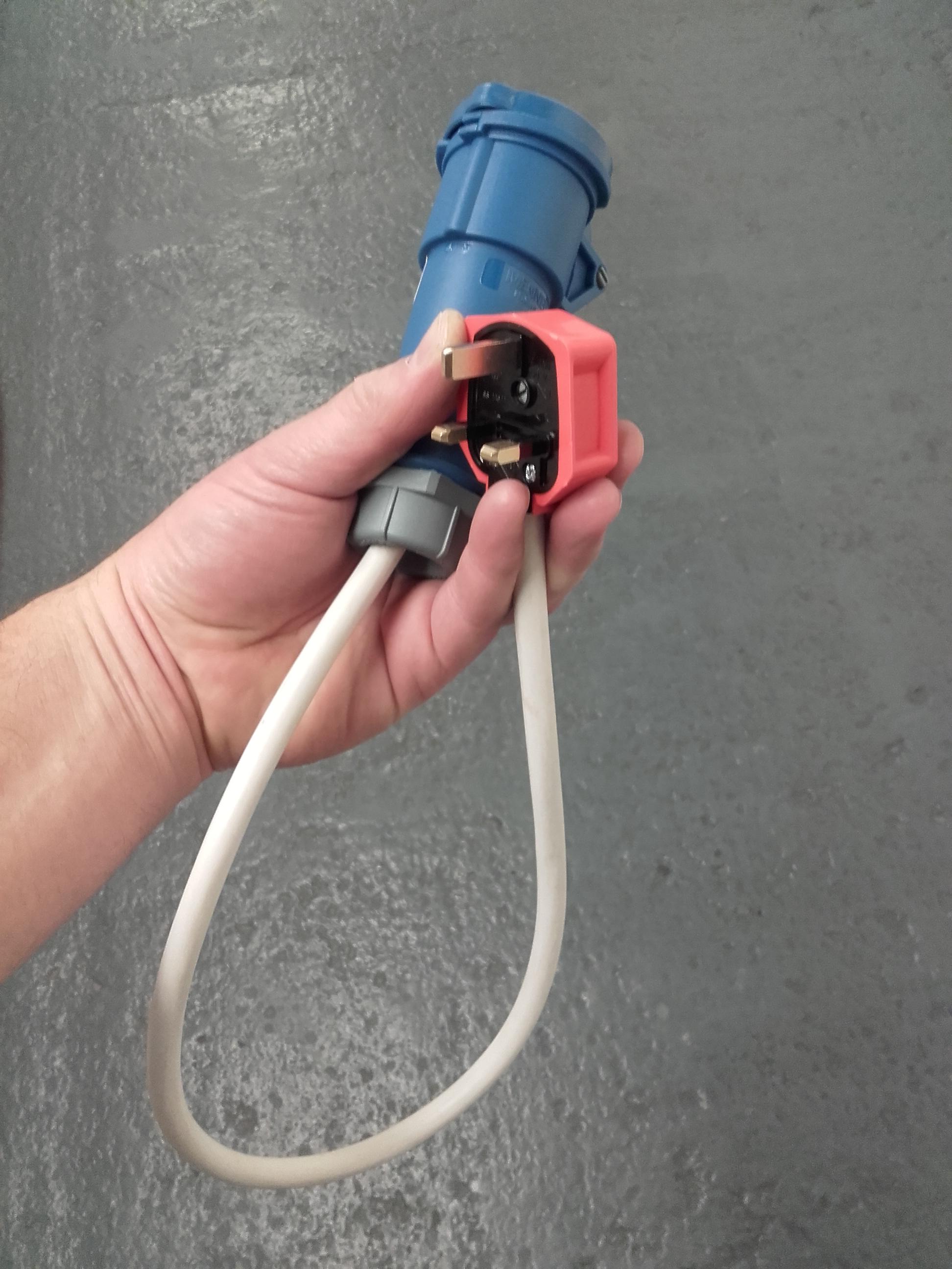

Onoff Posted June 9, 2017 Author Posted June 9, 2017 44 minutes ago, dpmiller said: Inverters are SO much nicer to weld with than transformers. Watch the warranty carefully- smaller/ cheaper ones only have one PCB that does everything and a chargeable replacement generally costs more than a new welder. This onle looks like a good choice tho. Treat youself to the scratch TIG kit and some Hobbyweld gas if a lot of stainless is on the to-do list 3 year rtb warranty on this one from a known seller. Bought following good comments over on the mig welding forum. Back when I was first looking it was the XTS 160 I was looking at but as I take so long deciding things it's evolved into the 162! Nice that it'll cope too with an input voltage of +/- 15% so should be alright off a gennie. They do a dual voltage version the XTS 162 DV but that's limited to 130A on the 110V setting. Also a big brother 200A version available. As I said I stuck a blue plug on the actual welder lead & made an adapter lead up so it'll run off a dedicated 16A socket for heavier duty or a normal 13A for light stuff. Trouble is, is I borrow it this weekend the bathroom won't get finished!
