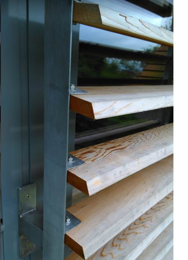

Ferdinand Posted June 8, 2017 Posted June 8, 2017 (edited) On 08/06/2017 at 16:44, ragg987 said: We have this. Stainless L-channel and plate knocked up by a local fabricator and off-the-shelf Canadian Western Red Cedar slats cut to size. I kept the downward angle of the slats small - about 10 deg - to permit water run-off without blocking the view and light. In our case it has a practical purpose but is also an architectural feature. Expand WAs that wood expensive? I am currently after a 50mm x 250mm x 1.5m chunk for a bench? I am being quoted £25 for that in newly cut Green Oak, which seems OK, but I really want something self-maintaining, so I am waiting for a job lot if I can find one. Edited June 8, 2017 by Ferdinand
ragg987 Posted June 8, 2017 Posted June 8, 2017 Don't know, this was one of the few materials I asked my builder to supply and I did not ask for a breakdown. I suspect it might be.
