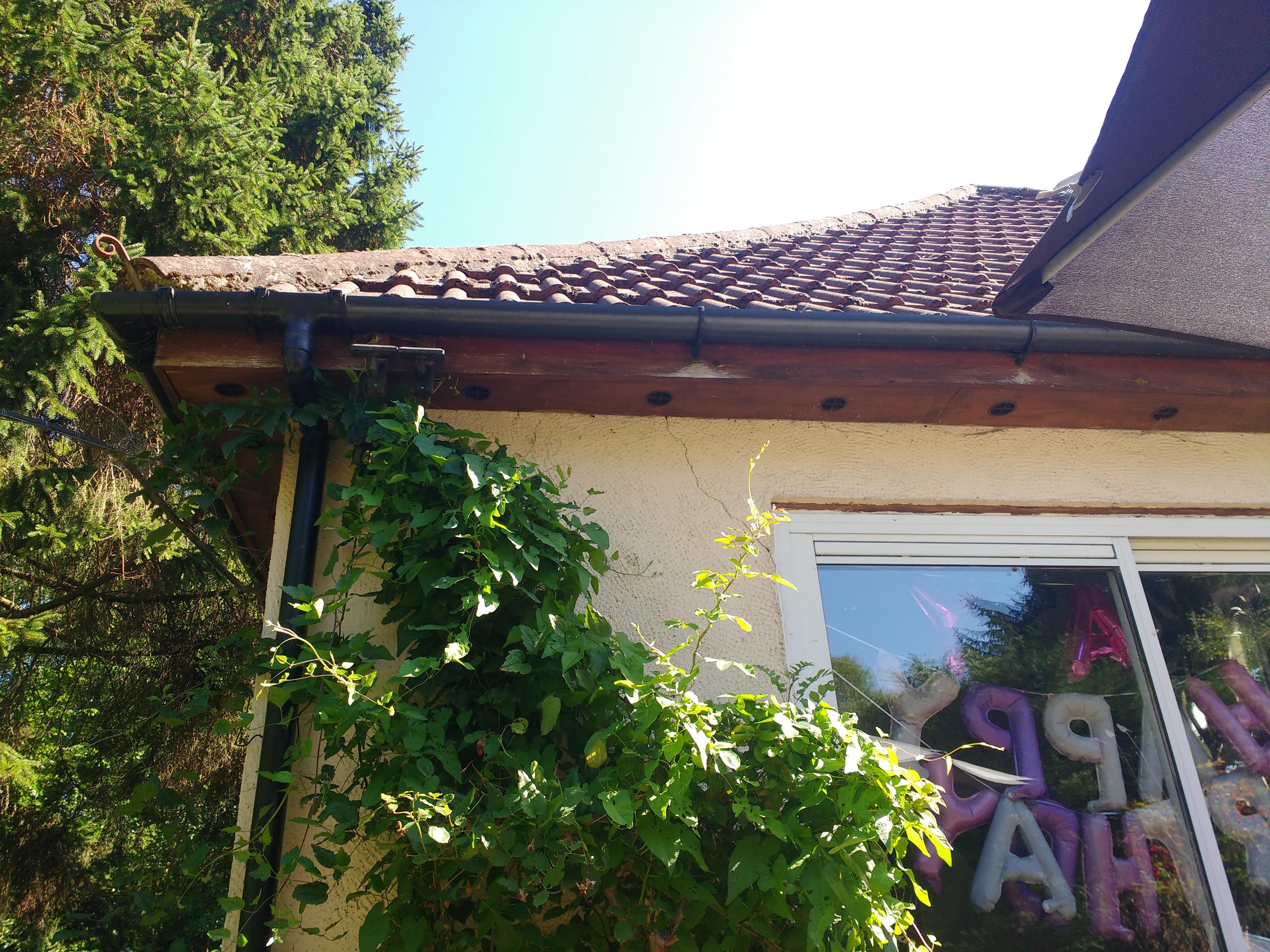

Oxbow16 Posted August 6, 2022 Share Posted August 6, 2022 Hi folks Hope you're all enjoying the nice weather. I've almost finished hacking off the concrete render from our stone building. We'll be having it re-pointed, but not rendered, and as such the soffits are no longer wide enough. Plus, they need to be the ventilated type on some sections. So once the pointing is finished, the plan is to put in new soffits to the correct width and with ventilation slots where needed. While I'm at it, I might change or at least paint the fascias and barge boards, and I hope to put in deeper/better gutters. The thing is, at some point in the future we are likely to need a re-roof. It could be soon, it could be a few years time. Would it be daft to put in new soffits/fascias/gutters and THEN have a re-roof? Or are they pretty separate things? Is there a usual order of events? Many thanks Link to comment Share on other sites More sharing options...
TonyT Posted August 6, 2022 Share Posted August 6, 2022 I would do it at the same time but make sure that the scaffolder knows this so suitable space can be left much easier/quicker/safer for all parties working off scaffold. allow for some rotten wood so be prepared with some timber preservative, and or a rate for replacing timbers. Unforeseen extras can soon bump the cost up. good luck 1 Link to comment Share on other sites More sharing options...

Russell griffiths Posted August 7, 2022 Share Posted August 7, 2022 5 minutes ago, Oxbow16 said: Thanks @TonyT When you say at the same time, do you mean? At the same time as what please? Ta As a new roof, scaffolding up once, roof off, new facia soffit gutter and roof. Scaffolding down. Link to comment Share on other sites More sharing options...
Oxbow16 Posted August 7, 2022 Author Share Posted August 7, 2022 I can totally see the sense in that. But obviously we need to address the soffits issue as soon as the pointing is done. So perhaps we should look to make the soffits good and ventilated in whatever way we can manage, and then do the whole thing properly at re-roof time (whenever that may be?). I should add - there will be a scaffold up for the repointing on the back of the house (where the gutters are). The gable end section where we will need barge boards and standard (unventilated) soffits will be done off roof ladders. Cheers Link to comment Share on other sites More sharing options...
Onoff Posted August 7, 2022 Share Posted August 7, 2022 Sitting here mulling the same question. I often do. As I'd like to do EWI, a warm, new roof and hip to gable conversion I figure that would negate all the new soffits and fascias if I did them now. So I carry on mulling and do nothing... Tbh it's only time and money stopping me 😂 Link to comment Share on other sites More sharing options...
Onoff Posted August 7, 2022 Share Posted August 7, 2022 @Oxbow16, you'll note I've retro fitted soffit vents. Easy to do. Link to comment Share on other sites More sharing options...
