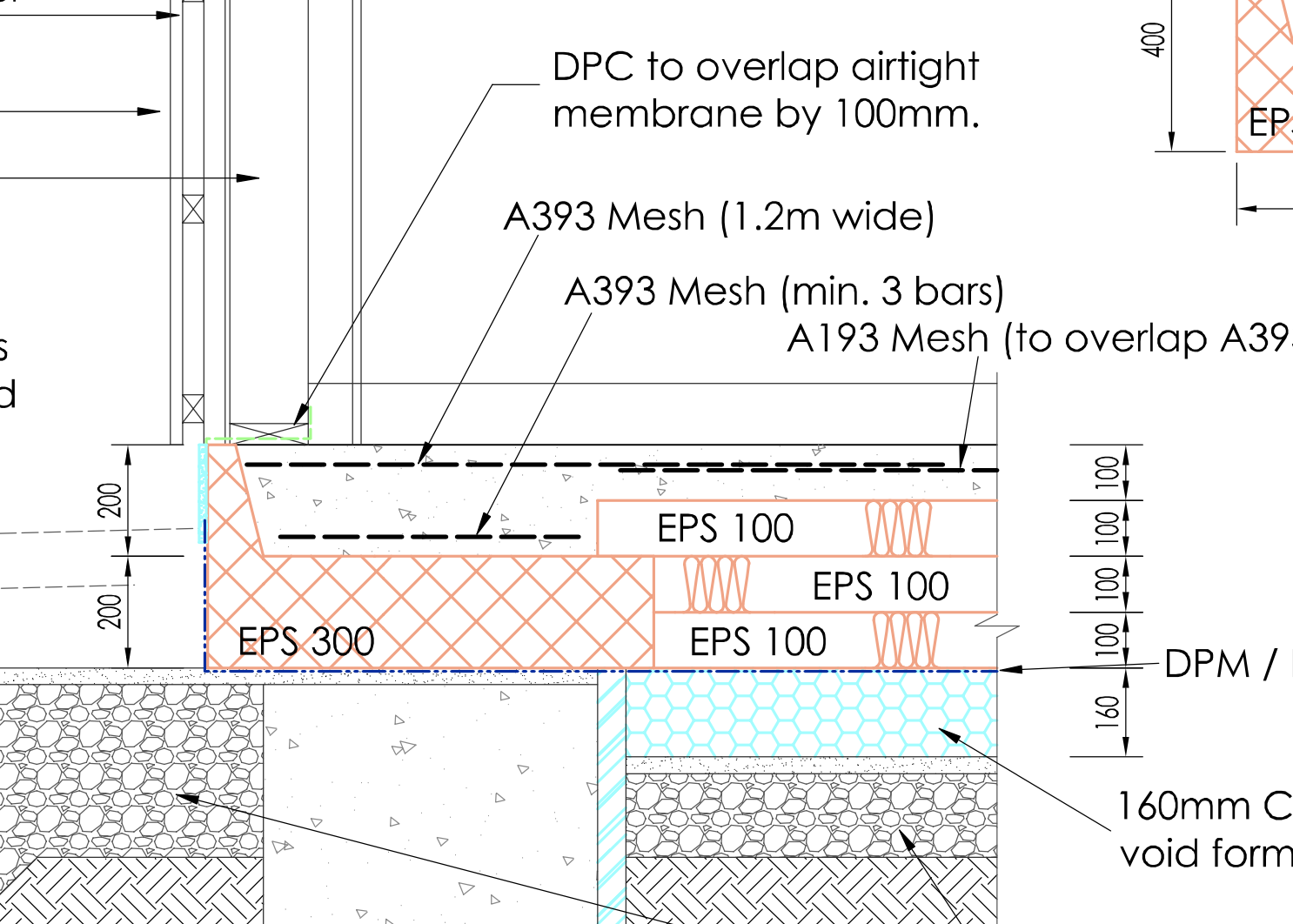

We are building an insulated warm raft slab for a timber framed building.
My groundworker is very good, dedicated, hard working etc. But, he has never built a raft foundation like this (image found on google and indicative only) :
Here's a site image of the prepared ground before the shuttering, DPM, insulation, mesh and concrete go in.
He's suggesting its much easier to do this without the 45degree slope on the inside and instead just have a right angle there even if he has to shutter both sides of the trench. He says, he wouldn't have to bend any mech or rebar.
He's also worried about having to cut the insulation at various angles and doesn't really have a plan yet for how he cuts the insulation at the corner - which will have to be mitred in two planes! - the 45 degree sectional slope and the 90 degree turn in plan.
I have two questions for the Guru's:
1. Can anyone with direct experience of building this type of foundation offer any tips on how to install the insulation with all the awkward cuts etc ?
2. This seems to be a pretty standard way of doing a raft slab. Yet, my groundworker is having real difficulty with it.
What do others with experience think of this method, should it be this tricky?
Thanks for any comments!

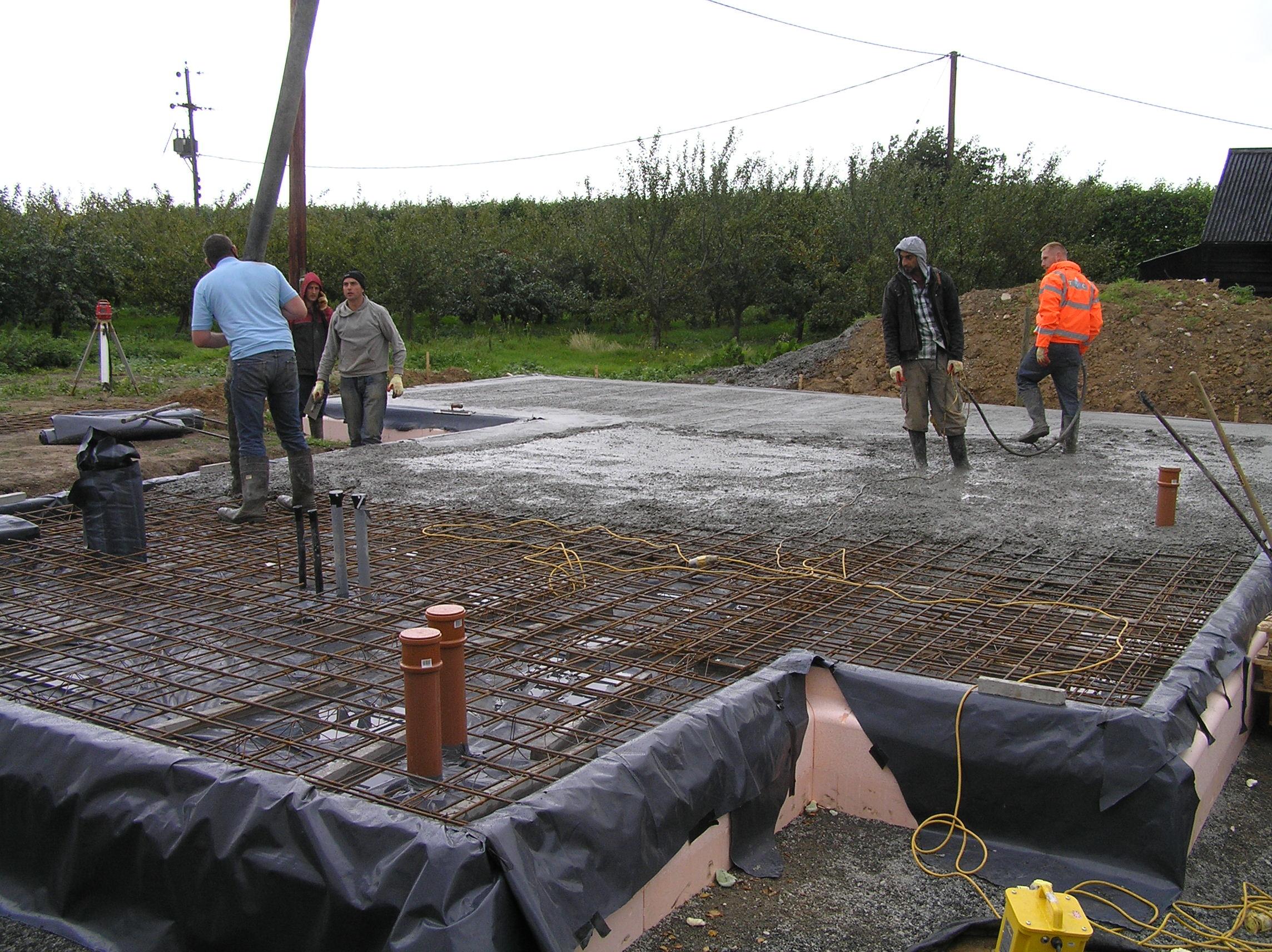

mine was designed by TSD (Tanners Structural Design) and had 90o insulation. in fact, where you have the raised area of hardcore/sand we just used more insulation. here's ours for reference.

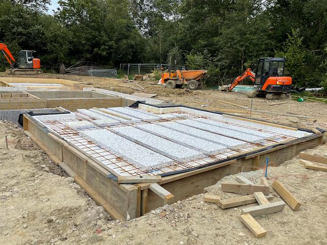

that above is using the Kore preformed insulation but our groundworkers just bought EPS300/EPS100 without the sloping former and cut it to fit on-site. photo below:
hope this helps and it's posted with the caveat that any changes to your foundation/slab design should be ratified by your structural engineer.

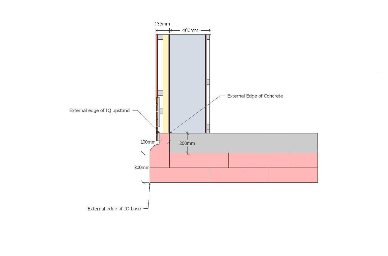

We used the Isoquick system which is preformed and slots together with vertical sides. The specific design is dependant on the site and your structural engineer should have provided drawings for your groundworkers.
