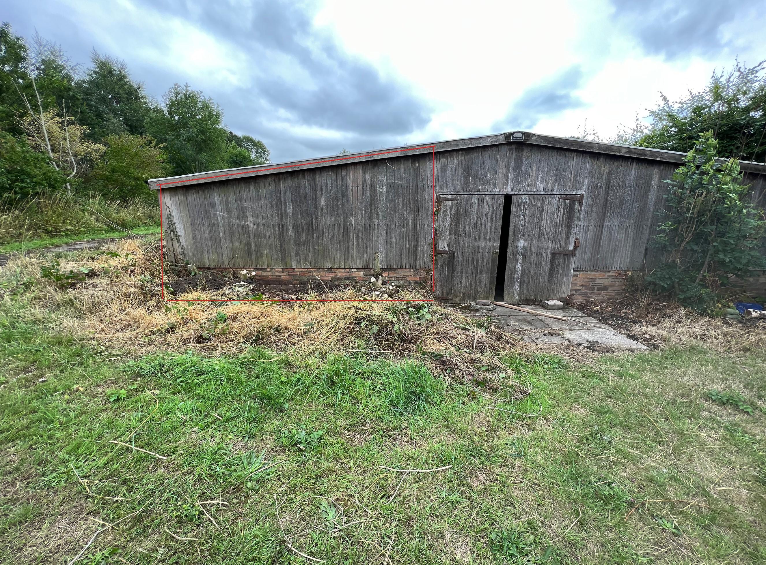

I am looking for the forum's advice on how best to approach converting a section of a large farm shed into an office. My house build is way behind schedule so I need to be on site, as Autumn / Winter approaches but I still need to focus on my main job and need an office to work out of.
The farm shed is about 30m x 12m, wooden framed with wood cladding, sitting on a single skin dwarf wall. The roof is metal ( not sure if steel or ali ) with a metal internal second skin with the thinnest sort of material insulation possible between.

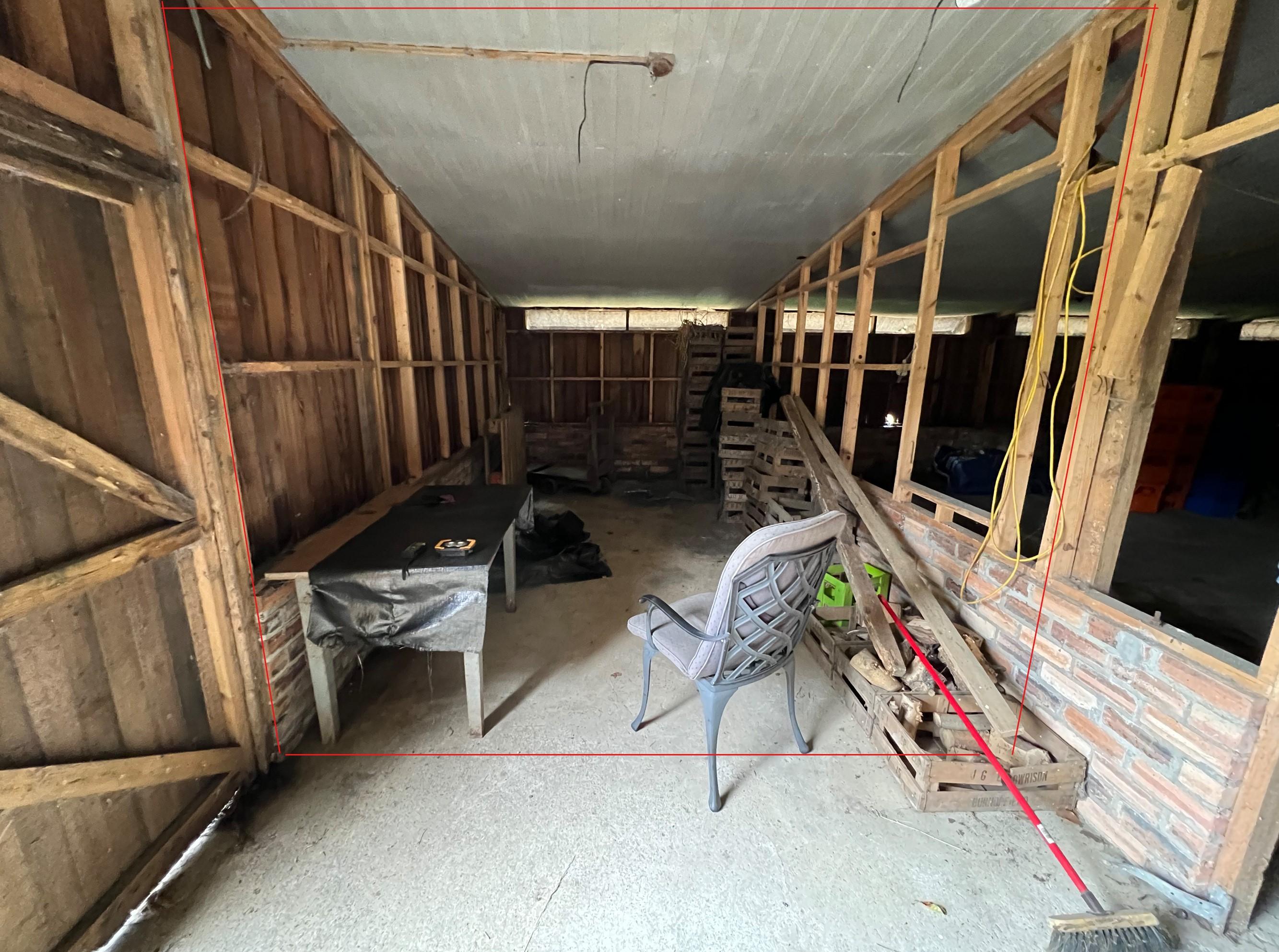

The first picture is the front with red markings showing the corner I intend to convert. The second picture is just inside the shed door and again has red markings showing the conversion area.  There is a 2m concrete path down the middle of the shed running top to bottom with a concrete floor on the first sections left and right of the main door.
I am thinking of utilising the left hand section with some sort of internal stud work but need to work out the best way to insulate the floor, walls and roof. I dont mind losing space to get good insulation levels, keeping heating costs down but I would look to possible have a small MVHR system and maybe even a window.

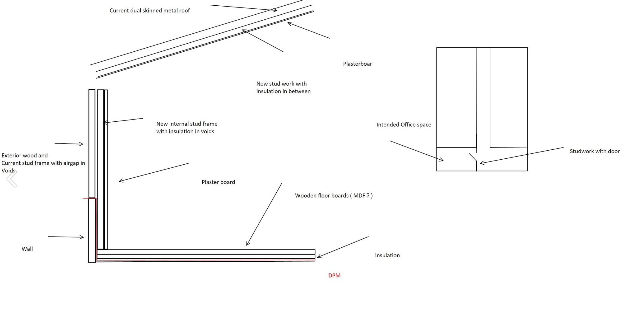

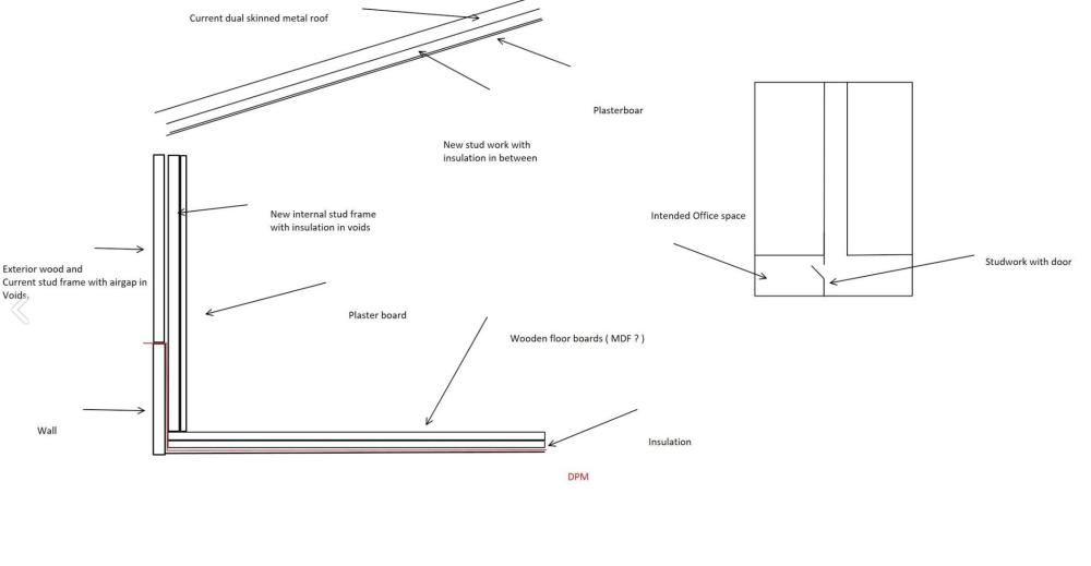

If it is not for seriously long term, how about turning those studs into Larsen Trusses (spaced studs) and filling with 300 cheapest-you-can-get mineral wool? If you are just wanting it to last a year don't even worry too much about VCLs and so on. You will have to do something to isolate the insulation from the (damp) plinth walls, but I would suggest don't do it with polythene (risk of condensation on the cold side of the 'sandwich'). I would definitely do a floating floor (say T & G OSB on 50 PIR) but then that will be 'dead money' unless you can find a late phase of your build in which you can re-use the materials. Are you going to insulate the ceiling/roof? Maybe that could be spaced studs too.
I don't think I would 'do' MVHR in this case  unless I found a really really cheap unit.

My biggest challenge is how to do the insulate the walls. As suggested above, I was going to go with board on PIR for the floor on a DPC ( not sure if that is the right way ) but for the walls I am not sure what the correct sequence is for airgaps, insulation, breathable membrane and paster board. I guess the same question for the roof. I have drawn up my intial idea but would love to hear people's views.
