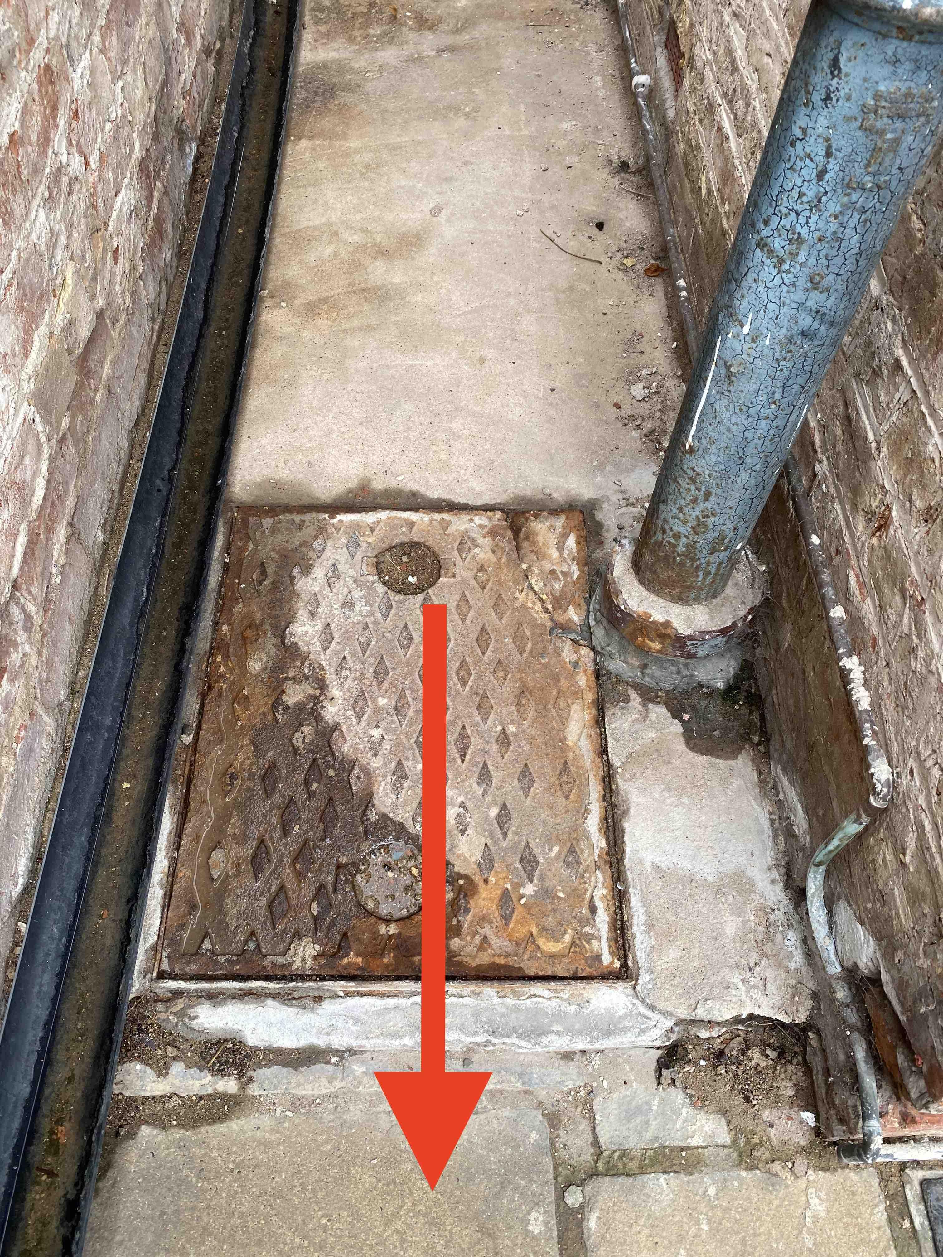

jayc89 Posted July 25, 2022 Share Posted July 25, 2022 I have an old SVP that takes waste from a bathroom and empties it directly into a manhole that goes into mains sewerage. This manhole is at the corner of the house, where we have a damp patch on the internal wall. I'm pretty sure the SVP/manhole is leaking. I want to replace the existing SVP and manhole with a new SVP, but in order to connect it to the existing underground pipe, I'll likely need a rest bend directly connected to a 90 degree turn - it's pretty tight. Would this be ok? I don't fancy digging up half the garden (yet) just to replace some drainage pipes. Link to comment Share on other sites More sharing options...
markc Posted July 25, 2022 Share Posted July 25, 2022 If you are replacing and it has been ok for years then there should be no reason for concern. in an ideal world you can do anything but site restrictions often mean compromises. Link to comment Share on other sites More sharing options...
Conor Posted July 25, 2022 Share Posted July 25, 2022 Not ideal. Do you have room for 2x 45° bends with a short length of pipe between? If you're replacing the MH can you not move/rotate a bit? Any photos? Link to comment Share on other sites More sharing options...
jayc89 Posted July 25, 2022 Author Share Posted July 25, 2022 There's not much room for anything. I'm a little worried a rest bend + 90 degree bend won't fit... Arrow shows the flow of the underground waste pipe. Link to comment Share on other sites More sharing options...

CAdam Posted July 31, 2022 Share Posted July 31, 2022 Is that damp patch the piece on the right lower wall? To me it looks above ground. Rising damp should not penetrate if the is a damp proof course. Either there is none of the leak is above ground. You can replace the stack above ground quite easily using either a soil socket for iron or a rubber sleeve. Depending how sever the damp is, look at either, liquid dpm, tanking and stainblock internally. Link to comment Share on other sites More sharing options...
