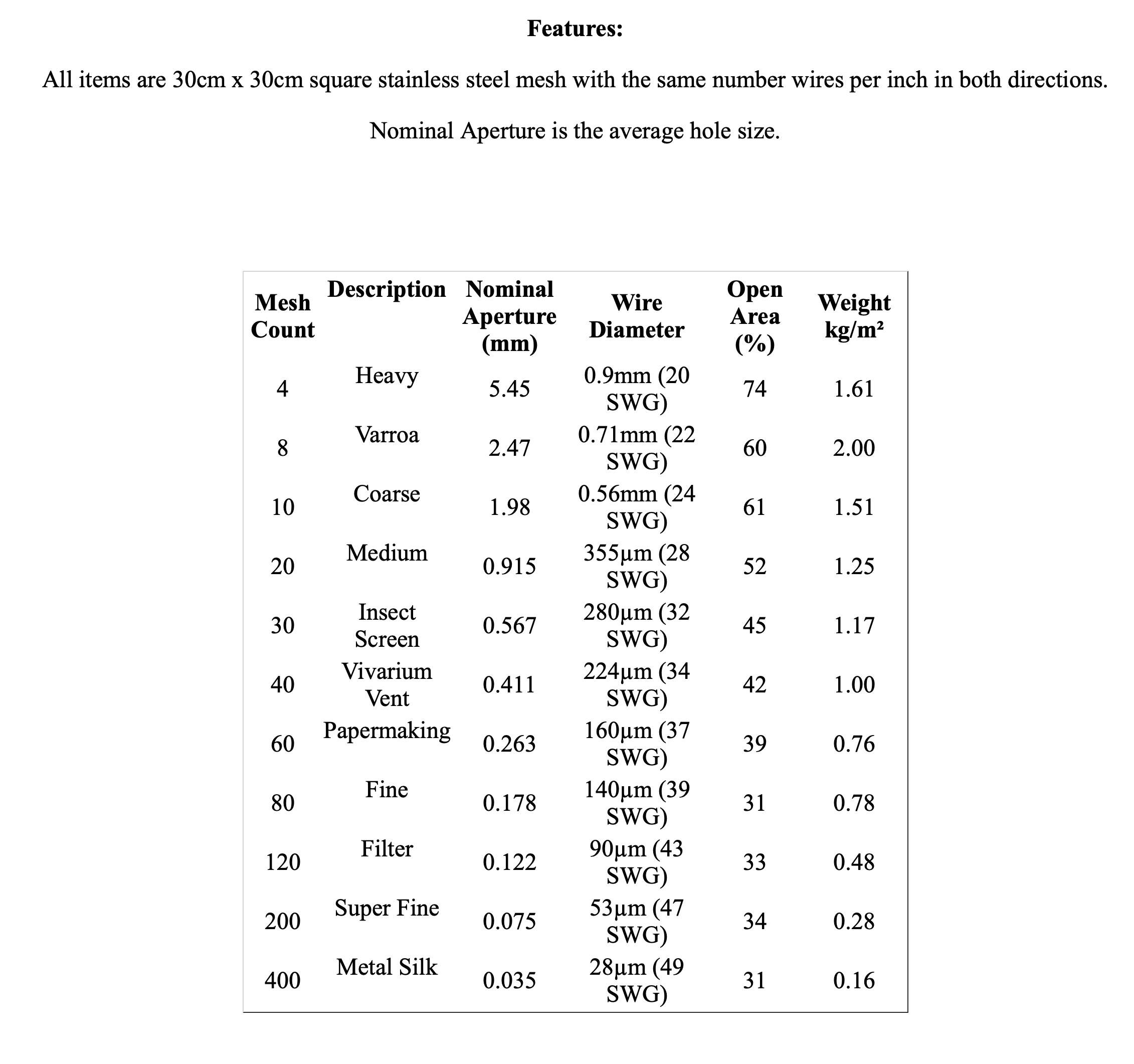

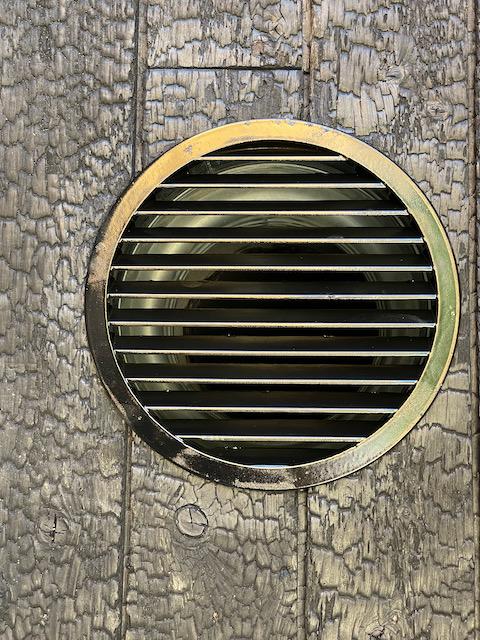

Thorfun Posted July 24, 2022 Share Posted July 24, 2022 greetings. I have fitted the supplied Lindab 250mm grills to our MVHR intake and exhaust vents and it seems apparent that maybe I should put some insect mesh behind them as it sure does look very open for insects and spiders etc to find their way into the system. the 250mm grills attach to a 250mm -> 200mm reducer and then we have 200mm ducting to the Zendher Q600 unit. I was wondering what size mesh would be best to not limit the air intake/exhaust but that would be effective in stopping insects entering and setting up home somewhere in the system. I found an eBay site that offers woven stainless steel mesh in the following mesh size. I'm thinking the 20 mesh count with a 52% open area would definitely stop insects but is that too restrictive? maybe the 10 mesh count would be better but at 2mm average hole size it seems large enough to let insects in? anyone got any suggestions/recommendations/comments? Link to comment Share on other sites More sharing options...

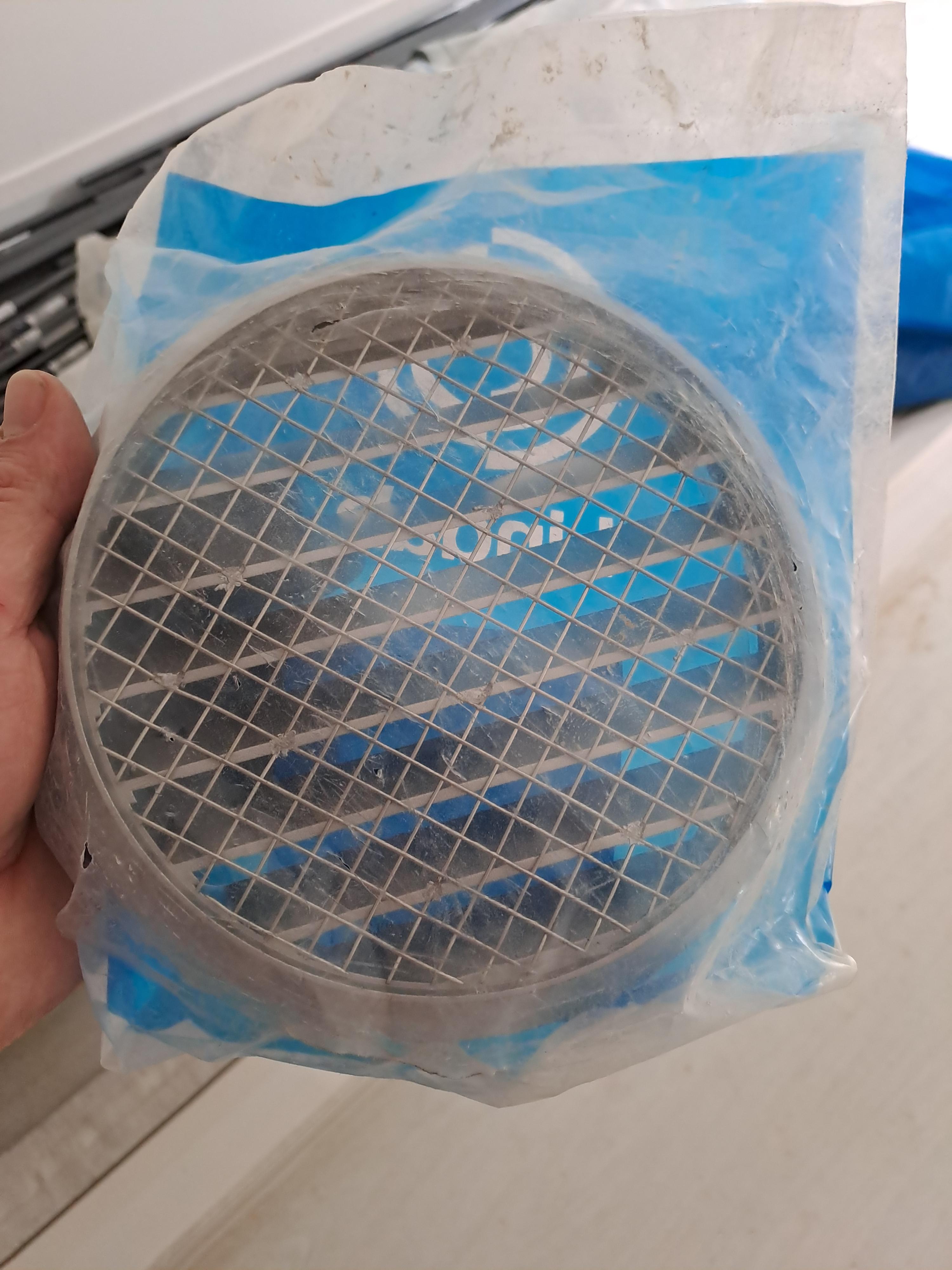

Conor Posted July 24, 2022 Share Posted July 24, 2022 There should be mesh on them. There is on mine. Speak to lindab in case it's a mistake. 1 Link to comment Share on other sites More sharing options...
Thorfun Posted July 24, 2022 Author Share Posted July 24, 2022 11 minutes ago, Conor said: There should be mesh on them. There is on mine. Speak to lindab in case it's a mistake. interesting and thanks. I will speak to Linda. that looks rather large mesh openings though, not sure if that will stop any form of insect though will it? Link to comment Share on other sites More sharing options...
JohnMo Posted July 24, 2022 Share Posted July 24, 2022 Mine has about 4 to 6mm mesh openings. Did read somewhere that if it has a fine mesh it should be removed. 1 Link to comment Share on other sites More sharing options...
Thorfun Posted July 24, 2022 Author Share Posted July 24, 2022 ps. I can't take them back now as I've painted them black! so I might just have to bite the bullet and purchase my own mesh. Link to comment Share on other sites More sharing options...
Conor Posted July 24, 2022 Share Posted July 24, 2022 1 minute ago, Thorfun said: interesting and thanks. I will speak to Linda. that looks rather large mesh openings though, not sure if that will stop any form of insect though will it? Nope. My filter gets cleared out regularly. Link to comment Share on other sites More sharing options...
Thorfun Posted July 24, 2022 Author Share Posted July 24, 2022 Just now, JohnMo said: Mine has about 4 to 6mm mesh openings. Did read somewhere that if it has a fine mesh it should be removed. thanks. I found this thread on here where @Gone West was purchasing 1.67mm mesh and it was deemed that wasn't an issue. that's why it's all so confusing, there seems to be much conflicting information out there. Link to comment Share on other sites More sharing options...

Gone West Posted July 24, 2022 Share Posted July 24, 2022 23 minutes ago, Thorfun said: that was my other option, forget about the mesh and just clean out the filter more regularly! Where are your vents fitted? I fitted ours in a position where it was easy to brush them off two or three times a year. The insect screens worked well but the important thing is that the mesh open area is sufficient for the vent size and duct cross sectional area so there isn't any reduction in flow rate. Link to comment Share on other sites More sharing options...

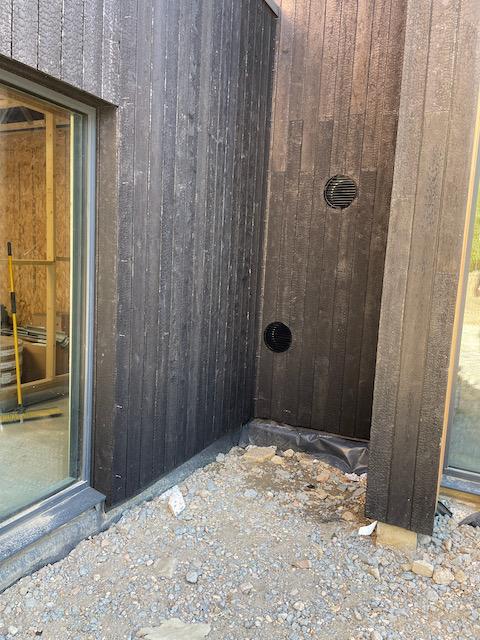

Thorfun Posted July 24, 2022 Author Share Posted July 24, 2022 3 minutes ago, Gone West said: Where are your vents fitted? I fitted ours in a position where it was easy to brush them off two or three times a year. at the front of the house between the front door porch (which is the to right in the photo below) and the side door (the glazing at the left of the photo). so access is pretty easy. 6 minutes ago, Gone West said: The insect screens worked well but the important thing is that the mesh open area is sufficient for the vent size and duct cross sectional area so there isn't any reduction in flow rate how do you begin to calculate that? Link to comment Share on other sites More sharing options...
Gone West Posted July 24, 2022 Share Posted July 24, 2022 2 minutes ago, Thorfun said: how do you begin to calculate that? Now you're asking. I'll have to try to remember how I did it. IIRC I worked out the area of the duct, which in my case was quite small, so I didn't want to restrict the flow at all. I then made a square cover, as in the original thread, which was larger than the duct, which when multiplied by the open area of the mesh gave at least as much area as the duct. Link to comment Share on other sites More sharing options...
