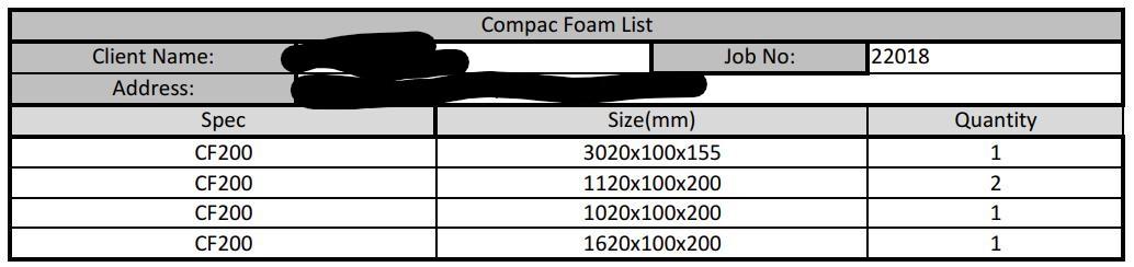

markharro Posted October 21, 2022 Share Posted October 21, 2022 I am being quoted £1000 for Compacfoam 200 for our passive slab by the installer - quantities in the attached image. Can anyone advise whether its likely I would make much saving on the price by sourcing from GBS myself? Or would one of these other products be cheaper and the same spec? thanks Link to comment Share on other sites More sharing options...
JohnMo Posted October 21, 2022 Share Posted October 21, 2022 When I bought my compacfoam, I bought from GBS, was cheapest at the time. Link to comment Share on other sites More sharing options...
