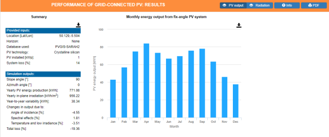

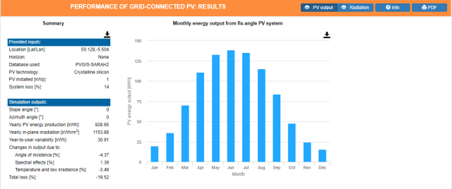

SteamyTea Posted July 17, 2022 Posted July 17, 2022 Module orientation and altitude is important, especially for winter generation. Module power is proportional to the product of both the altitude and the azimuth. Energy is the product of the mean power and the hours of daylight. So two extreme examples, with a south facing, 1 kWp array. First is laying flat to the ground, second is 90° to the ground. Very big difference in winter generation.

SteamyTea Posted July 17, 2022 Posted July 17, 2022 On 17/07/2022 at 17:09, Temp said: So does that suggest a 6kW load needs at least a 30kW solar array Expand Depends on the angles. If, down here, a 1 kW array can produce 38 kWh a day in December, that implies a 6 kW, south facing, vertical array will do. My current usage is 3 kWh a day at the moment. That will go up to about 20 in December and January.
