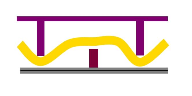

Temp Posted July 7, 2022 Share Posted July 7, 2022 If you can, consider two lots of studs one for each side of plasterboard with insulation loose fitted between. Sometimes floors done this way. Not really to scale.. Link to comment Share on other sites More sharing options...

low_and_there Posted July 7, 2022 Author Share Posted July 7, 2022 2 minutes ago, Temp said: consider two lots of studs one for each side of plasterboard with insulation loose fitted between. Sometimes floors done this way I can’t (or rather don’t want to!) rebuild the studs, but what if I alternate the verticals and/or horizontals that I secure the SoundBloc on each side to..? They’re at 400mm centres horizontally, 600mm vertical. Link to comment Share on other sites More sharing options...
