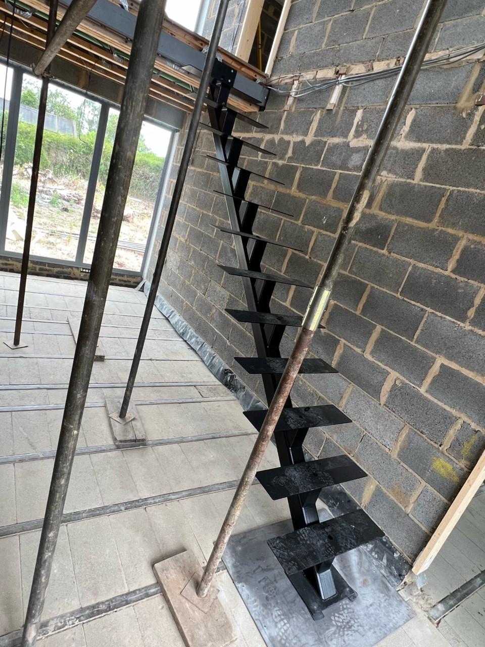

James94 Posted July 4, 2022 Posted July 4, 2022 (edited) I'm a little concerned about my 2 way lighting will it work? There will be a pair of switches one to operate the stairs and one to operate the vaulted section. It will be AC 2 way switch top and bottom of stairs going to a driver and some sort of controller for both. (Lights will be rgbw) We have had the steel stairs fitted yesterday and not sure how the cables will route to each treds, has anyone done something similar and how best to control them I'm not looking for a pir sensor system just using switches. Regards James Edited July 4, 2022 by James94
TonyT Posted July 4, 2022 Posted July 4, 2022 It’s outside traditional cable zones, so either earthed metal conduit or cable with a metallic sheath..
Carrerahill Posted July 4, 2022 Posted July 4, 2022 (edited) Ignore the 2 way switching, that is irrelevant to the stair wiring and all happens before the drivers. Let the electrician sort the switching and feed to the drivers. The RGBW LED's will be SELV so they will be run in on some multicore, so locate the drivers remotely and run the low voltage wiring out to the LED's. This also means you are not having to hide drivers etc. etc. and makes them easier, if you put them somewhere sensible, to access for maintenance & replacement. How to control them, I don't know what you want to do? Personally I would just fit some warm white LED's and be done with it, maybe your creating a fairground though? If just a warm white LED detail then just switch it, and you can pre-set your dimming, or add them to a dimming circuit. However, I assume it is just some ambient deorative light, in which case a nice glow would work well. RGBW control will require an scene controller, or a wireless app type thing. When done commercially it is usually paired up with a dimming system, I usually use Mode systems. In a domestic setting you could use Lutron kit for quality, but most of this ends up being the little scene wheels or LCD screen. All becomes a pain in the backside. Edited July 4, 2022 by Carrerahill
James94 Posted July 5, 2022 Author Posted July 5, 2022 @TonyT @Carrerahill Sorry for the late reply, had a shit time when the plasterers came round and ripped into my work and I was so looking forward to them arriving. On 04/07/2022 at 12:31, Carrerahill said: Ignore the 2 way switching, that is irrelevant to the stair wiring and all happens before the drivers. Let the electrician sort the switching and feed to the drivers. Thanks that's one part to forget about then, The driver will be in a upstairs bedroom on top of a wardrobe for future proof. I would like to have an option for colour so I'm opting for RGBW, I know this might complicate things but I'm having RGBW on some plaster in trims in vaulted section too so want them to be able to match. Can you help with options for wiring maybe a simple diagram on how to get the 5 core flex from driver to the 12 treads and what is the best scene controller to use. I don't want anything fancy just be able to switch them on and off with switches and a colour changing system. Regards James
Nickfromwales Posted July 5, 2022 Posted July 5, 2022 (edited) 25 minutes ago, James94 said: Sorry for the late reply, had a shit time when the plasterers came round and ripped into my work and I was so looking forward to them arriving. That sucks. Pull them into line early on, and remind them that you’re the customer. If you don’t gel with them, it’s time to get rid. For control, I’d go with something dead simple and robust, like Phillips Hue. You can put one of these…. https://www.philips-hue.com/en-gb/p/hue-tap-switch/8719514440999?origin=p70750597731&gclid=CjwKCAjwwo-WBhAMEiwAV4dybbII5hoxKPkNnTbYT7B8JOgZ_6bYAIChcNuD258EG2g72nzzeUJsshoCMJ4QAvD_BwE&gclsrc=aw.ds at the top and bottom of the stairs, or anywhere else, are fully wireless and can do scenes and dimming plus basic on / off. Plug n play, job done. As far as getting cables around, it’ll be a simple job of drilling holes and fishing cables here / there. A thin ‘ribbon’ type cable will be ample, but will all likely need soldering and gear-shrinking. A good electrician should do this in his sleep, but you may also do well to check with the staircase manufacturers to see where it’s best to do this. May save a lot of unnecessary labour / time if you snd the sparky have some help / insight Edited July 5, 2022 by Nickfromwales

James94 Posted July 6, 2022 Author Posted July 6, 2022 @Mr Punter Did think about that but think that might of caused other issues as some of the insulation we was able to fit flush and some wasn't. so decided to take the front off where it was needed that way all flush with the studs, its been an absolute nightmare. Still unsure about the 5 core cable from the bedroom to the stairs, do you know if we have to run a 5 core from bedroom to each individual tread or just daisy chain from first through to 12th tread ? Regards James
