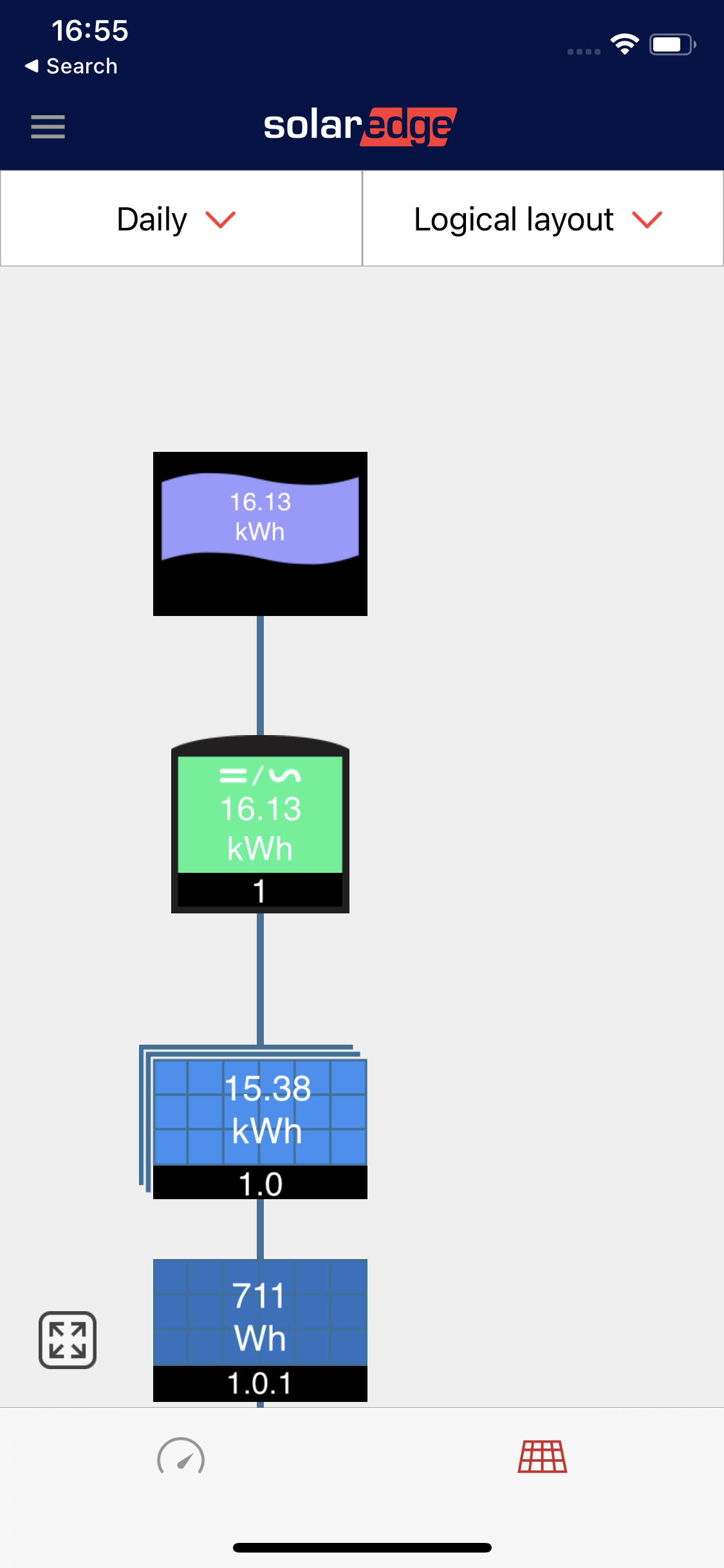

Pocster Posted July 2, 2022 Author Share Posted July 2, 2022 2 minutes ago, Radian said: It depends on the way it's all put together. Hopefully there's a DC path between the PV module array and batteries without going via the inverter's AC output in which case the full power of the array would be available for battery charging - minus any load on the AC output of course. I hope so . It’s hard to test . At some point I might turn the PW off just so I can drain the SE on a solar day . Then ( assuming PV generation is greater than 3.66kw ) I can gauge how fast it charges . Really wish the apps showed ‘real ‘ PV DC generation Link to comment Share on other sites More sharing options...
Pocster Posted July 2, 2022 Author Share Posted July 2, 2022 @Radian so is this showing me my daily amount ( so far ) is 16kwh of DC ?? I.e at source ( pv panel ) generation Link to comment Share on other sites More sharing options...
Pocster Posted July 2, 2022 Author Share Posted July 2, 2022 1 minute ago, pocster said: @Radian so is this showing me my daily amount ( so far ) is 16kwh of DC ?? I.e at source ( pv panel ) generation Actually that’s not correct is it ? ( my understanding I mean ) not the screen grab Link to comment Share on other sites More sharing options...
Radian Posted July 2, 2022 Share Posted July 2, 2022 5 hours ago, pocster said: Actually that’s not correct is it ? ( my understanding I mean ) not the screen grab Not sure. Looks a bit like the display on this app to me: Link to comment Share on other sites More sharing options...
