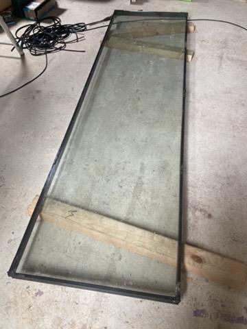

Dreadnaught Posted June 29, 2022 Share Posted June 29, 2022 In this photo you can see the glazing unit from one my Danish IdealCombi windows. Its from a window that Idealcombi replaced as the frame was broken during delivery. The glazing unit is fine. Wondering if I can mount it as an internal window in my build. Any thoughts about how I could make a frame for it and mount it horizontally securely within the wall? I am going to have MF walls (70mm studs). I can create the opening for it quite easily in the MF wall, like that for a door, with a reinforced MF beam above and below the window. That's the easy bit. Any ideas? The unit is triple glazed, 620 x 2220 mm … Link to comment Share on other sites More sharing options...

Bozza Posted June 29, 2022 Share Posted June 29, 2022 Surely just using beading and packers in a frame, like any window? Or am I missing something? 1 Link to comment Share on other sites More sharing options...
MikeSharp01 Posted June 29, 2022 Share Posted June 29, 2022 Make sure it's appropriate toughened if people could run / fall / lean on it. Link to comment Share on other sites More sharing options...
Dreadnaught Posted June 29, 2022 Author Share Posted June 29, 2022 5 minutes ago, MikeSharp01 said: Make sure it's appropriate toughened if people could run / fall / lean on it. Thanks yes, its both toughened and laminated (outer pane) 👍 Was going to be a ground-floor window within 800mm of the ground before being bashed in transit. Link to comment Share on other sites More sharing options...
craig Posted July 2, 2022 Share Posted July 2, 2022 Standard frame, packers (5mm) and then some beading around that. We do this kind of stuff often, customers just wanting glass to go into preformed openings with oak frame building's for example and not wanting the frames of the windows. 1 Link to comment Share on other sites More sharing options...
