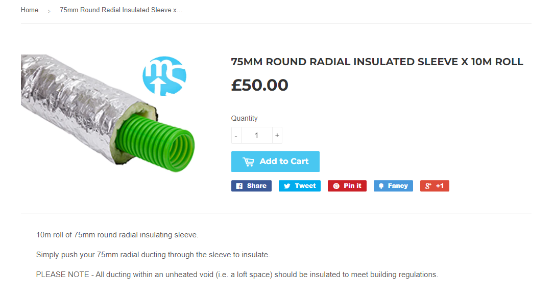

Arnold9801 Posted June 28, 2022 Author Share Posted June 28, 2022 8 hours ago, James94 said: Might be worth insulating all ducting too if its a cold roof space, this might prevent some condensate. What insulation is best? Link to comment Share on other sites More sharing options...
Iceverge Posted June 28, 2022 Share Posted June 28, 2022 This would work. If you can get extract fans that run constantly at a low level. You'll have better internal air quality and less noise. Link to comment Share on other sites More sharing options...
