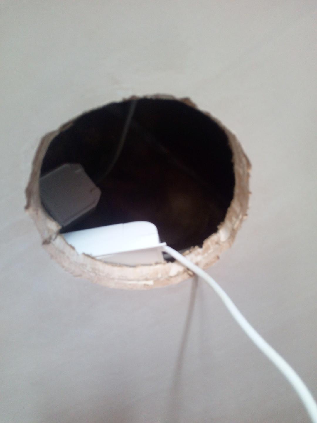

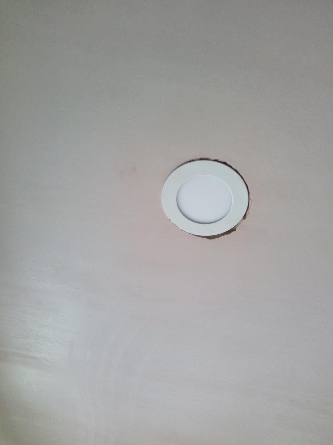

Thanks for response.  The electrician fitted new lights removing olds one of a different model.   I think the holes were slightly too large, but the outer edge of the lights were resting at the bottom of the ceiling.
The plasterers removed the lights, and plastered the ceiling.  They plastered over an old ceiling.
Now, the lights do just above fit into the hole, but the holes appear to be wider.  The inner of edges of the holes look as if they have been cut by the same person.   If I carefully position the lights, then they don't fall inside the hole and they look close to being correct - their outer edges lie just below the bottom of the ceiling.
See photo of current situation after carefully adjust position of light, and the hole (on the left hand side, it looks like there is a cut leaving a ridge on both the ceiling and plaster).
I am not sure, but I think the ceiling was just plasterboard.
Any advice on this and how to resolve would be very welcome.

You can buy downlight hole repair rings - search amazon / Ebay - not sure if I could put up with how they look and if its only one then it would odd - how many light fittings in the room? can you fit bigger ones?

If the gap is very small then you can patch in the sides of the hole by say 2mm, using filler or plaster. That might just work with your non-circular holes.
How the unit clips in may, or may not, work with that.
Or As above find repair rings.
Or there are optional bezels, for appearance but would also perform this repair function.
The trouble with the last 2 is whether your light would fit through the bezel.
Or buy a new light that fits the hole. the hole not being round isn't helping choose a size.

How many of them are "wrong"?  the one pictured that is too large, looks like it has been sawn larger probably with a pad saw, post plastering?  Was that the plasterer trying to clean out the plaster that had partly filled the hole?  Understanding exactly what happened helps pin the blame.
some lights have a larger bezel than others so are more forgiving.
Link to comment
Share on other sites
All four are wrong  (for one, the hole is just too small).  There are also three others but the lights and holes are all smaller and they are all fine.  The smaller ones have the same style as the bigger ones.  So we want to keep them all.
