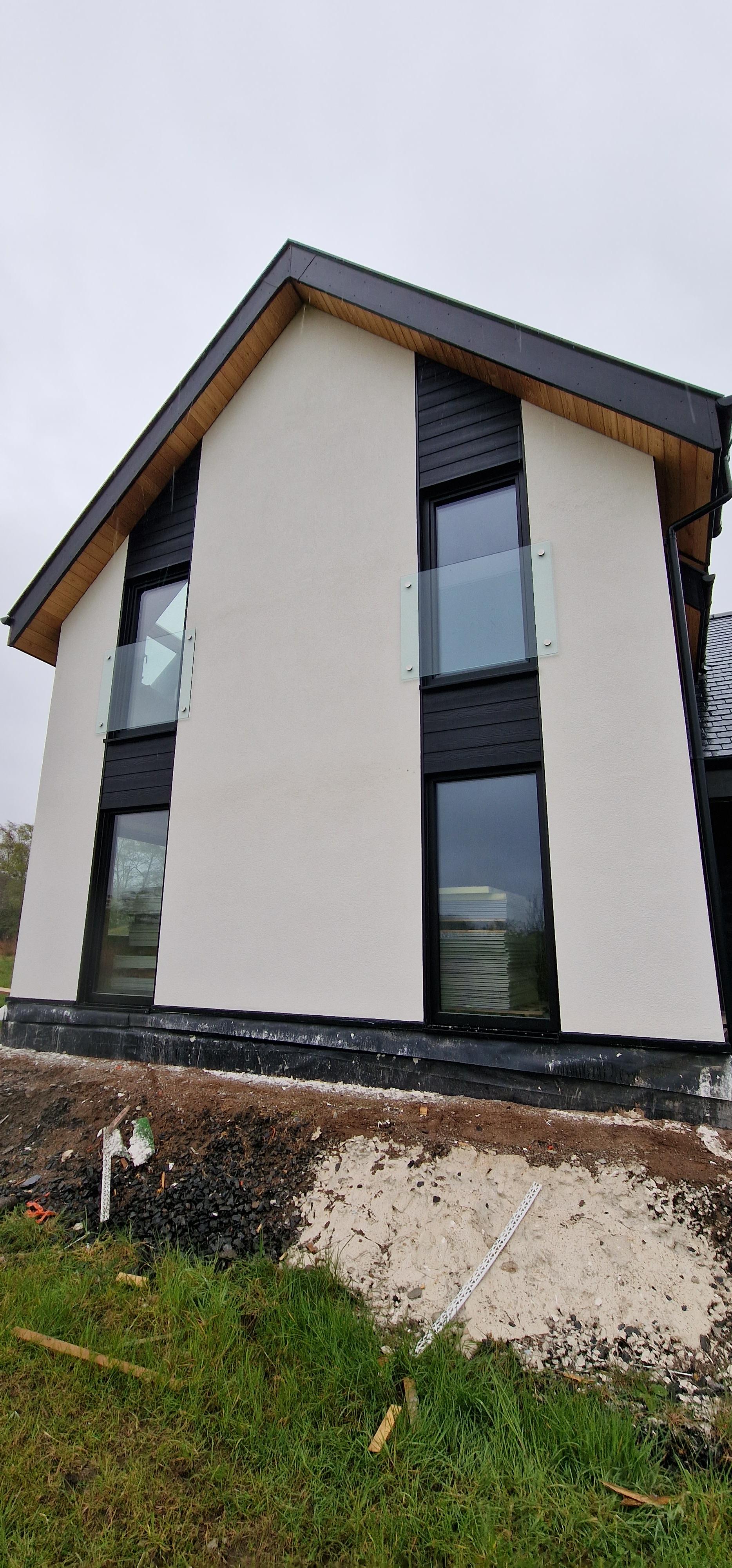

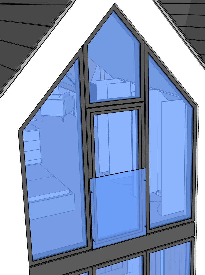

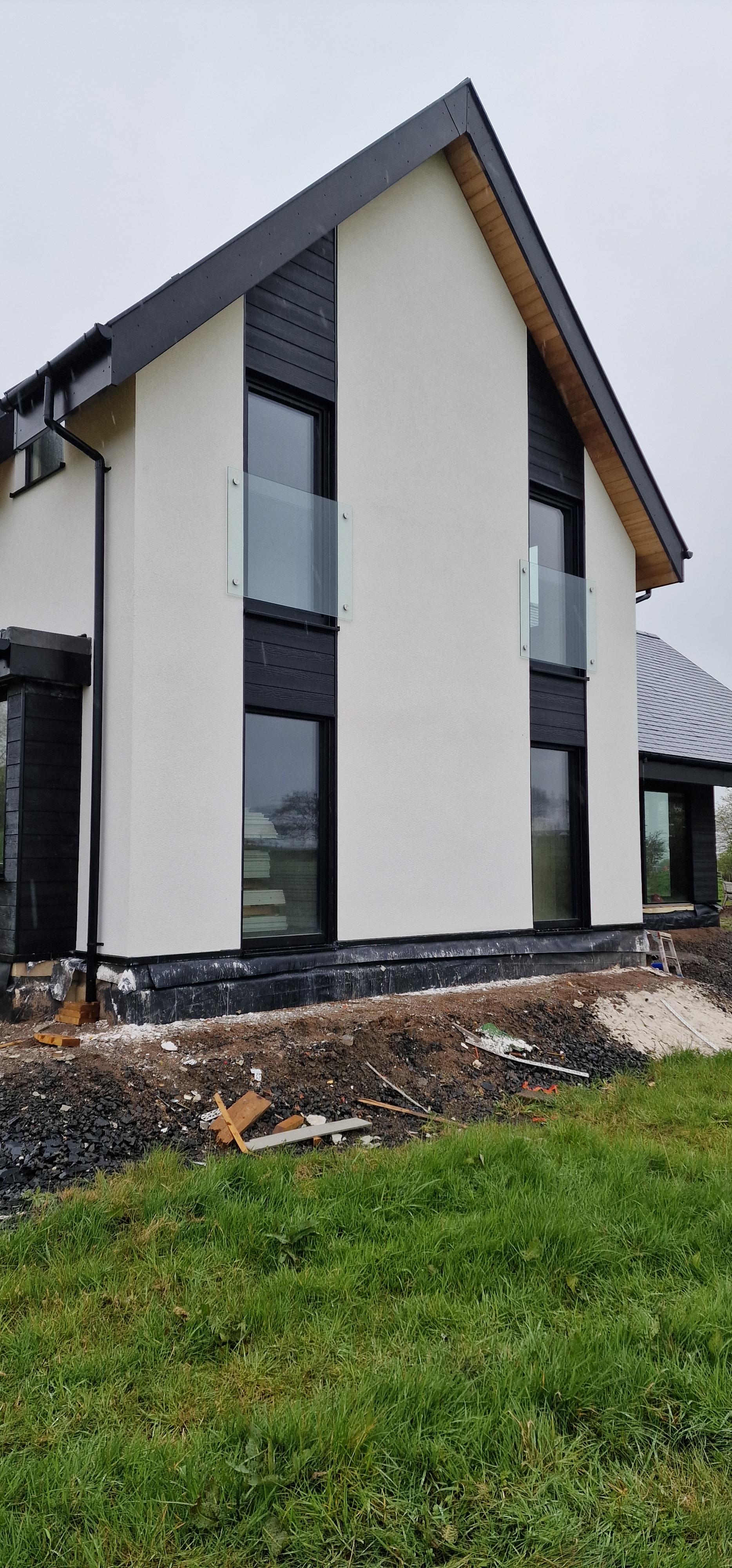

Hilldes Posted June 21, 2022 Posted June 21, 2022 (edited) Hi all, I'm getting quotes for a glass balustrades for each of my three glazed gables - as in pic... This balustrade glass fixes to the frame of the door in the central section using fixings supplied by the window manufacturer. Four holes for each piece of glass. The Juliet the door opens in. I have a quote from a local glazing company... "17.5mm Clear toughened and polished edges laminated together with an external grade interlayer and holes as per diagram 3 @ 906mm x 1100mm - £1250.38+vat" The price seem high to me - what is your view please? Anything in the specification that is not necessary - e.g. I would have assumed that 10mm toughened and laminated glass would suffice for this relatively small area. Thoughts appreciated... Edited June 21, 2022 by Hilldes

Hilldes Posted June 25, 2022 Author Posted June 25, 2022 One of the two extra quotes came back as £638 inc VAT (which includes delivery at £96 so £544 for glass inc VAT). This is for 10mm glass which is what I specified in the drawing. I have asked of this is toughened and laminated as I specified. The first (expensive) quote though stated that because this glass is installed without a handrail, this will need to be toughened laminated and 13.5mmm or 17.5mm thick. They had quoted for 17.5mm and said they could quote for 13.5mm but that would be around the same price. Third quote awaited. They have suggested changes to the drawing because I had specified holes 17mm from the edge of the glass - which apparently increase risk of cracking in the tempering process. So recommend holes min 50mm from edge of glass.
Hilldes Posted June 25, 2022 Author Posted June 25, 2022 @SuperJohnGAre your fixings going into render board?
Hilldes Posted July 7, 2022 Author Posted July 7, 2022 An update for anyone specifying and purchasing similar. I got two further quotes from the suppliers linked above. Order placed with one of them for £760 including delivery. The local company I got the first quote from was not interested in competing with the other quotes. On the specification, the consensus of all three suppliers was that 13.5mm toughened and laminated glass would be required where no handrail is fitted. Also the holes need to be a minimum of 1.5 x hole diameter from the edge. 1
