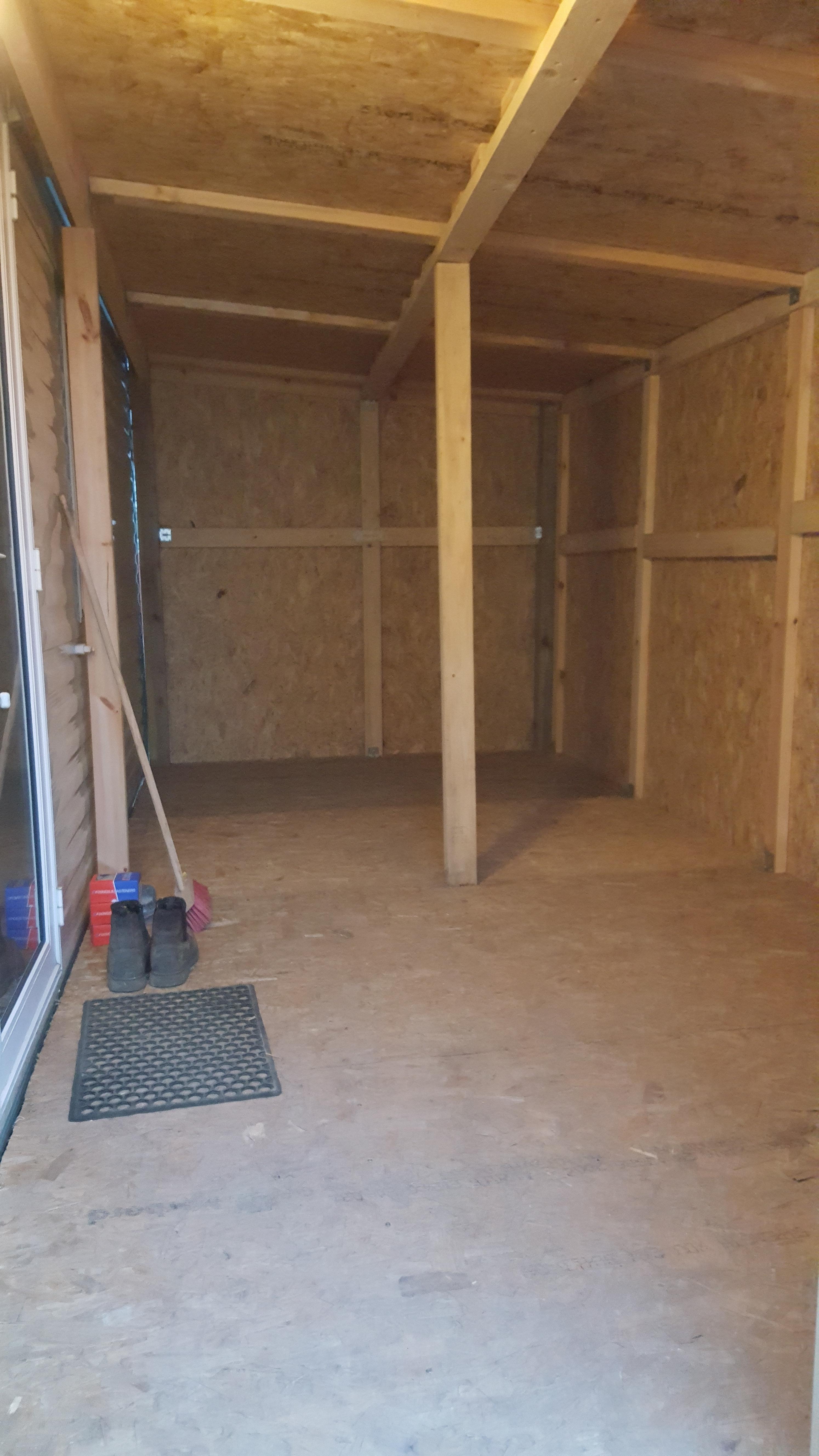

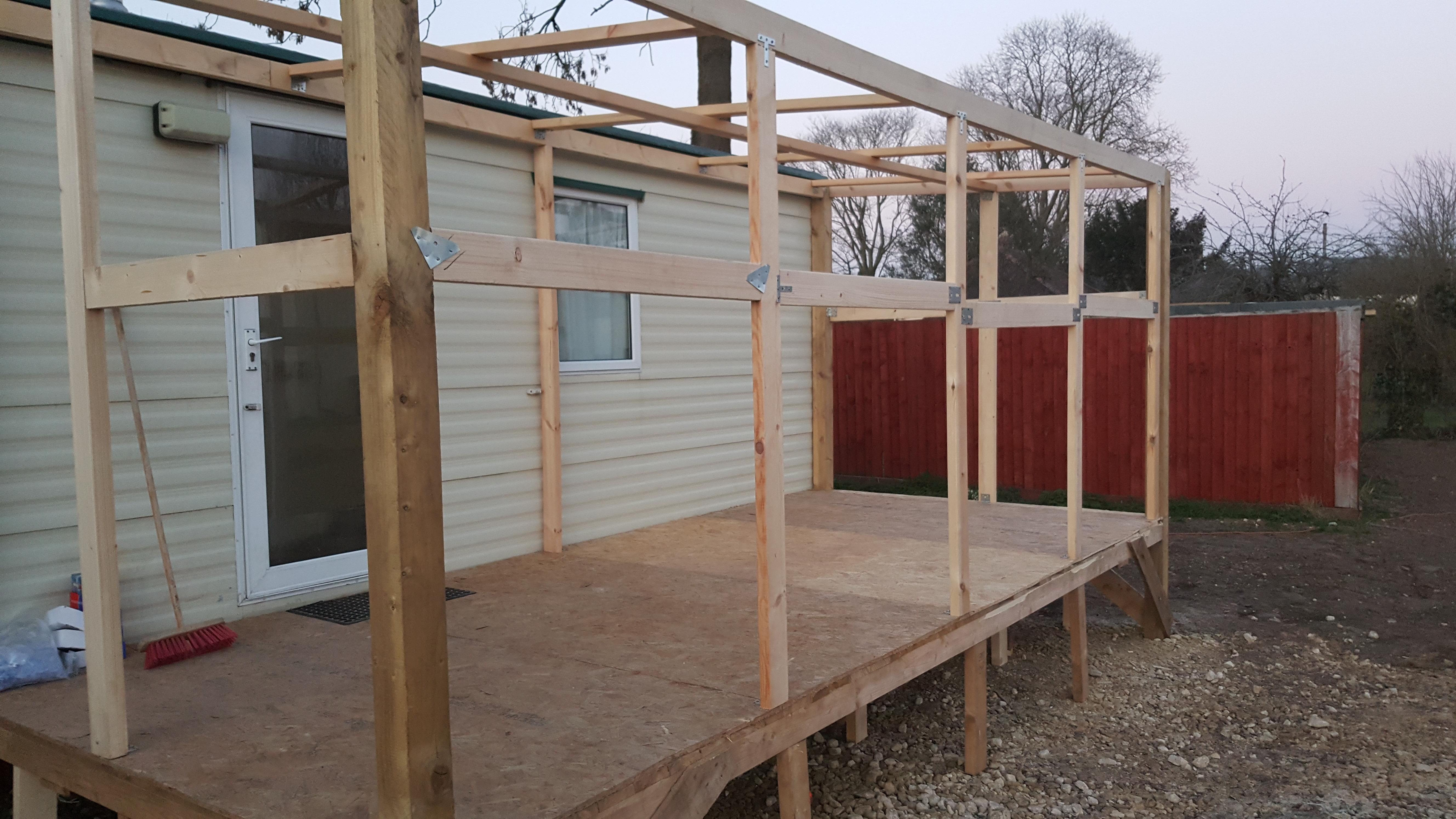

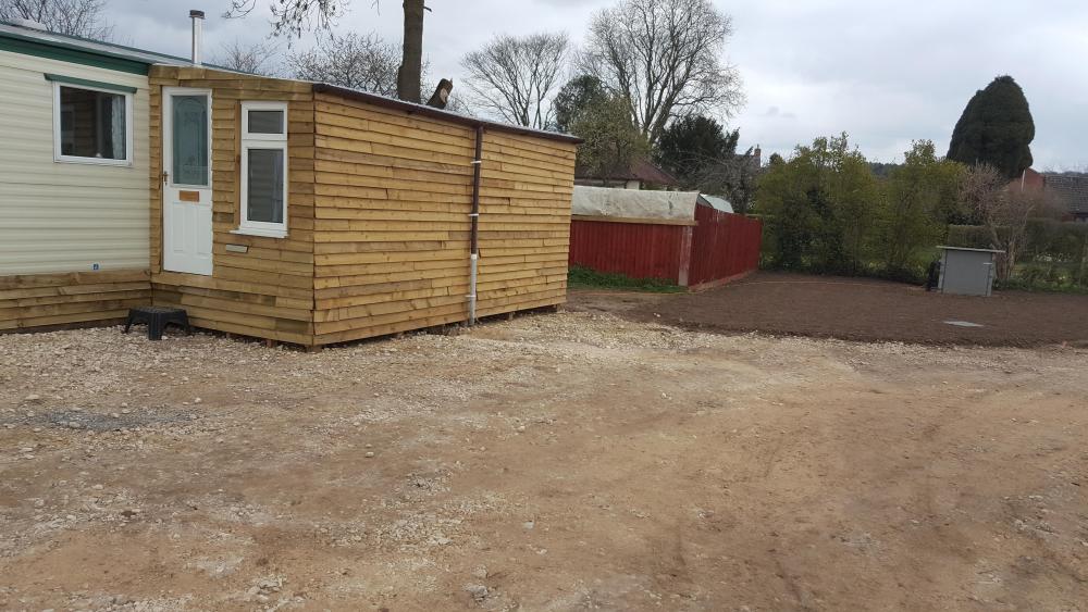

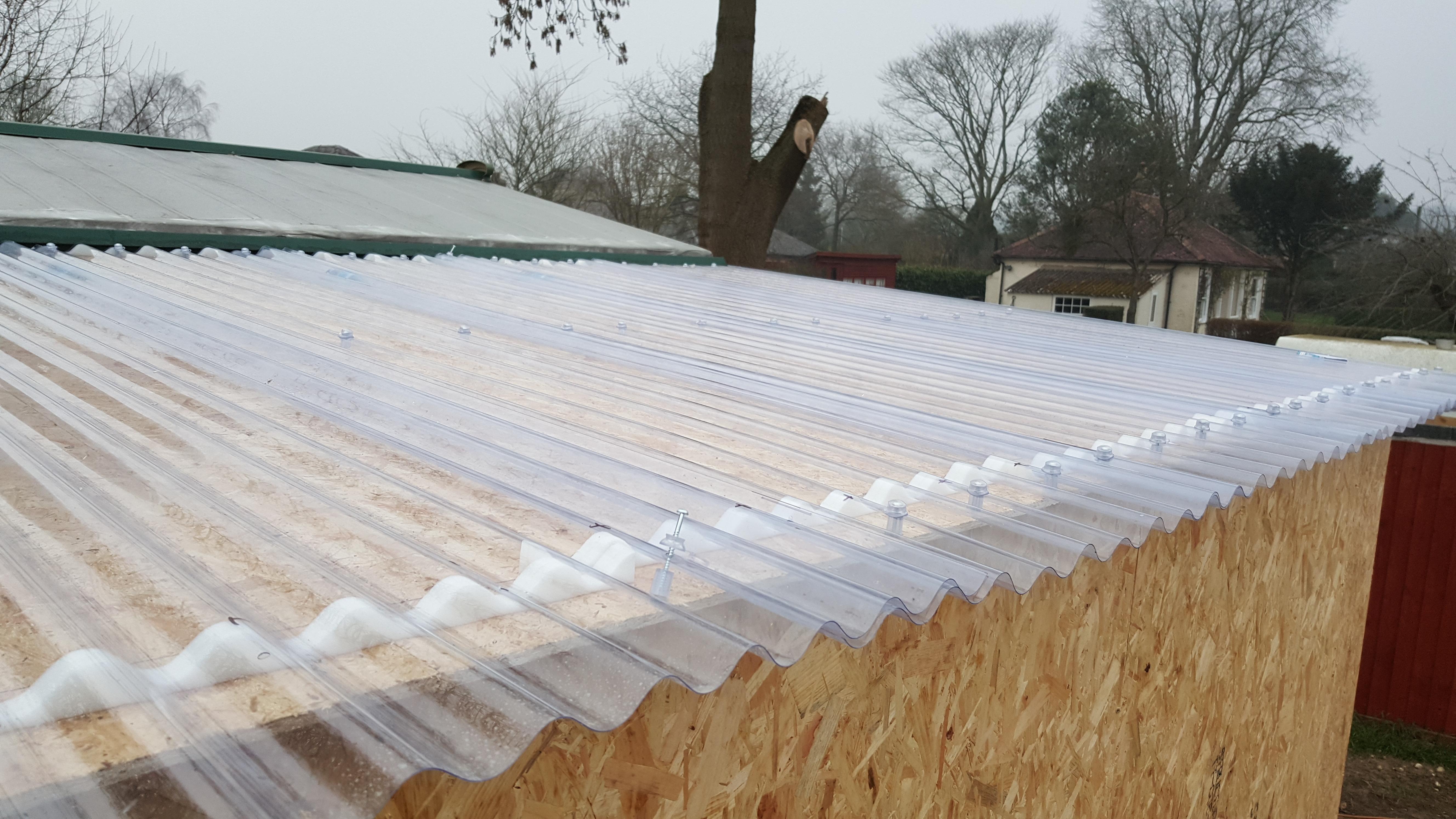

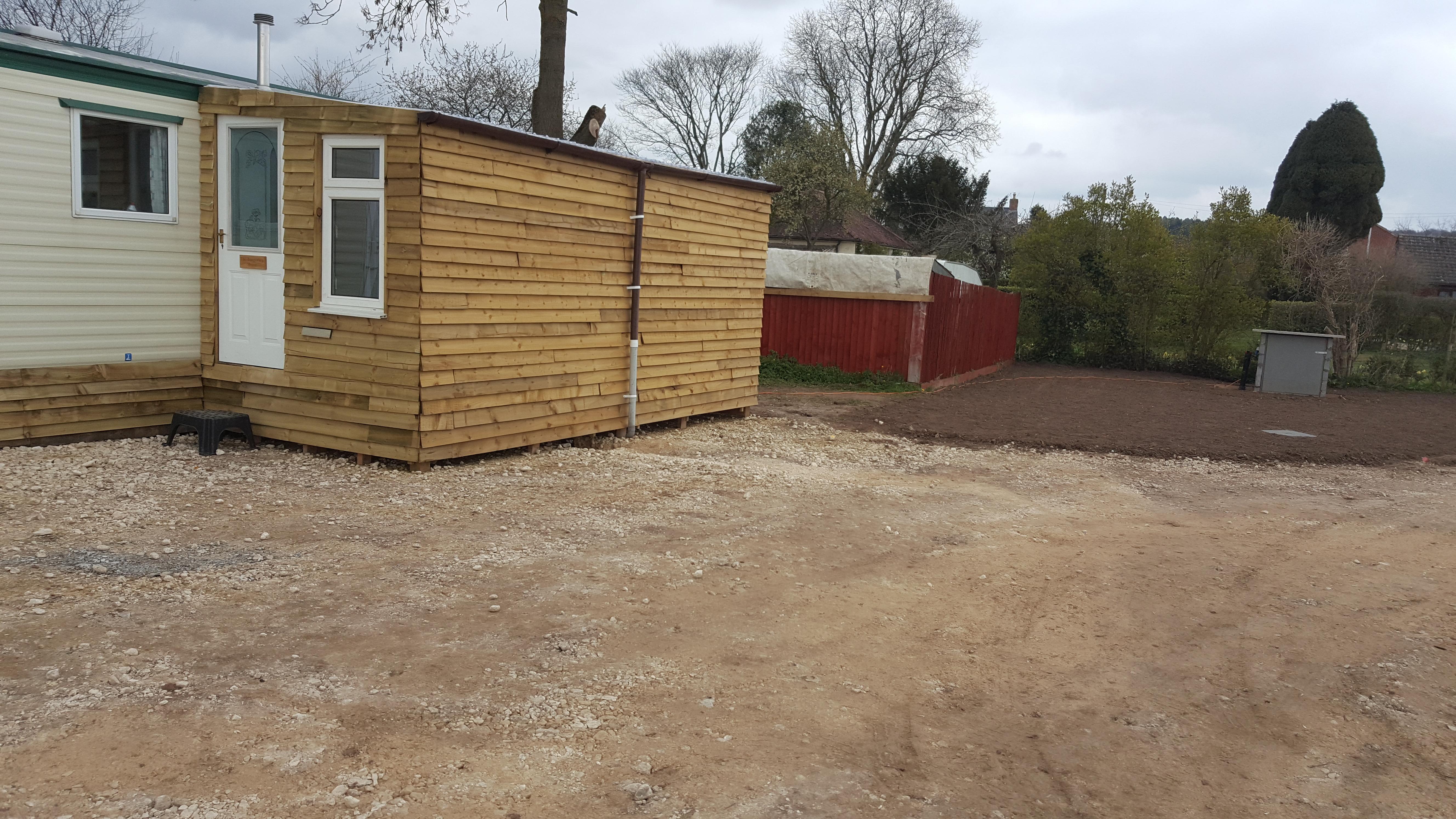

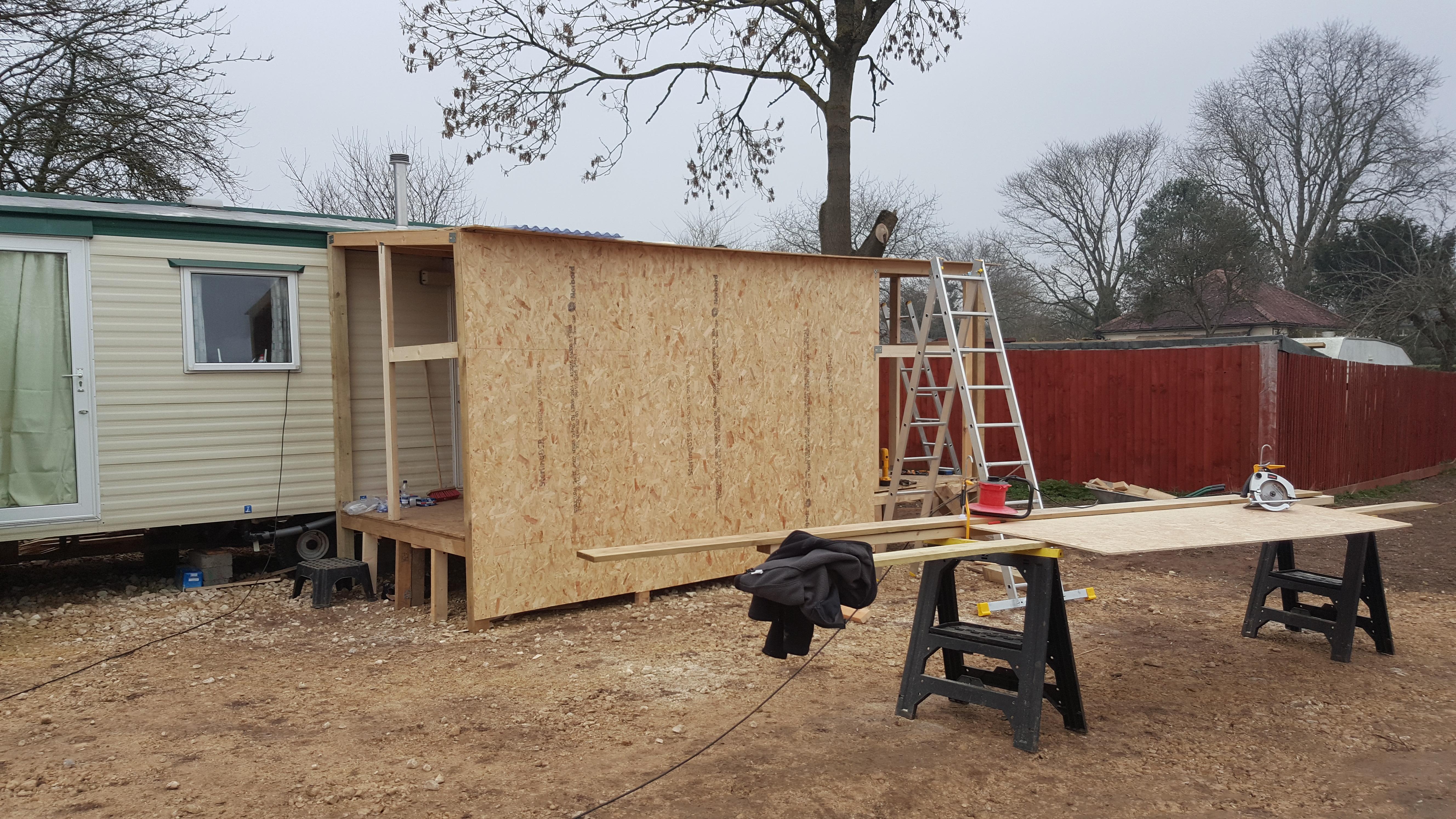

LA3222 Posted June 21, 2022 Share Posted June 21, 2022 (edited) I'm no joiner, I just screwed a lot of wood together as a frame, first layer was pallet boards for the floor followed by OSB and then lino. Walls was more OSB, counter battened and then clad with some cheap fencing. Roof was OSB with some plastic corrugated stuff. Got a free window and door - voila! Also got the spark to put a light and some sockets in there. I had the tall fridge/freezer in there as well as the washing machine & tumble dryer. Was a game changer in making van life tolerable. Edited June 21, 2022 by LA3222 1 Link to comment Share on other sites More sharing options...

SuperJohnG Posted June 21, 2022 Author Share Posted June 21, 2022 2 hours ago, ProDave said: Get the van up on blocks off it's wheels and off the silly little wind up legs that are not man enough for permenant use. It's up in the caravan axle stands that came with it. The wind up legs were completely done when I got it. I've got 8 stands but going to up it to 12 or maybe 16 then tie it down. @LA3222 brilliant pics. Exactly what i was looking for. Looks really good. Link to comment Share on other sites More sharing options...
