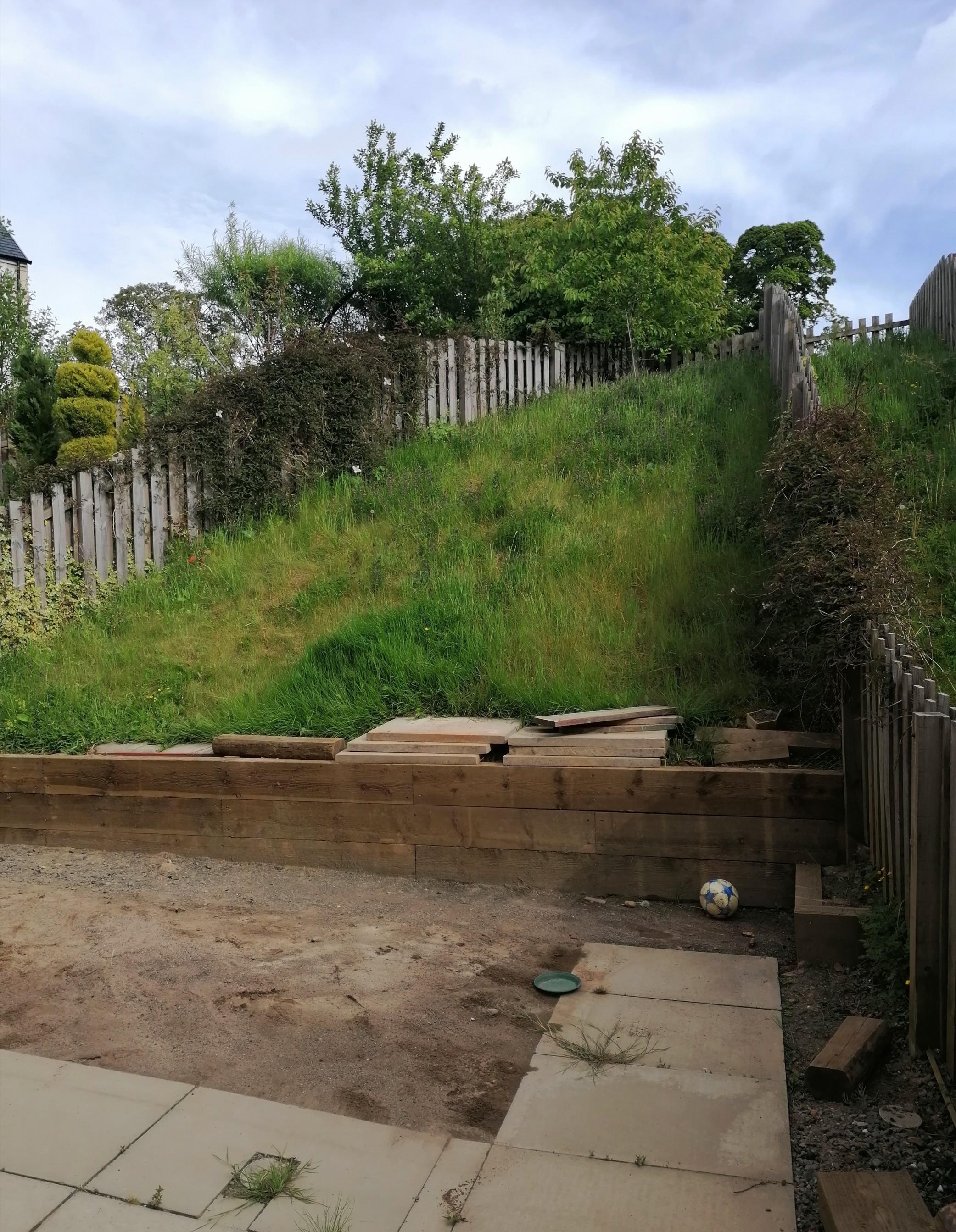

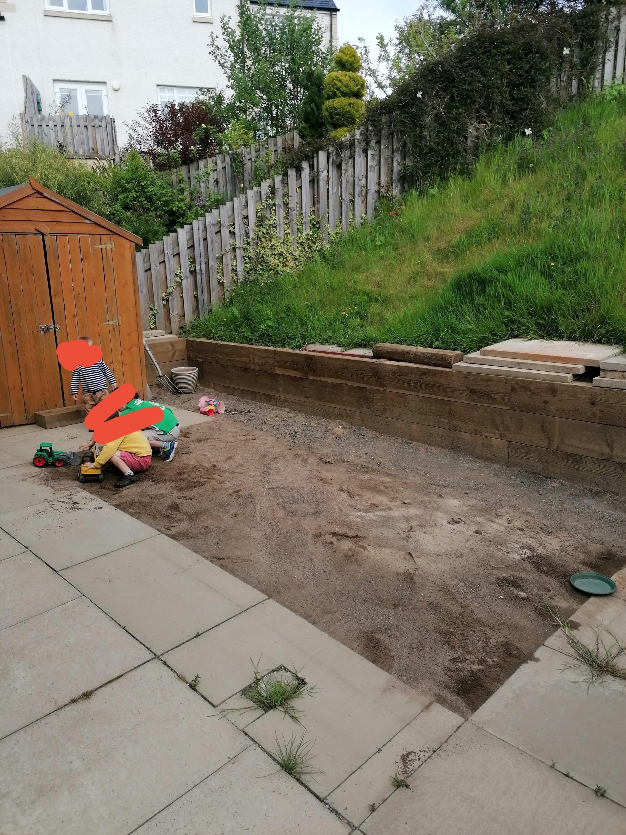

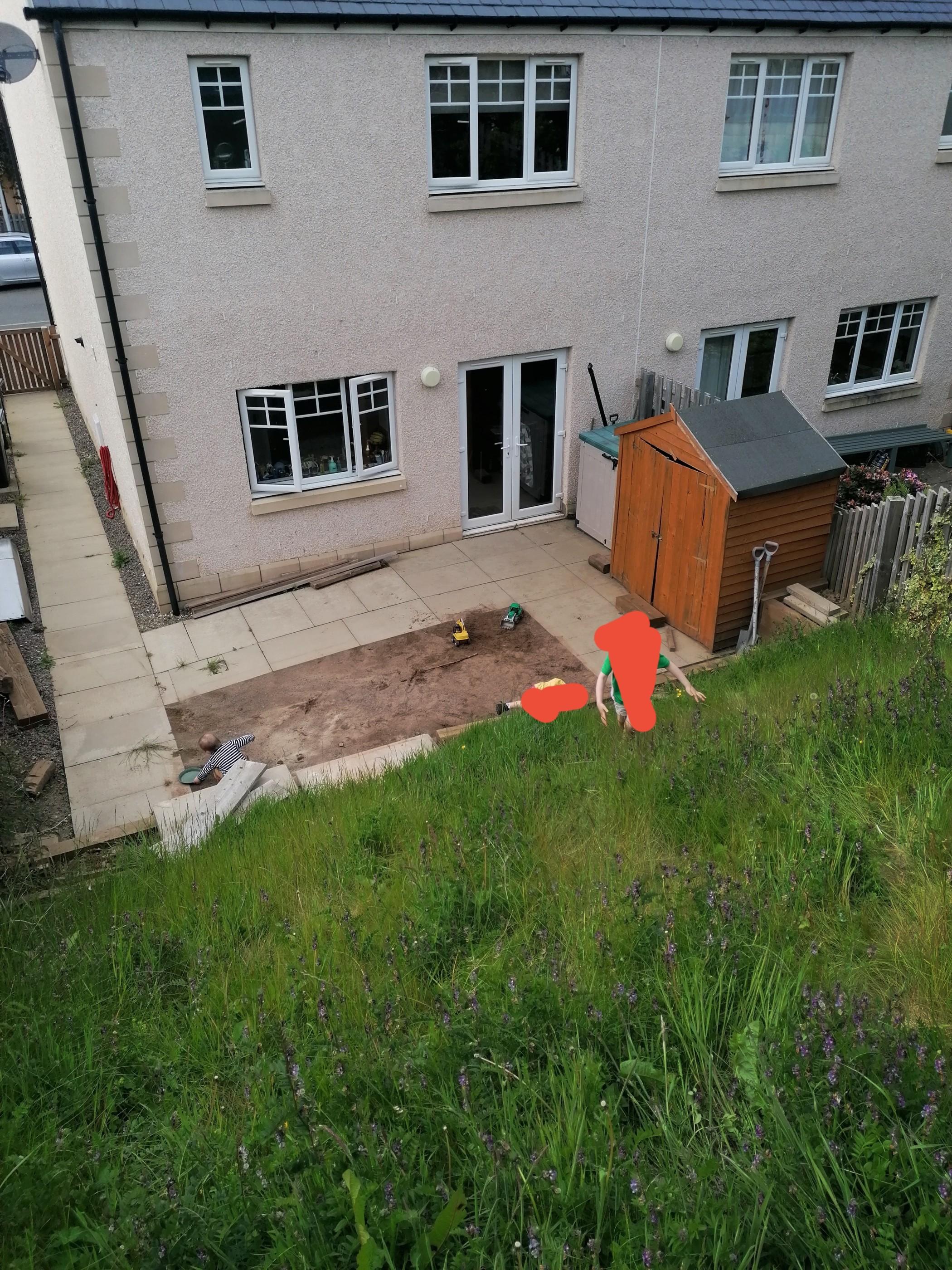

Tjg2345 Posted June 12, 2022 Share Posted June 12, 2022 I'd appreciate any suggestions for this embankment at the back of our house. We are looking to move but with the current housing market we are struggling to buy anything bigger. I have 3young kids. I'd like to keep costs down. Ideally a safe space the children could play in. Neighbours with similar gardens have terraced it but I think this would be unsafe for my kids. I'm not keen on the idea of plastic grass either. Any suggestions greatly appreciated! Link to comment Share on other sites More sharing options...
Muddy Posted June 12, 2022 Share Posted June 12, 2022 I would strim a zigzag path through the 'meadow' up to the top, where I would cut a 'picnic patch'. Leave the rest of the meadow to grow. If the kids and adults like to use it like that you could cut the paths into the slope and reinforce the edges with timber for next year. How keen a gardener are you? Link to comment Share on other sites More sharing options...
Conor Posted June 13, 2022 Share Posted June 13, 2022 I'd do similar. Nice pea gravel zig zag path allt eh way up. This then breaks up your bank in to multiple zones than you can plant properly. As it would be difficult to maintain, I'd prefer just to plant small trees and shrubs most of the way up. The other (drastic) option is to excavate out a much bigger flat area at the bottom and build a retaining wall and completely forget about the higher area. That would be a big chunk of money and a lot of disruption. Link to comment Share on other sites More sharing options...
PeterW Posted June 13, 2022 Share Posted June 13, 2022 Like the above but I am going to have to suggest a slide for the kids …. Just build a decent landing zone ..!!! 2 Link to comment Share on other sites More sharing options...
Muddy Posted June 13, 2022 Share Posted June 13, 2022 There's consensus here, work with the slope. I like the slide idea. My 2.5yr grandson has just dug up his first potatoes, and he's so excited. I would make the zigzag path permanent with cordons of apple and pear trees and thornless loganberries, maybe a plum tree at the top. Growing your own food grounds your kid's future skills. Link to comment Share on other sites More sharing options...
Conor Posted June 13, 2022 Share Posted June 13, 2022 Oh, don't forget the zip line. 1 Link to comment Share on other sites More sharing options...
SteamyTea Posted June 13, 2022 Share Posted June 13, 2022 (edited) 1 hour ago, Conor said: Oh, don't forget the zip line. Ski lift, it may snow oneday. Edited June 13, 2022 by SteamyTea Link to comment Share on other sites More sharing options...
Radian Posted June 13, 2022 Share Posted June 13, 2022 Build a garden room at the bottom, put in stairs and exit onto a flat roof garden (with railings) that extends all the way up the rest of the slope. 1 Link to comment Share on other sites More sharing options...
joe90 Posted June 13, 2022 Share Posted June 13, 2022 12 hours ago, PeterW said: Just build a decent landing zone Sand pit? 1 Link to comment Share on other sites More sharing options...
