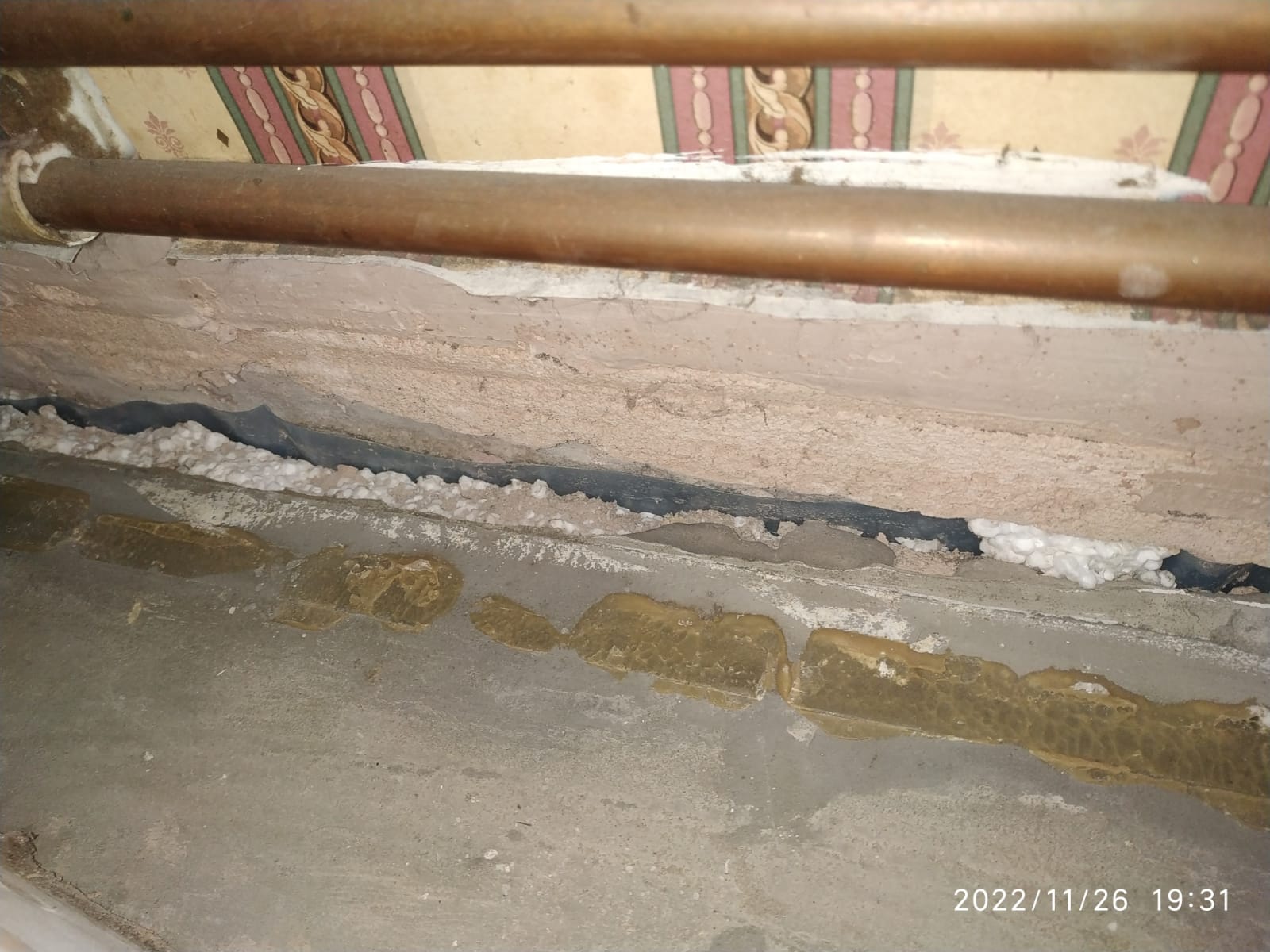

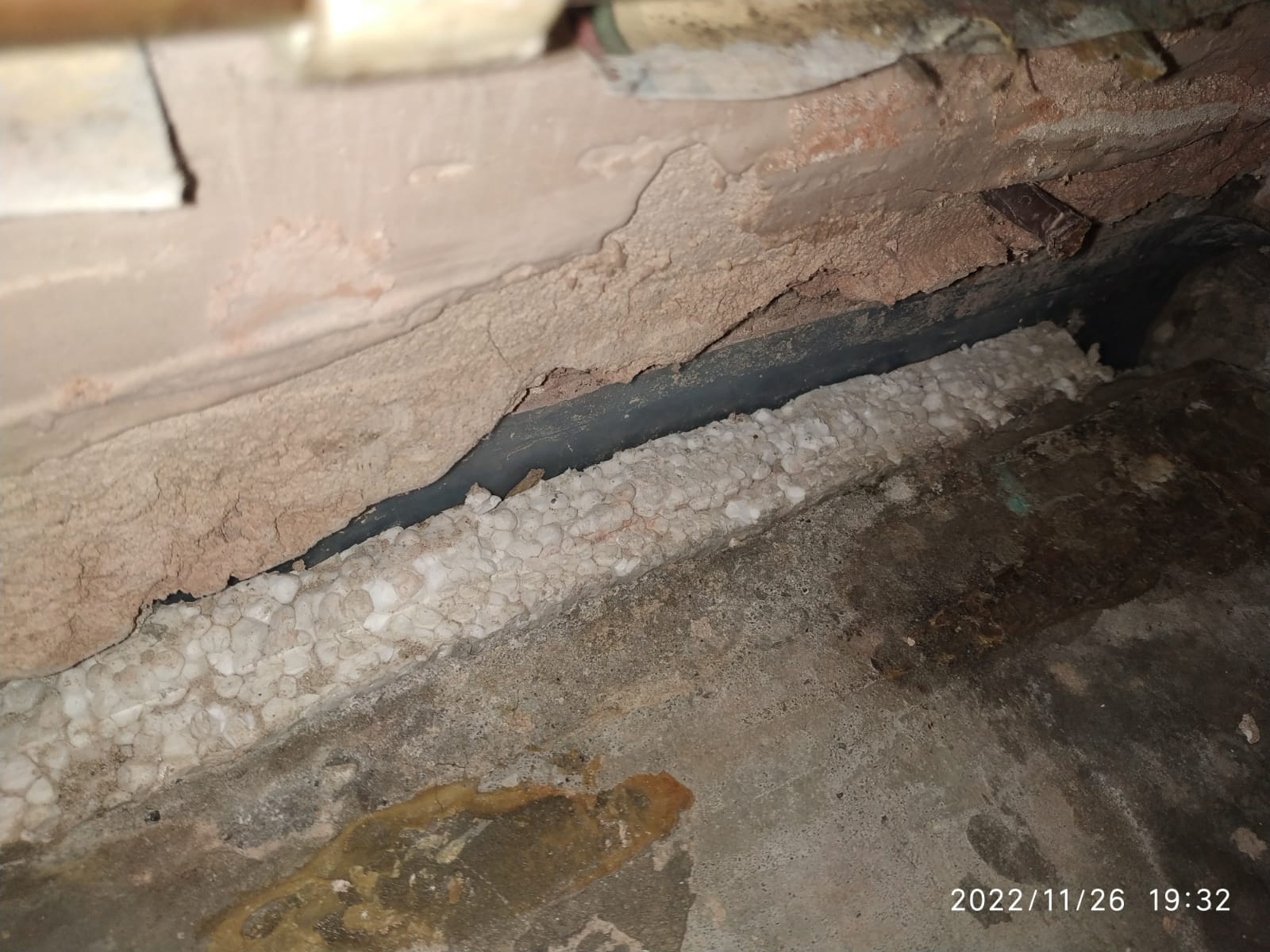

I just removed the skirting boards.
Does it look like DPM to you?
Do you think if I put another DPN on top is this going to be detrimental to what's below?

Morning, looks like someone layed a dpm and insulation before the slab so all good. No need for another dpm, depending on height available you could lay something cheap foam underlay under the wood fibre, this allows a couple of mm of air space between concrete and wood fibre board.
Edited by markc

Ok, I have checked the moisture under polythene some time ago and there is no condensation so the original DPM seems to work. I also don't see any humidity fluctuations in the room in the summer or in autumn.
Most sell min 25mm Celotex but I found this 15mm one:
https://insulationgo.co.uk/15mm-xtratherm-pir-wall-insulation-rigid-foam-celotex-thermal-board-foil-faced-12mm-celotex-tb4000/
Does it mean Celotex goes first, all tight and taped in between and then the Basic Plus underlay on top? No fibre underlay just laminate on top?
Do you mean some cheap XPS foam, all taped together then 5mm wood fibre and laminate? Would you recommend anyone in particular or is it does not really matter? I have searched for some but only found a more decent selection on Amazon which I try to avoid.
I have 25-32mm space before I have to cut the doors but the problem becomes the PVC front doors in the little landing that I won't be able to cut.
Edited by JohnBishop
Hi, yes cheap xps foam underlay material, works great as a moisture barrier under wood fibre sheets.
I decided to put 25mm Celotex on the floor.
Does £187 for 11x Celotex TB4025 Insulation Board 25mm x 1200mm x 2400mm + £60 shipping sounds reasonable?
I need to cover about 28sqm.
Do I still need to put this QuickStep underlayment?
https://www.quick-step.co.uk/en-gb/accessories/qsudlbp15_basic-plus-15-m2#Documents
By the way should Celotex go against the wall (no gap) or can it go next to the skirting?
I checked on another thread and it looks like in my case Celotex is not a good idea.
Someone said that 30mm Celotex is the minimum so together with a required plywood, fibreboard and laminate would end up to 83mm.
I don't have enough space under the front door so I cannot put it in there. This would require too many modifications.
I think I just use QuickStep or Multifoil and put laminate on top.
