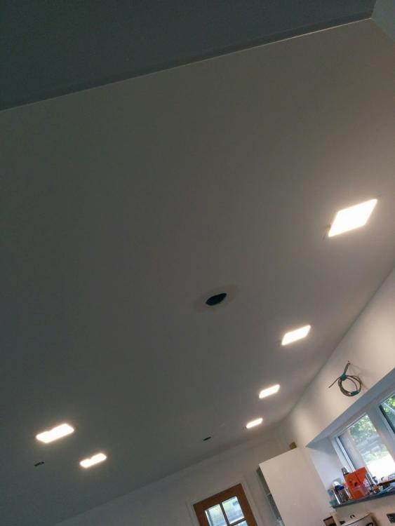

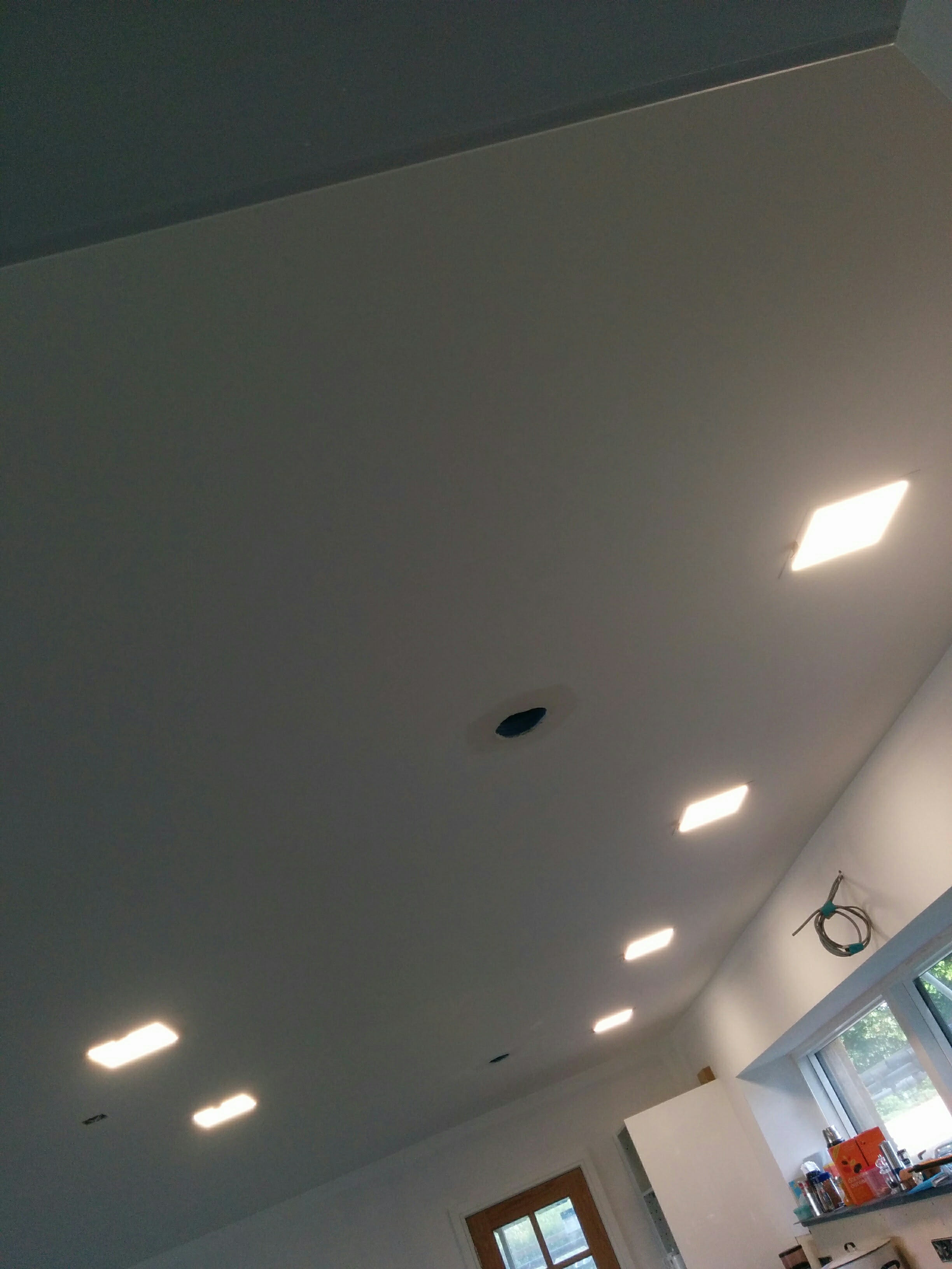

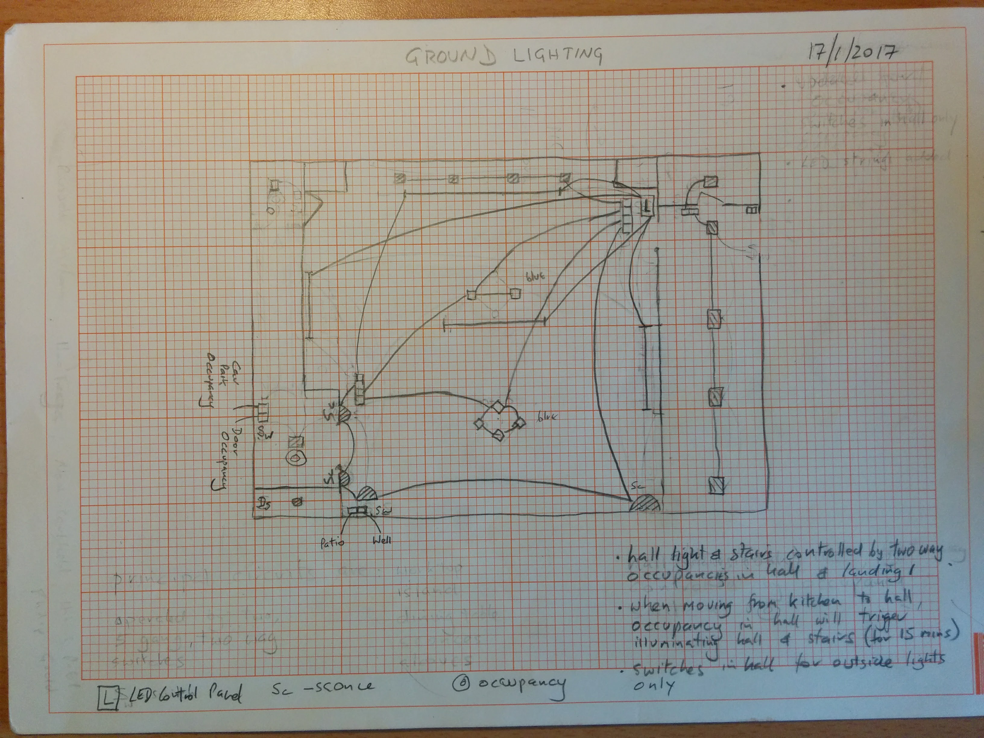

Fallingditch Posted May 22, 2017 Posted May 22, 2017 "Anyone know of good online reading about LEDs in house builds? " A few comments Try searching the site for "24V" - there's quite a lot of stuff under that heading. When you say LED's, I assume you mean strips. Or you might mean panels. LED square or round panels are IMO an excellent alternative to compact fluorescent to provide general background lighting. In fact, we have done the whole house in LED panels (as have others). Very few negative comments. For rooms of size say 3m x 4m, I have found 2 x 18w panels provide ideal illumination. Here is a picture of the kitchen diner with an array of 4 + 2 panels over the worktop: You can also get LED sconces, btw. (NB all from ebay - I cannot provide assurance as to the interference or longevity but at £9 each I will take that risk). We are also planning to fit strips to the plinths etc. One more thing - I do think lighting plans are worth doing. Makes you think it all through - especially switch positions and how it will work in practice. Here's my amateur effort for that big kitchen/diner. The row of four is at the top of the plan. Two-way switches at each end of the room allow the array to be switched on/off independently: It worked for the electrician I originally thought about putting is a 24V circuit to drive all panels and strips - but in the end I couldn't justify the expense. So all the individual panels come with their own transformers (which may come back and bite me) but the 4 strips are run from 2 x 24v transformers.
