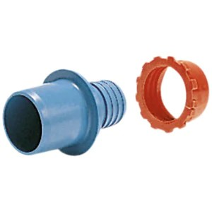

If its old 3/4 pipe the bore might be small. You can get an adapter kit to suit the old pipe bore, this puts the seal inside the old pipe and allows a standard 25mm straight coupling to join the two. You do need to get the right kit though as the old pipes had different  bores. Searcy for 'plasson adapter'

Super many thanks,  Buildhub to the rescue once again 👍
So a 22 to 25 tap with a 3/4 olive, just need to locate an insert for the old 3/4 pipe. Or a Plasson adapter, but I think I'd like to do this with as little connections as possible I think.

Used a selection of Plassons finest, to transition from old 3/4" to 25mm, supply to the build and a supply to the stables.  I probably laid the ducts too close together not leaving much room to get the 2nd stop tap.  The idea was to have the two stops close together for logistical purposes...  Now because I have connections here, I think some form of chamber where this can all be accessed would be best, rather than a couple of the skinny stop tap chambers.  Any advice?
