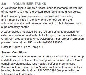

blankton Posted May 12, 2022 Posted May 12, 2022 Hi, this might be a basic question, but I am trying to spec out an ASHP system. My Brother has picked up a couple of grant inverter units, 6kw and 11kw. I need to do the heat loss calculations, but one of these should be suitable. I am reading through the installation instructions. The system layout shows a volumiser tank. There is a confusing (to me) statement that says you need one if your system doesn't meet the requirements, it then effectively goes on to state that all systems will need a volumiser tank of some kind, but without stating what "the requirements" are. My understanding is that they want a minimum amount of water in the circuit to prevent cycling on and off, so I was expecting to see what this volume was. Can anyone explain this better? As well as the cost of an extra item of equipment, its also the space to squeeze it in to such a small cottage!
JohnMo Posted May 12, 2022 Posted May 12, 2022 There is a heat loss calculator in the boffins corner on this forum. Volumiser and buffer are the same thing. Here is how you work out if you need one. You need to calculate your system volume for a start, also you need to know the turn down of the heat pump. Example 12kW nominal inverter controlled heat pump unit (at 7oC ambient and 35oC water flow) can provide an output of 4kW at maximum turndown (minimum output) at an ambient of 12oC and weather compensated flow temperature of 30oC. What is the minimum water content to ensure cycling does not exceed six starts per hour? Assume acceptable temperature drop of fluid is 5oC and the fluid has a SHC of 4 [kJ/oC kg] because it has antifreeze in it (normally 4.18[kJ/oC kg]) Total heat energy required: 4 [kW = kJ/s x 60/6] [minutes/number]x 60 [secs/min] = 2,400 [kJ] Mass of water required [kg] = 2400 [kJ]/(4 [kJ/oC kg] x 5 [oC] = 120 [kg] Assume 1 kg of water = 1 litre, therefore 120 litres required. Now compare to the capacity of your system, if system is bigger no buffer required, if smaller buffer required, size required is the difference between the two volumes
blankton Posted May 12, 2022 Author Posted May 12, 2022 Thanks for that. I assume the capacity of the system would only take into account the pipework to and from the manifold, as at any time any of the circuits off the manifold might be shut off?
SteamyTea Posted May 12, 2022 Posted May 12, 2022 On 12/05/2022 at 16:57, JohnMo said: Now compare to the capacity of your system Expand It is the smallest independent circuit in the system, not the compete system.
JohnMo Posted May 12, 2022 Posted May 12, 2022 That's where you need to get creative and join different circuits in to one or two zones, to keep the system capacity large enough to keep the buffer size manageable.
